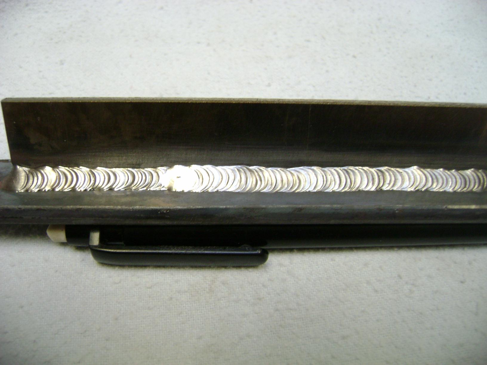

Hence my question to the forum chemists: My project has no cooking scum or fingerprints to rub off. It's just a coloration thats a little darker than the surrounding area. If the acids concoction actually 'brightens' the stainless steel in the area where I worked it, did it "passivate"? And will it remain bright like the rest of the item?

It looks like a Mig weld. What type of stainless steel filler metal did you use? Did you use a tri mix gas?

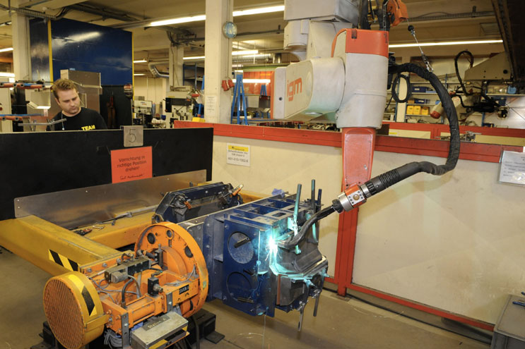

Shield here is a pic of the welder. It's a MIG of sorts, no idea what gas used, and I couldn't see the plug so I can't answer everybody's next question :D
During a period following fabrication, it seems to me that Stainless can discolor as the recently exposed surface iron molecules rust. Then once these surface molecules are gone (deplete) and the rust staining rubs off its bright again. I'm pretty sure "passivation" mostly just accelerates this process, ",,,,,better living thru acids! " :D In Marine applications - saltwater, I bet the surface iron depletes quickly.
I want to grind off this high weld in such a way that it goes entirely unnoticed. I think we're onto it, finishing with an uncontaminated flapper. But if any rust coloration appears on the surface after a few weeks it may upset some customers, who will think their part has a globule of iron that's gonna rust right thru. Some will be OK if told "sorry it will be a few months, you just have to wait for the iron to deplete." Others will want a replacement. I have only one Sunday remaining to research this - gotta do something Monday AM.
