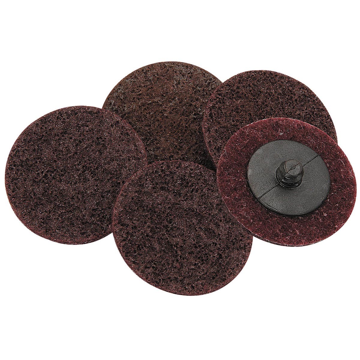

Got die grinder scotchbrite type too, forgot I had them. Diegrinder & pads at HF cost about the same as pads alone at McMaster. Not really, but I got an HF air grinder for $9.99 and pads for $4.99 for an earlier project.
Here's the discs
I like McM, they give you a lot of info, even the drawings with dimensions. McM is overnite to Seattle, not sure how they do it!
