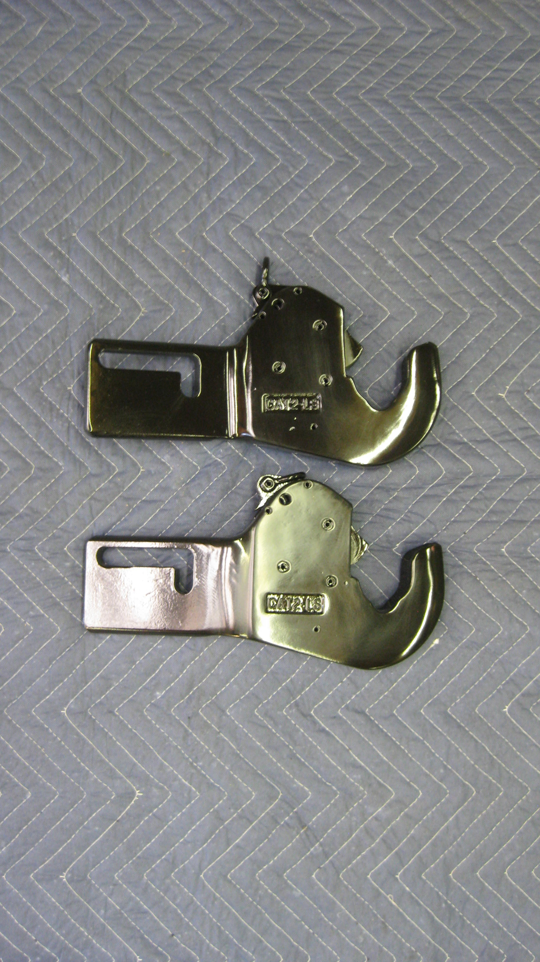

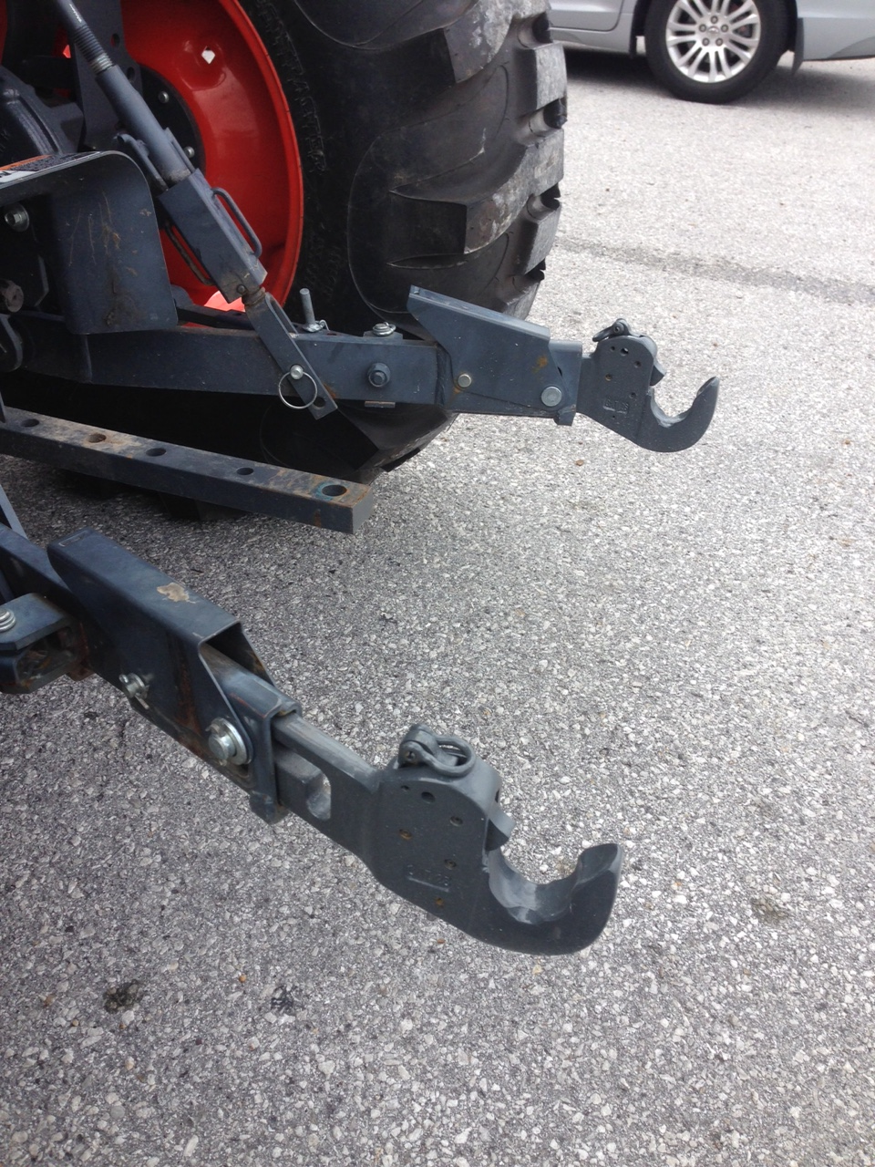

I just put Pat's system on my NH Workmaster. I find it difficult to get them even and lined up properly on the 3-pt arms. And this, in turn, makes it hard to disconnect my box blade when I want to because the Pat's won't release and just fall away from the implement pins. I love the concept of Pat's. Like somebody above me said, the top link isn't the issue on hooking up implements. The two lower links are the issue. Pat's seems perfect for solving this. And in theory Pat's will work on ANY implement unlike traditional quick hitches. But if I can't get mine to line up right and work properly soon I may send them back for a refund.
So, you need something like these.
Blue Mule's are non adjustable end links. But I agree that the European style lower links and matching top link is something that the US should have adopted years ago.

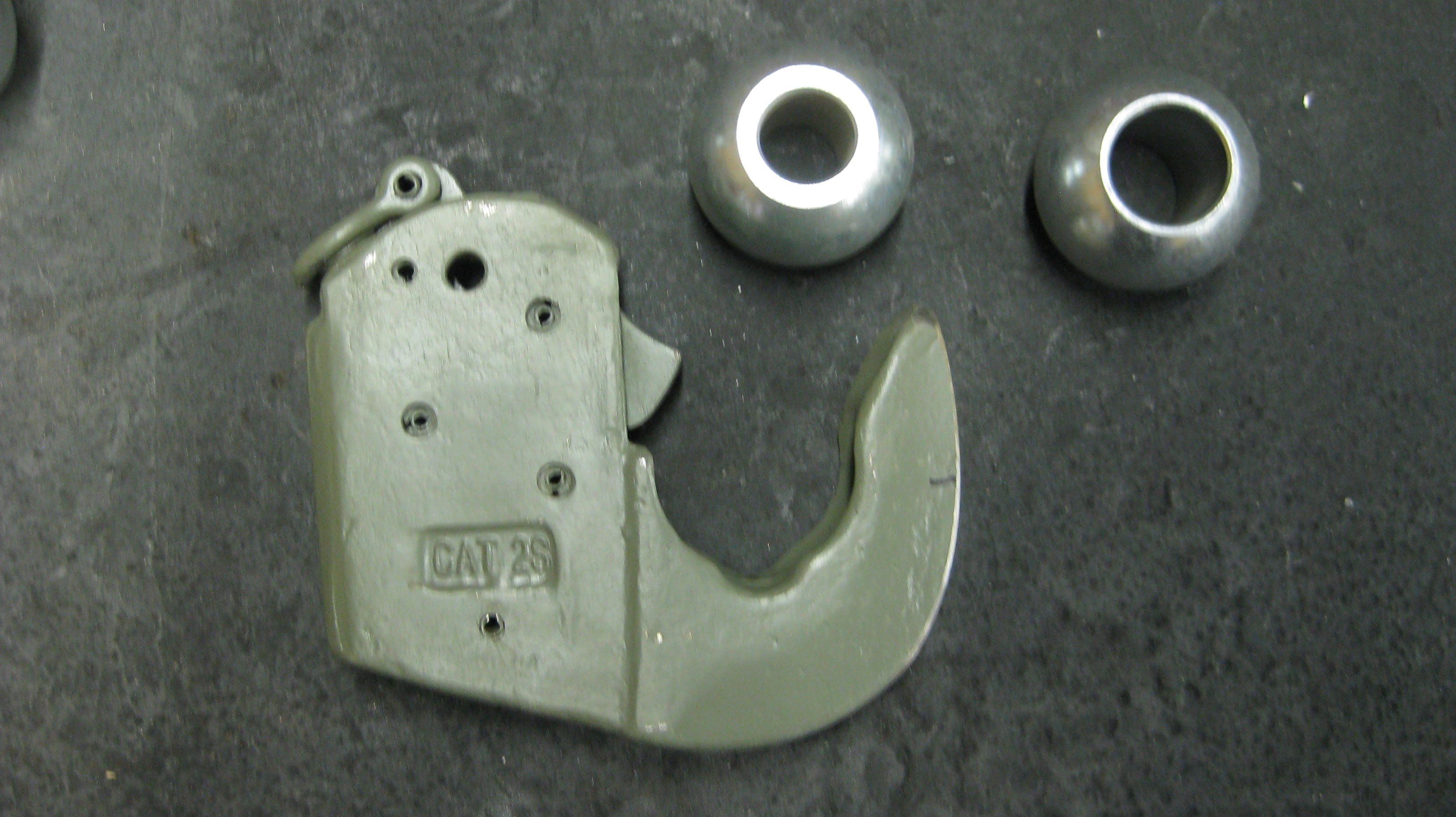

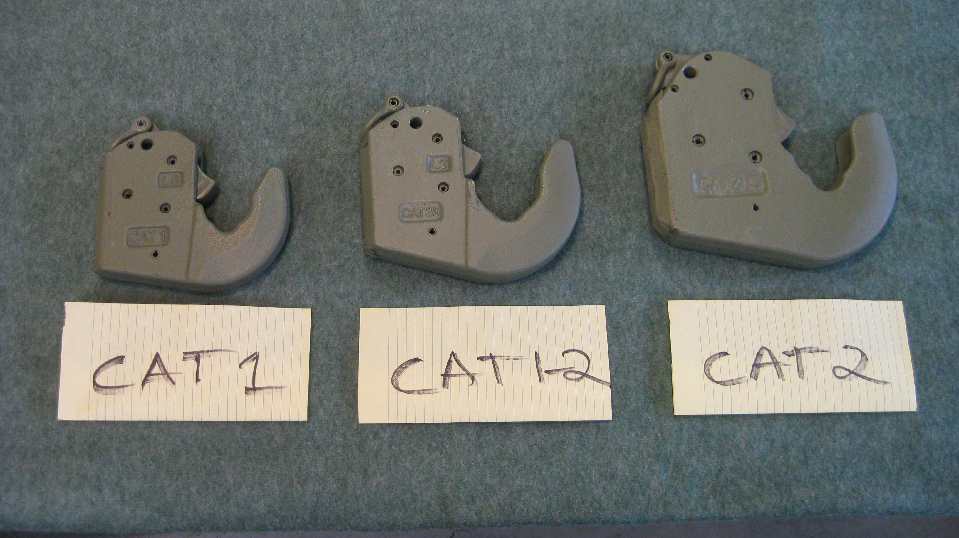

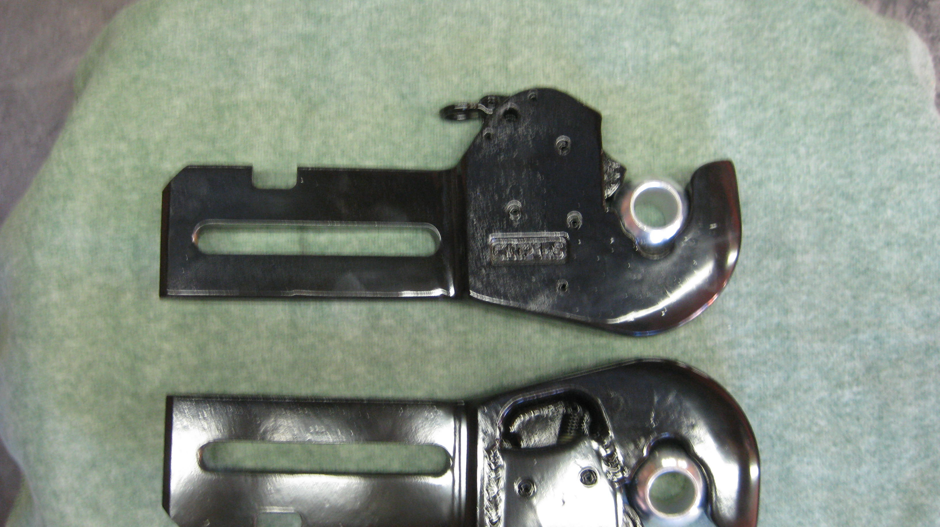

Do you have a link or a name, and is it a direct replacement for kubota extendable cat2?
Now this I'm interested in 👍
Typically a customer ships me their ends and I do the fabrication.
But the ends can be purchased as manufactured and the customer can do the fabrication themselves.

   / Past's Easy Change vs. Kubota Quick Hitch on Kubota M4 with Cat 2 #39
Oliver and Ford both offered the hooked ends many years ago as an option for some reason it didn't go over well.
Of course the balls made for those hooks have a different OD then todays which with the cat 2 are usually 56 mm in diameter.
Ah, I mistakenly thought that was Lou's post I was responding to, and the top hook pictured looks a lot like it's got the same yellowish plating or finish. Most of my attachments have a pin that's supported at both ends vs. a traditional cat 1 one side supported with a finger snapper at the other. Do you still need a ball?
