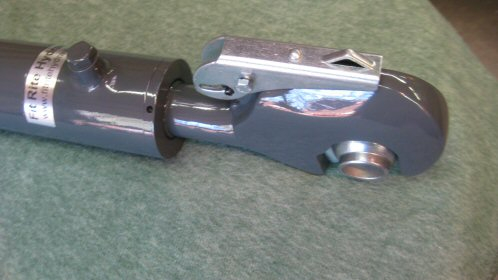

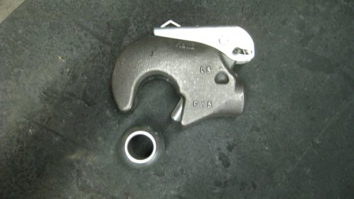

Ah, I mistakenly thought that was Lou's post I was responding to, and the top hook pictured looks a lot like it's got the same yellowish plating or finish. Most of my attachments have a pin that's supported at both ends vs. a traditional cat 1 one side supported with a finger snapper at the other. Do you still need a ball?
Yes, the balls are required for any attachment be it a cat 1,2 or 3. The ball OD for the cat 1 size hooks is much smaller than either the cat 1 or cat 2 balls which are interchangeable between the cat 1-2 & cat 2 size hooks.
Then of course the cat 3 hooks & balls are much larger yet.
I wish that they had a cat 1 size top link hook, but all they have is cat 2 & cat 3 size.
So for cat 1 applications, I have to machine the balls down to fit for width.

So to take full advantage of this, you need to buy a pair of balls for each implement.
I can do the welding, can you pm me a cost? I'm fine with it reply here if you don't mind and forum rules allow it.
M 9540
   / Past's Easy Change vs. Kubota Quick Hitch on Kubota M4 with Cat 2 #43
Yes, to take full advantage, a set of balls of each implement is the way to go. Once you're setup, you just back up to the implement and hook it up. If you are a bit crooked, you can just push the implement till it stays square with the tractor.
Without a set of balls for each implement, you'll find yourself playing with your balls constantly. :)
One thing I noticed on the hooks that came standard with my tractor is that they may have used a spring a bit too strong. For cat 1 implements, it will just lift the implement instead of pushing the latch in. I almost flipped my tiller backwards trying that. I now unlatch both hooks before trying to hook the implement.
