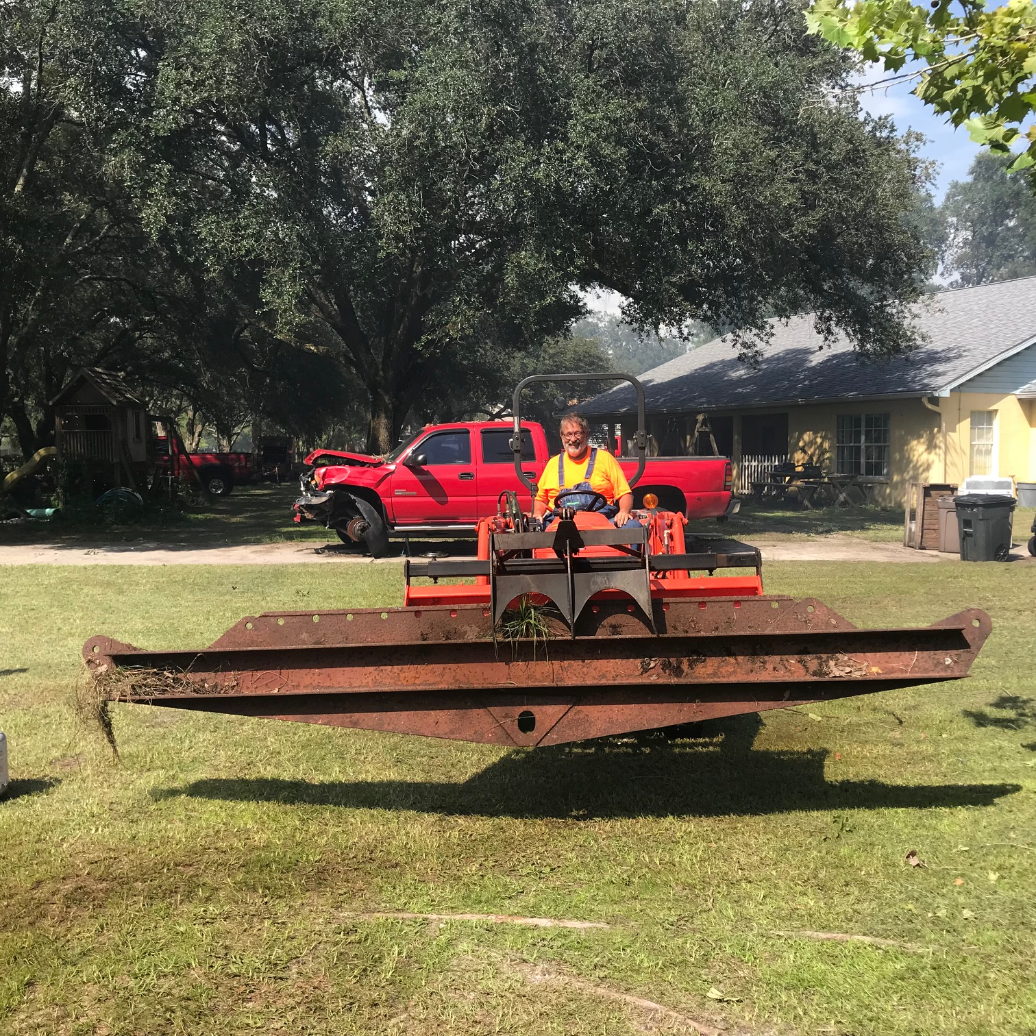

I was able to trade a couple of round bales of hay for this 12 foot spreader bar. I have plowed and then used an old heavy Rome Plow (harrow) with this spreader bar chained behind the Rome Plow. I used 2 chains in order to keep the bar parallel to the Rome Plow. I was not attempting to level the fields . I was smoothing the fields for hay production.
This process allowed me to transform a former horse ranch, with 6 or 7 paddocks with hundreds of fence posts that had been used and uncared for back, into a very nice hay field.

Ill have to find someone with a big drag I can borrow. Next spring ill plow that area again and disc + drag. A few people I have talked to around here don't show much interest when I bring up smoothing fields, I am guessing it's not worth worrying about when you're farming hundreds of acres? but for a hobby farmer like me I think its worth while to make the experience more enjoyable.
