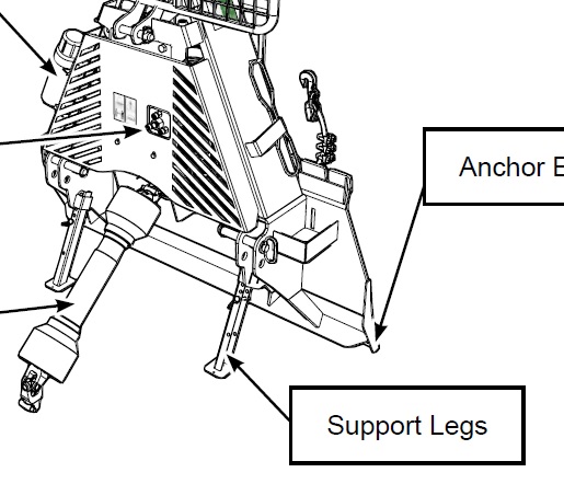

My tractor has a Cat II 3 PTH.
Some of my implements are Cat I, some Cat II?
Some of the Cat I implements have: Cat I pins (bolted on), but some of them have what I can only describe as "2 vertical plates with holes that the tractor's lift arm goes between, and you insert the (CAT I) pin through the (CAT I) holes of the implement" [like a farm wagon tongue turned 90 degrees sideways]
(See photo)
Typically I use bushings for connecting the CAT I implement to CAT II tractor.
Can I use a Pat's Easy Change (CAT II) on the Cat I implements?
Just put the bushings on the pins before you snap in?
Granted, when possible I'd change the (bolted on) pins to CAT II, but that's not possible for the other type in the picture (unless I re-drill the holes the pin goes through)

Not sure why this would be a problem. Yes, it would work to put bushings on the CAT 1 pins to make them CAT 2 diameter.
The mounts that you describe are usually called "clevis" mounts.
Below is a photo of what I did with a CAT 1 to CAT 2 bushing. The homemade orange spacer is to keep the CAT 2 bushing in place so it doesn't slide. The spacer was eventually reversed so the washer part of the spacer faced the bushing. Works just fine for a Pat's CAT 2.
Later, I cut a larger hole in the mount with a plasma cutter and welded in CAT 2 to CAT 3 bushings in the holes. Then I could slide a CAT 2 pin through the mount and have it fit perfectly. I haven't taken a picture of that modification yet.

I bought Pat's QH in Cat II size. For Cat I installations I just use a Cat I - II sleeve. Works fine.
