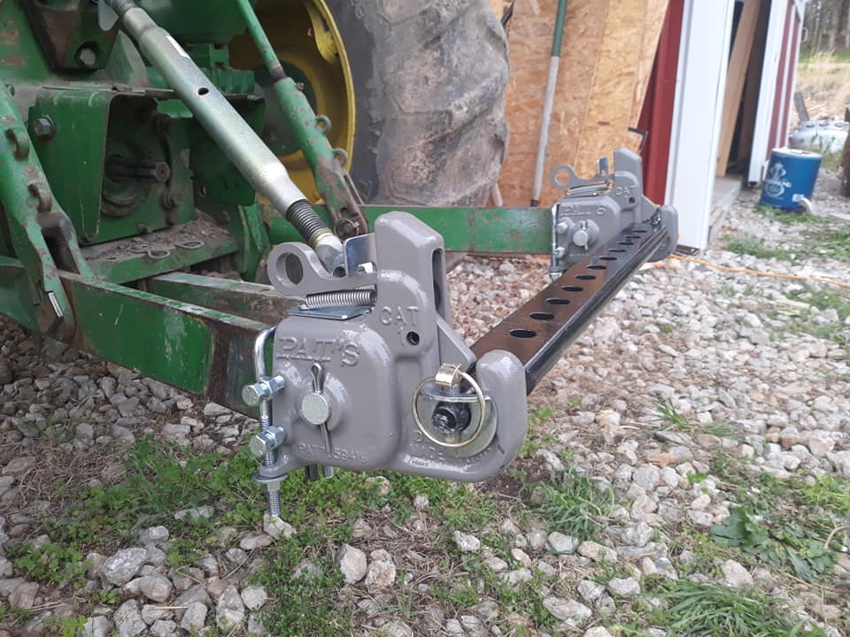

I just measure my ball width this morning, they are Cat 2, but are only 1.25 wide. Went ahead and ordered the Cat 1... fingers crossed.

After conferring with AskTractorMike, I went with the Cat 1. Got them a couple of days ago, trimmed the 1-3/4" long Cat2/1 bushings down by 3/8", and put it all together. Worked like a charm.

Suggestion: double nut the u-bolt nuts.. My first mowing, I lost 3 of the 4 despite having torqued the nuts. Lots of vibration back there. I double nutted using a jam nut. No troubles since. Love the PATS...

When I bought mine years ago it came with double nuts for the U-bolts.
Yes it came with double nuts, but I opted to bypass the for nylon locknuts as was recommended by several folks. I just hadn't put them on yet in the picture.
