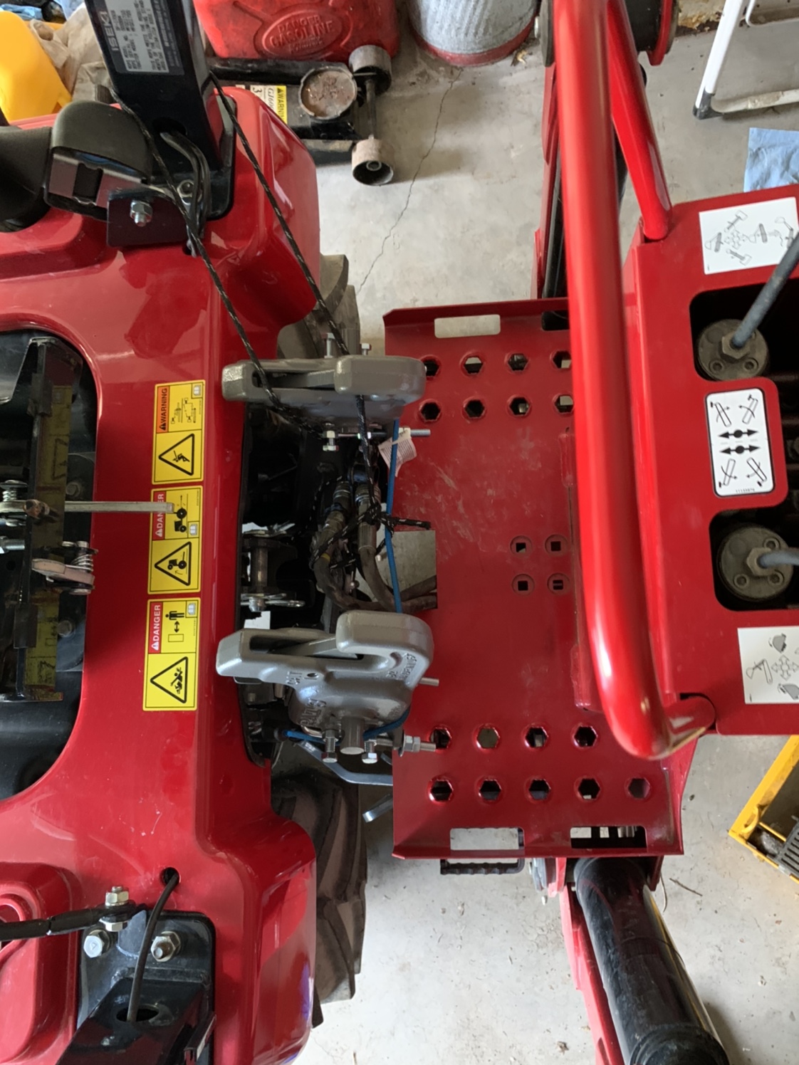

I am considering Pat's easy change. Anyone using it on a GC1700 (GC1720 with CB65 to be exact)? I want a easy system, but I am worried about clearance when the backhoe is on. Having to uninstall it would defeat the purpose since it seems like an involved process (shims, u-bolts) installing it. What are your thoughts? Do you recommend something else for me? As always, I appreciate your input. Thanks in advance!
   / Pat's easy change on GC1720 TLB #2
I have not used the 3PT, but it looks pretty tight back there to add anything.
   / Pat's easy change on GC1720 TLB #3
With the CB65, I would think it would fit fine. A lot more room (between the tractor and backhoe) on that model then the previous CB05.
   / Pat's easy change on GC1720 TLB #4
Looked at my GC1720 as well.
Looks like this would fit with ample clearance. Although it might hit your legs when operating the hoe.

Yeah, I think I might get it. I wish it was easy to uninstall.

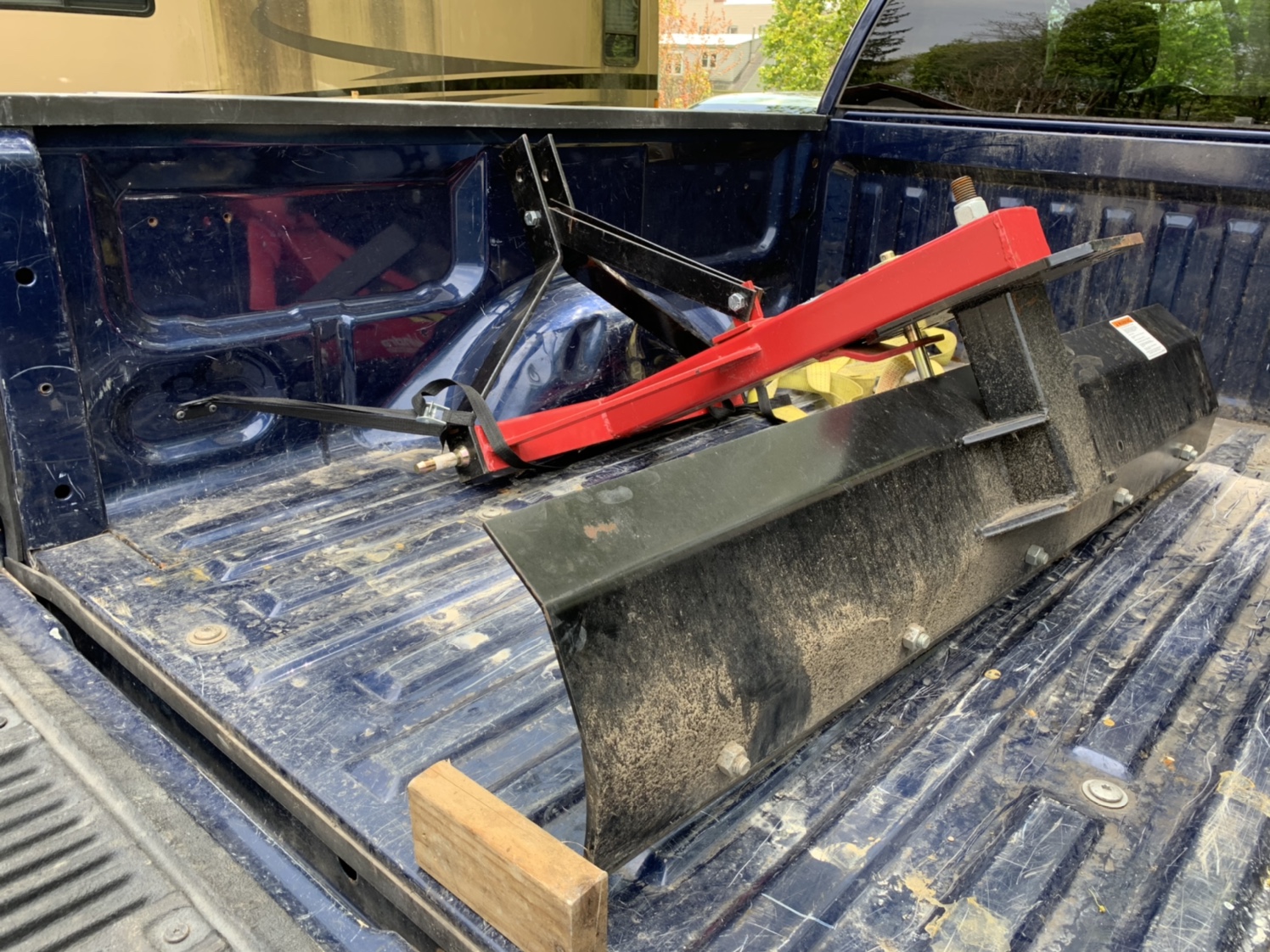

Once I have it, I will take pictures. Looking forward to making this easier. Fighting to get the rear blade on and off is no fun at all. IMG_3250.JPGIMG_3253.JPG

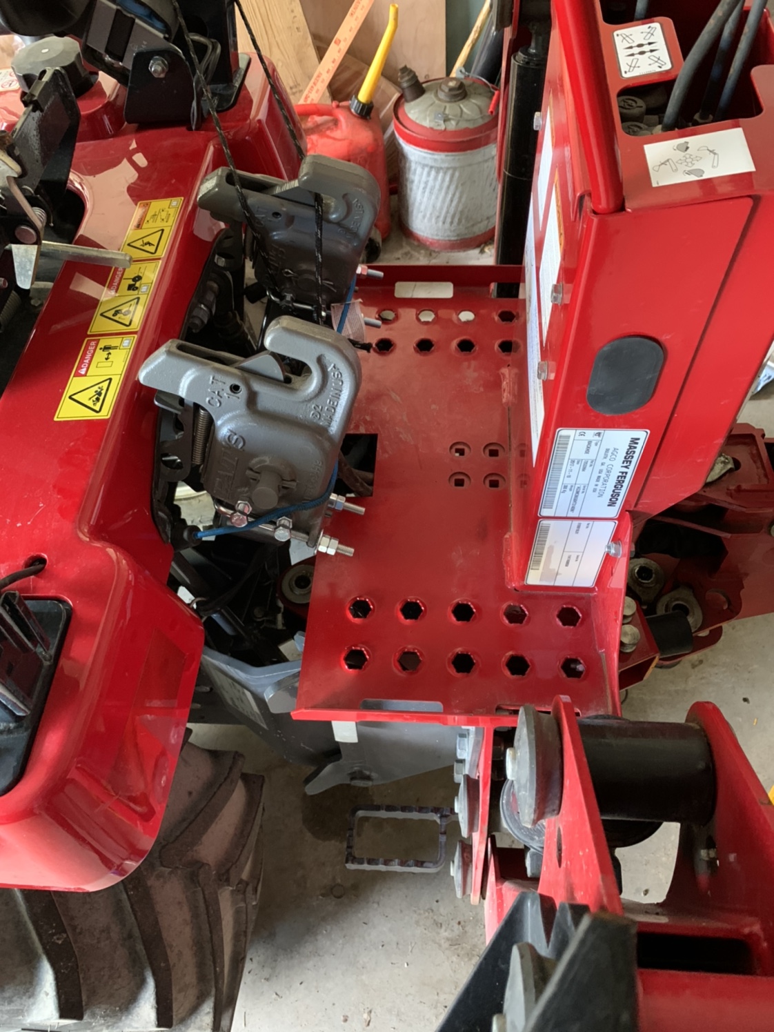

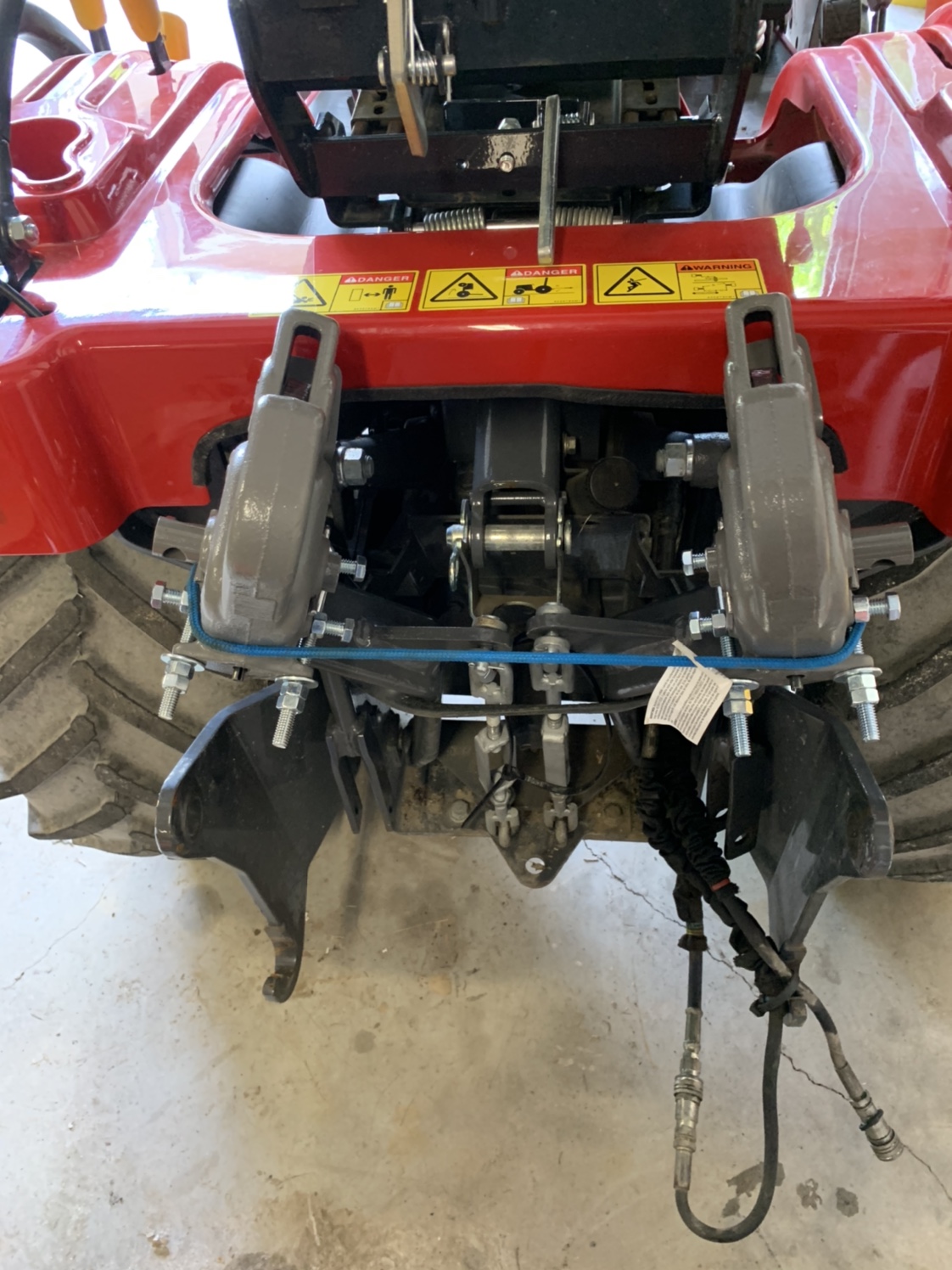

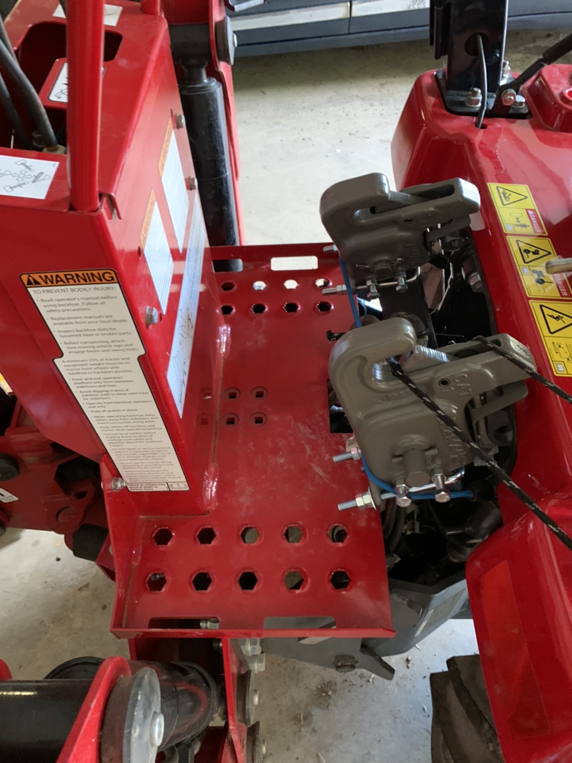

I think I will manage placing my feet out of the way. Haven’t tried using the backhoe yet but will get a chance today. The pats look like it will be a lot easier for rear hitch.

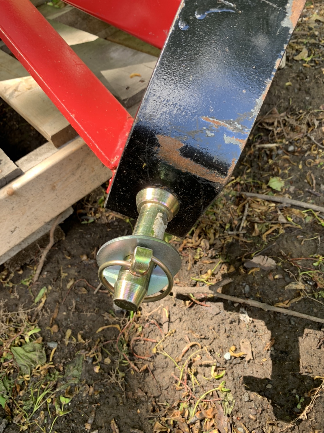

The hitch only requires a collar to be added to the implement.
