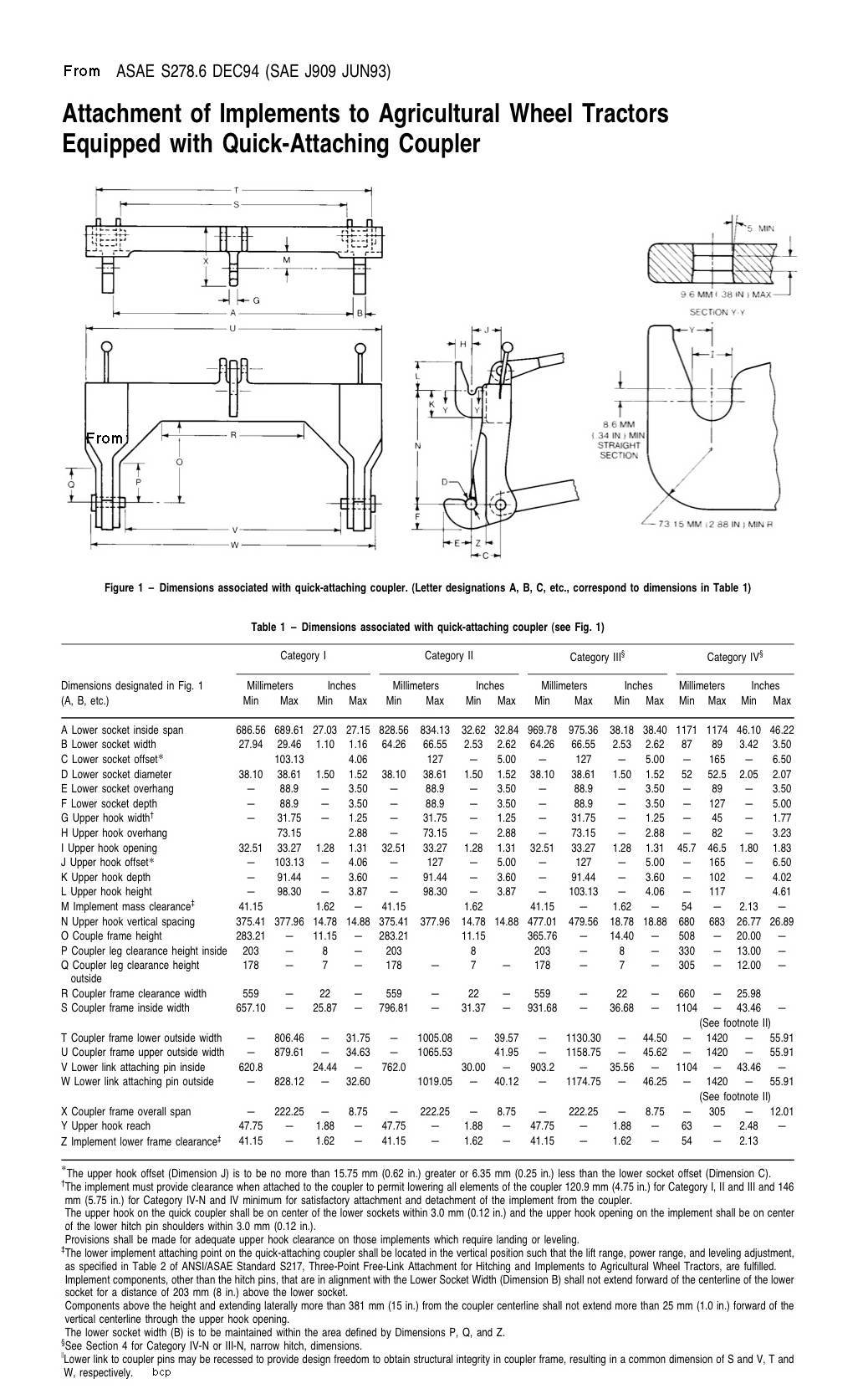

... THE CAT 1 & CAT 2 ATTACHMENTS HAVE NO COMMON MEASUREMENTS....
I didn't see common #s on TractorData's info page.
Not sure of QH-compatibility specs, but most all of my seven tools (sorry I lied earlier & said 'six')
are not to ASAE spec for Cat 1 & wouldn't cut 'QH' without mods. Three that are closest to fitting have PTO shafts. :confused3:

ASAE quick hitch coupler standards
ASAE quick hitch implement standards

Not to further any debate, I'd bought my QH after having already picked up the back blade, subsoiler, etc and they weren't to ASAE spec, meaning no clearance for the top hook. Then I sized up my other, heavier stuff (box blade, brush hog, tiller).
There would be some tweaking to uniform the spacing shown as 'N' in the first chart above and 'F1' in the second, esp on the BH with its bent & twisted struts. Buying a few bits by price had cost me the convenience of using QH, so that's just me getting in late & now not wanting to replace things I use the least to get the better setup.
Anyone just starting out, building their fleet of attachments, might want to be sure their stuff was QH compatible from the git. It could make PEC less of the 'band-aid' I sought to er' 'bail my bacon'. :duh: btw: I'll still have to by extension(s) for PTO shaft(s) to use either 'quickie'... :eek:
