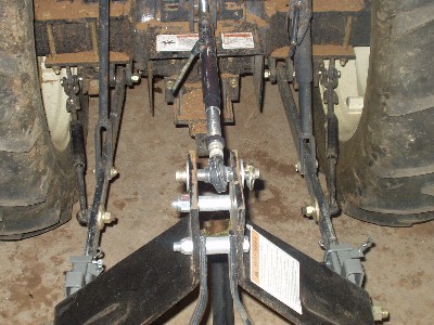

Here are the pictures. This is the side view showing where the contact is.

Here is a top view showing the linkage. Notice how the lift arms have plenty of clearance but the sway bars are barely missing the tires.

The pictures don't show it well but right now there is about 1-1.5" clearance between the tires and the turnbuckles on the sway bars on each side. The box blade is slighty wider and the problem is worse. There is about 3/4" clearance when all connected up. If I tighten up the sway bars the implement stays in place and I have never had any rubbing issues but I don't think it would work with the pins facing out as it would be too wide.
   / Pats easy change problems
#18
Also looking at the first picture one might say just make the top link longer and it won't hit, but this won't work. The rear wheel on the shredder is already hitting the ground.

Let's cut to the chase here. CAT I 3-point lower link arms should be 26-1/2" apart.How far apart are they in that photo? I'd say that the problem stems from the tire/wheels being set narrow.
   / Pats easy change problems #20
I ran into a very similar problem on my father in laws NH 30 hp tractor.
His main problem were the 3PH lift arms were installed backwards, we also swapped the rear wheels from side to side to get a wider track and more clearance for the lift arms.
If it were me, I would set the rear tires for enough of a wider track to get sufficent clearance to put the pins facing out on the implements. Once you do that, the quick hitch has a much better chance of working correctly.
You also get a wider stance in case you have any slopes to work on.
I set the rear wheels on my Kubota to the widest position, I even think it improved the ride, but that may be wishful thinking, haha.
I also would set the pins on the implements to point out, that is how they are designed to work, I would be concerned using normal sized implements like you have with the pins facing in, the narrower width on the lift arms would seem to me to make them more unstable side to side...but maybe thats just my imagination again.
