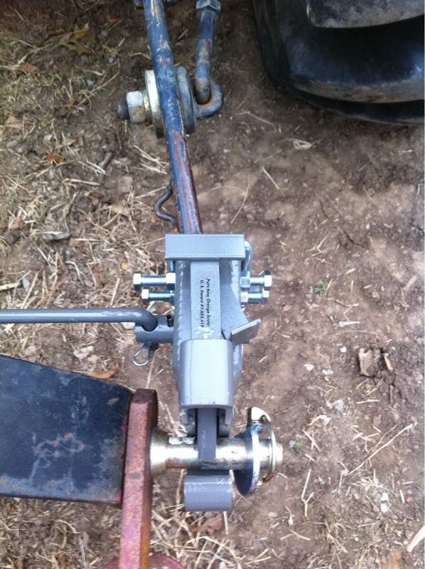

/ Pat's Easy Hitch System
I received the hitch system and got them installed yesterday. As the picture shows I tilted them so that they are closer to perpendicular to the implement connection... does this look correct or should they be inline with the lifting bar?
Another issue I see is now the upper top link is 29" when in a neutral position. I want to get a hydraulic top link. I see that they will only go to 28". Any suggestions?
/ Pat's Easy Hitch System #7
The installation of the PEC looks fine. It's pretty simple and intuitive (after all, I could do it...)
Can't help you with the top link question...sorry.
