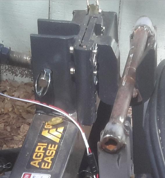

Only negative on quick hitch is you have to modify implement(s) once to fit "standard" of QH..... After that no fumbling or spreader bars or what ever...
Not sure on HF QH though, seems a lot of people have problems with top hook bolts interference ....
I went different way than HF.....
Its a BE Agri-Ease cat-1 ...

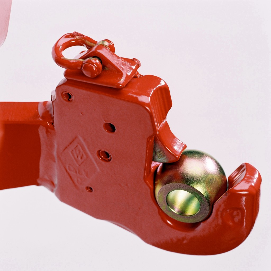

We use this style in Europe. It sure is a time saver. The balls allows for more motion freedom if you want to offset the implement sideways.
It's welded on the lift arms so it doesn't extend the implement further than it needs. Having telescopic stabilizers helps even more. You can just back up to the implement, lift the 3 pt, hook the top link are you're good to go.
Very Interesting. I would like to see it in action - will have to check UTube.

Yes, you can get in the U.S.
AgristoreUS has this style. But maybe someone knows other sources there.
Basically, you get a cat 2 hook, that allows for you to use either cat 1 or cat 2 balls.

Was hard to find but managed to find one. You can also hook a string/chain/cable on the eye on the top, and you can open the latch without leaving the seat. Once the ball seats on the hook, it will self latch.

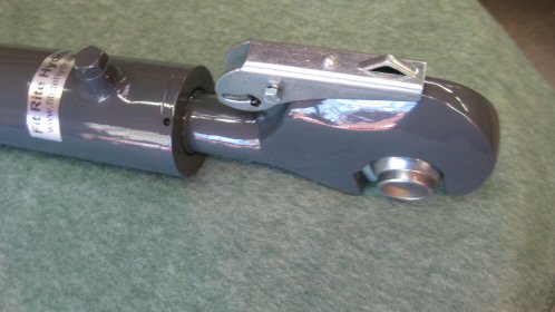

Here are the European type ends on an L6060. But then to complete the set, you need a hydraulic top link with a hook end. :cool:
You can get a complete draft link set with 2 sets of balls for $270 shipped to you, you can cut & weld to your existing extendable ends. Or you can ship your extendable ends to me and I cut, weld and return ship for $350. :thumbsup:
There's some older AG equipment here that uses those. I always thought they were very durable and useable. Quick Hitches kinda made them obsolete here.
I have these on the Branson 8050 and I find them nicer to work with then a quick hitch. I use a conventional hydraulic top link.
The main thing I find is they are easy and quick to fasten to the lower links and many times I will reach in to connect my pto before putting the toplink in place the room to maneuver without the quick hitch verticals and horizontal bars is very nice, it gives a person room to reach and lift to connect the pto without having to reach thru a quick hitch.
