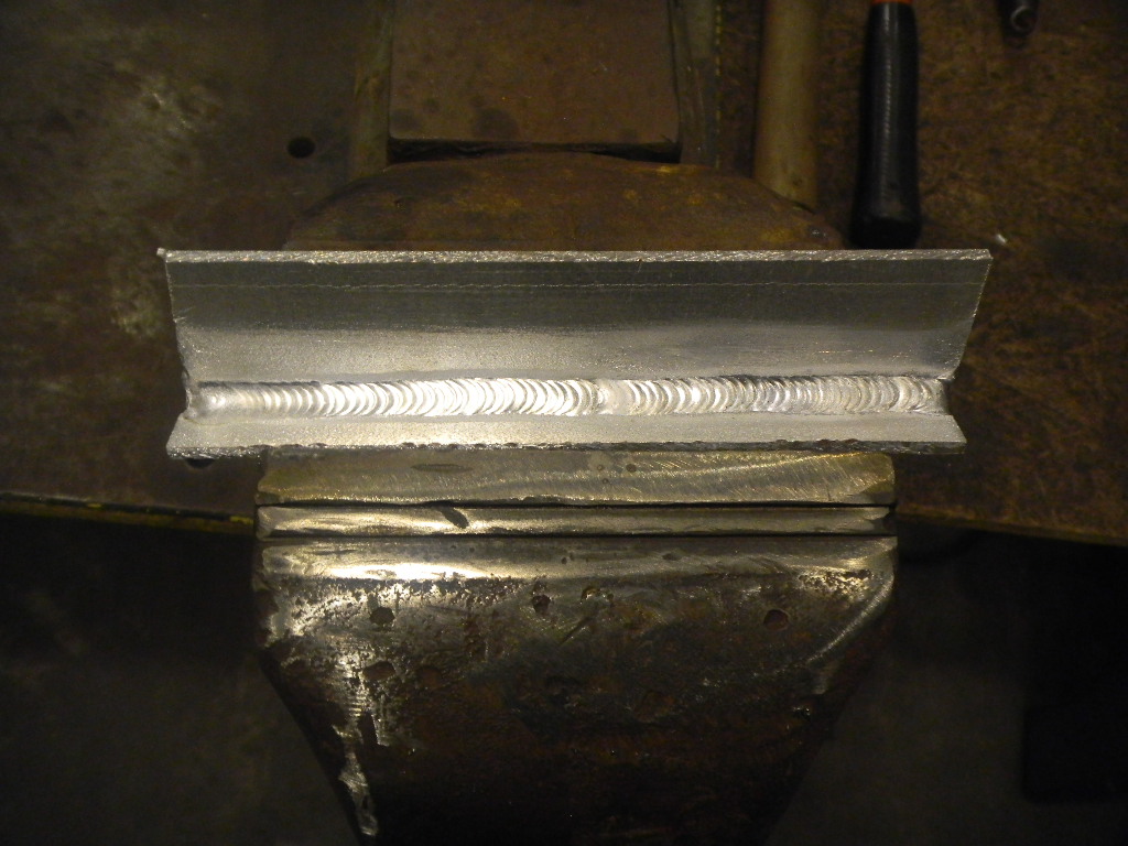

Tell me this kid isn't a natural! This is with about 2-hours of hood time:shocked::shocked:. His only problem, he forgets to back off the pedal at the end of the weld, (far left side). Color me impressed!:cool2::cool2:

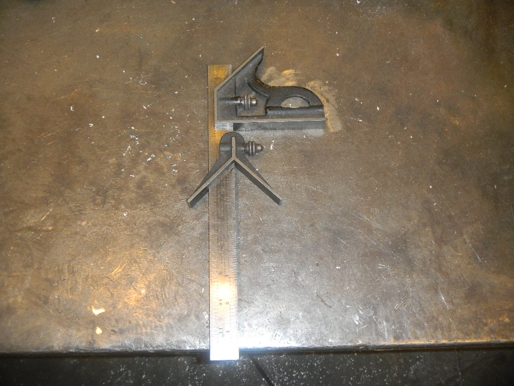

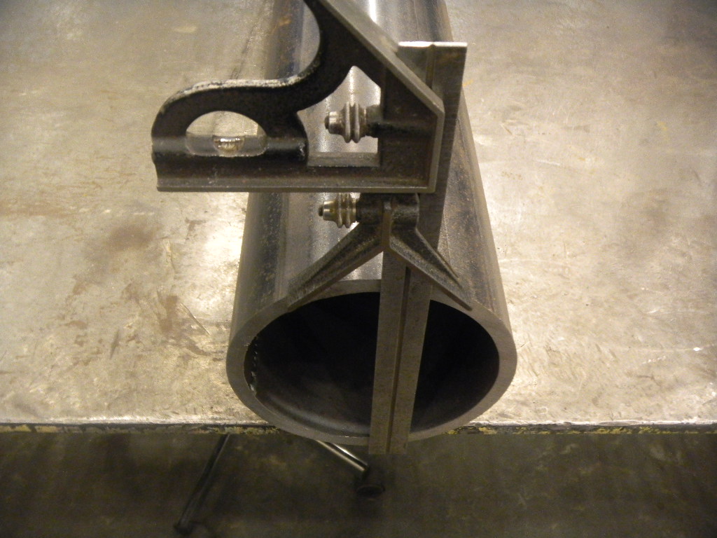

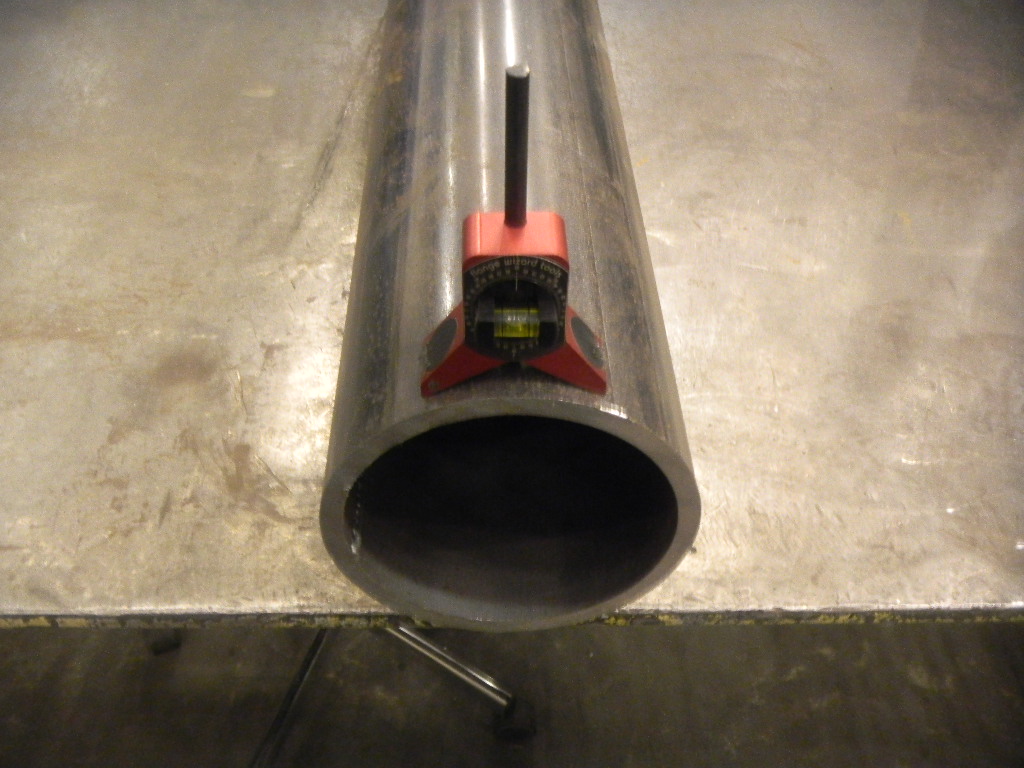

Do you have a center head? Mark center of pipe at each end, take a straight edge, or chalk line and make a mark from one end of the pipe to the other end. Transfer this mark to the opposite side of the pipe. You can even quarter the pipe if you want to.
I do! It'll be relatively small diameter tube (1" I'm guessing) so I could use the square attachment as a foot to keep the scale square to the layout table, then slide the center head down until it settles on the tube. Probably have to elevate the tube on some 1-2-3 blocks and v-blocks, but a setup like that would make it fairly simple to transfer TDC from one end of the tube to the other.
