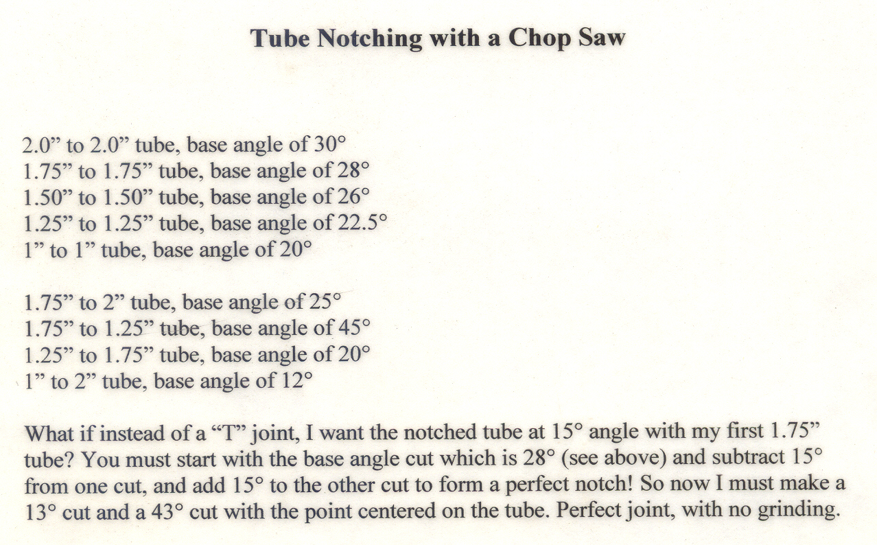

I've never coped pipe or tube with a chop saw. But here is a chart someone posted years ago who builds pipe fences for a living. Maybe this will come in handy for some of the members.;)

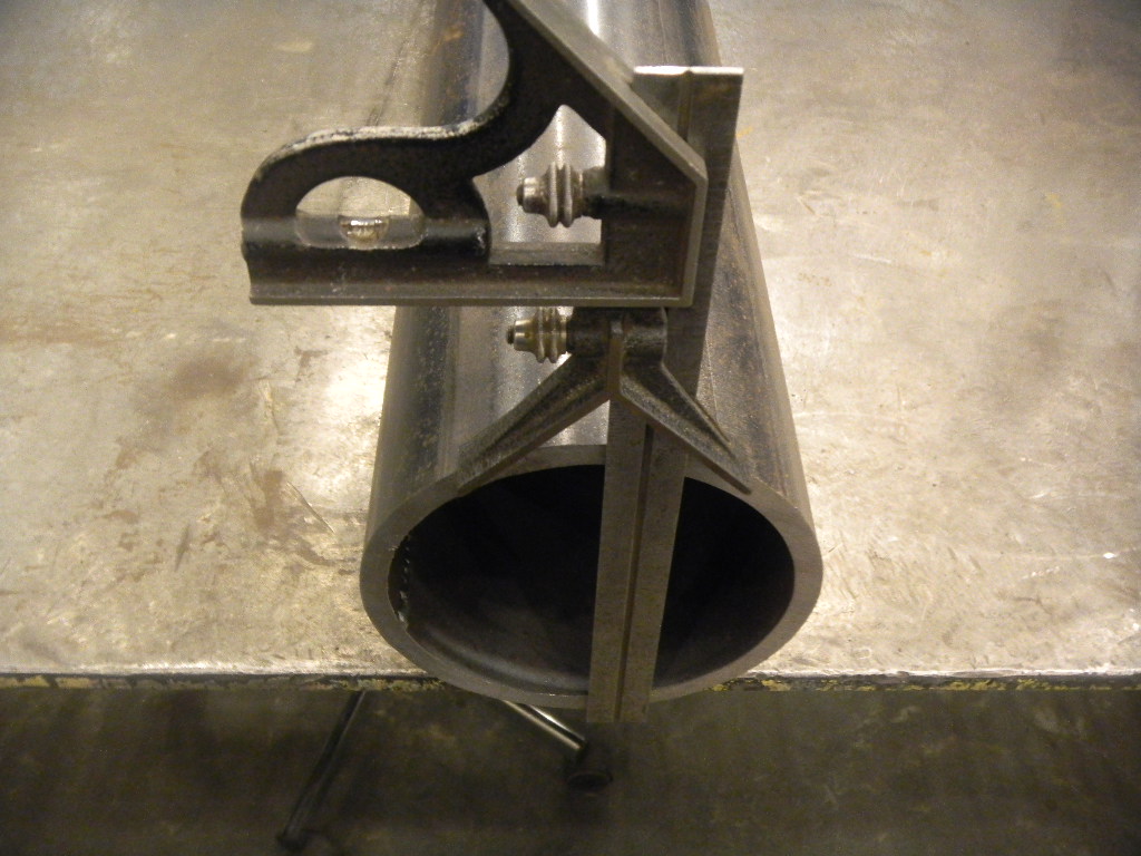

I have a job coming up where I need to cut 45° miters on each end of a 2' piece of tube, and I'm scratching my head how I'm gonna keep the miters aligned. The ends of the tube will be fit into a corner, so they need to align along a right angle. The tables on the bandsaw and mill aren't much help because they're either too small or oriented wrong to let me use a miter gauge. Your idea of tacking a length of something to the first miter just might work, but I'm open to suggestions... :confused3:

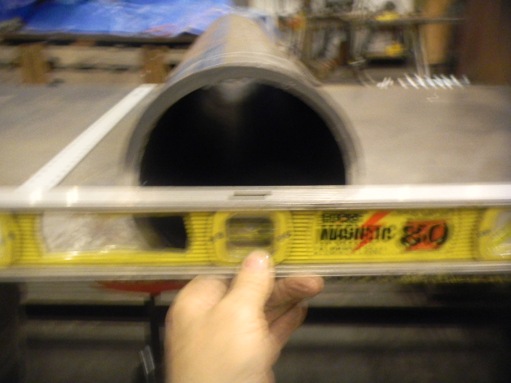

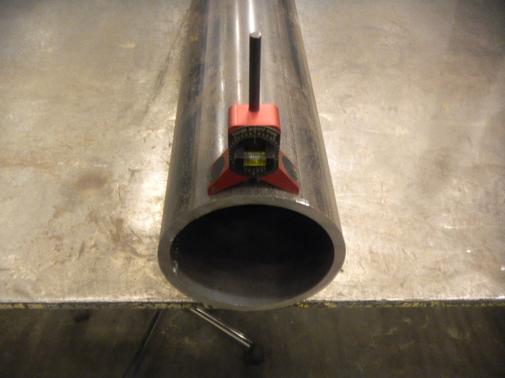

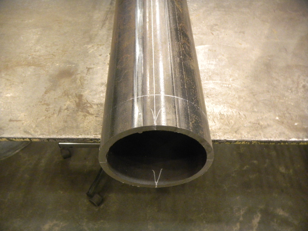

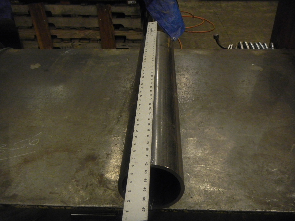

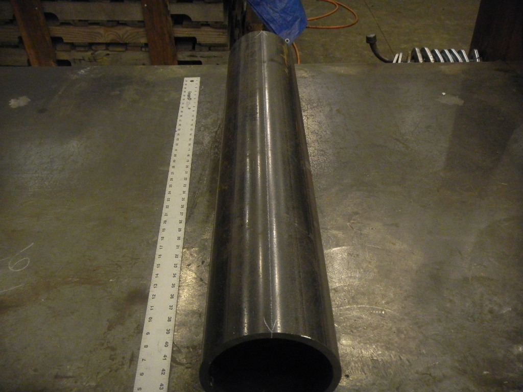

Do you have a center head? Mark center of pipe at each end, take a straight edge, or chalk line and make a mark from one end of the pipe to the other end. Transfer this mark to the opposite side of the pipe. You can even quarter the pipe if you want to.
I do! It'll be relatively small diameter tube (1" I'm guessing) so I could use the square attachment as a foot to keep the scale square to the layout table, then slide the center head down until it settles on the tube. Probably have to elevate the tube on some 1-2-3 blocks and v-blocks, but a setup like that would make it fairly simple to transfer TDC from one end of the tube to the other.

I really like these Flange Wizard center heads. Center punch built right into them. :cool:
