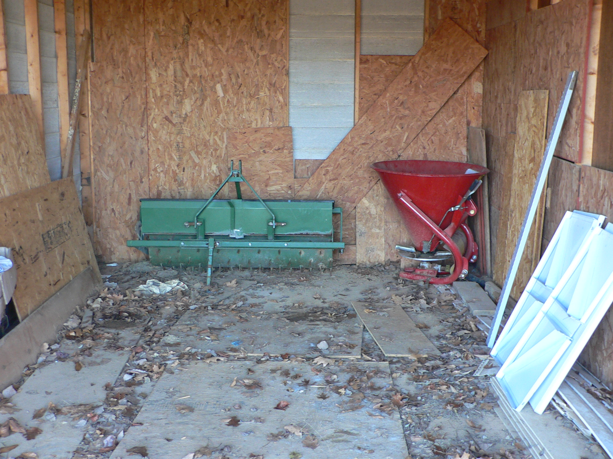

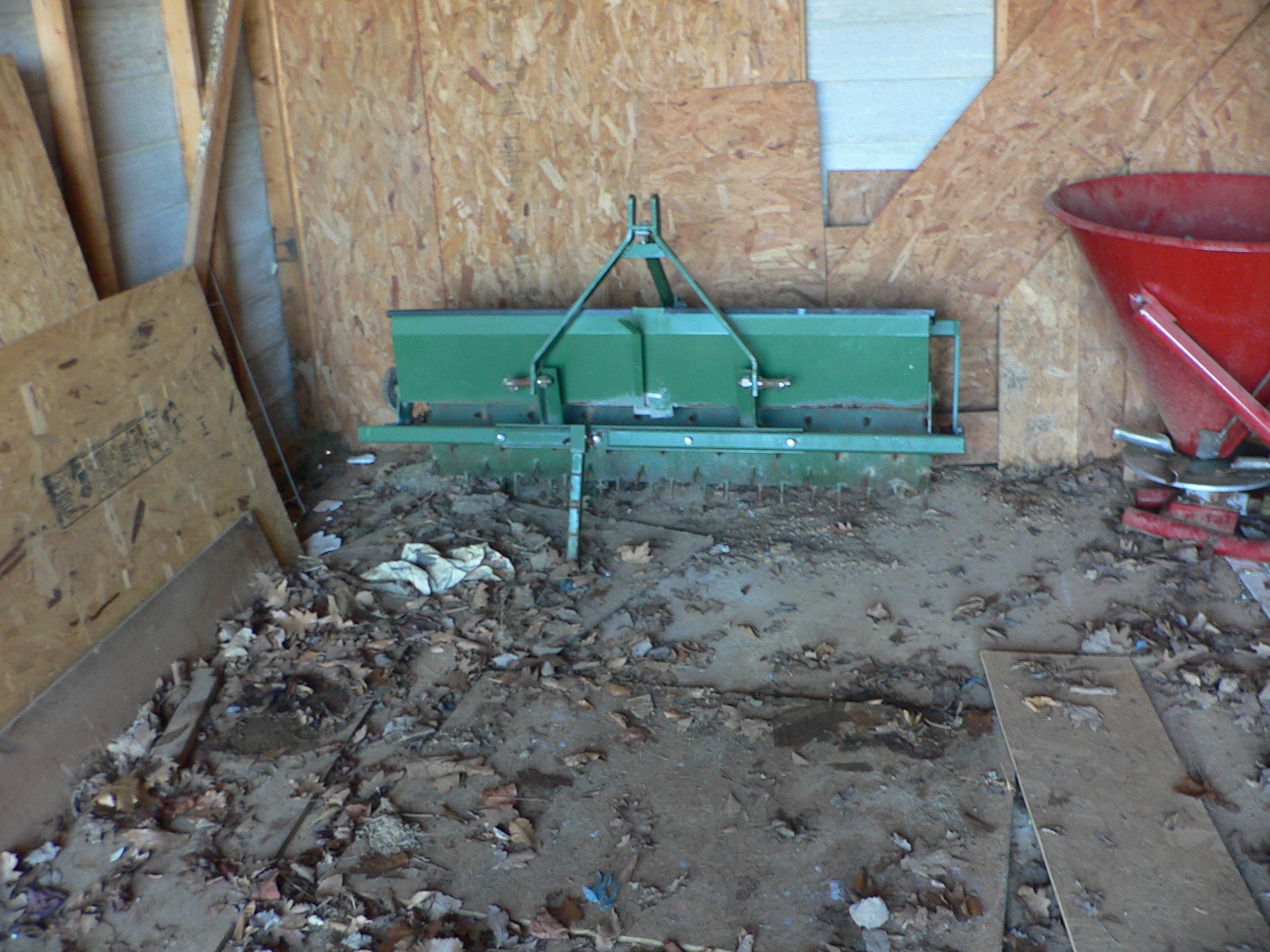

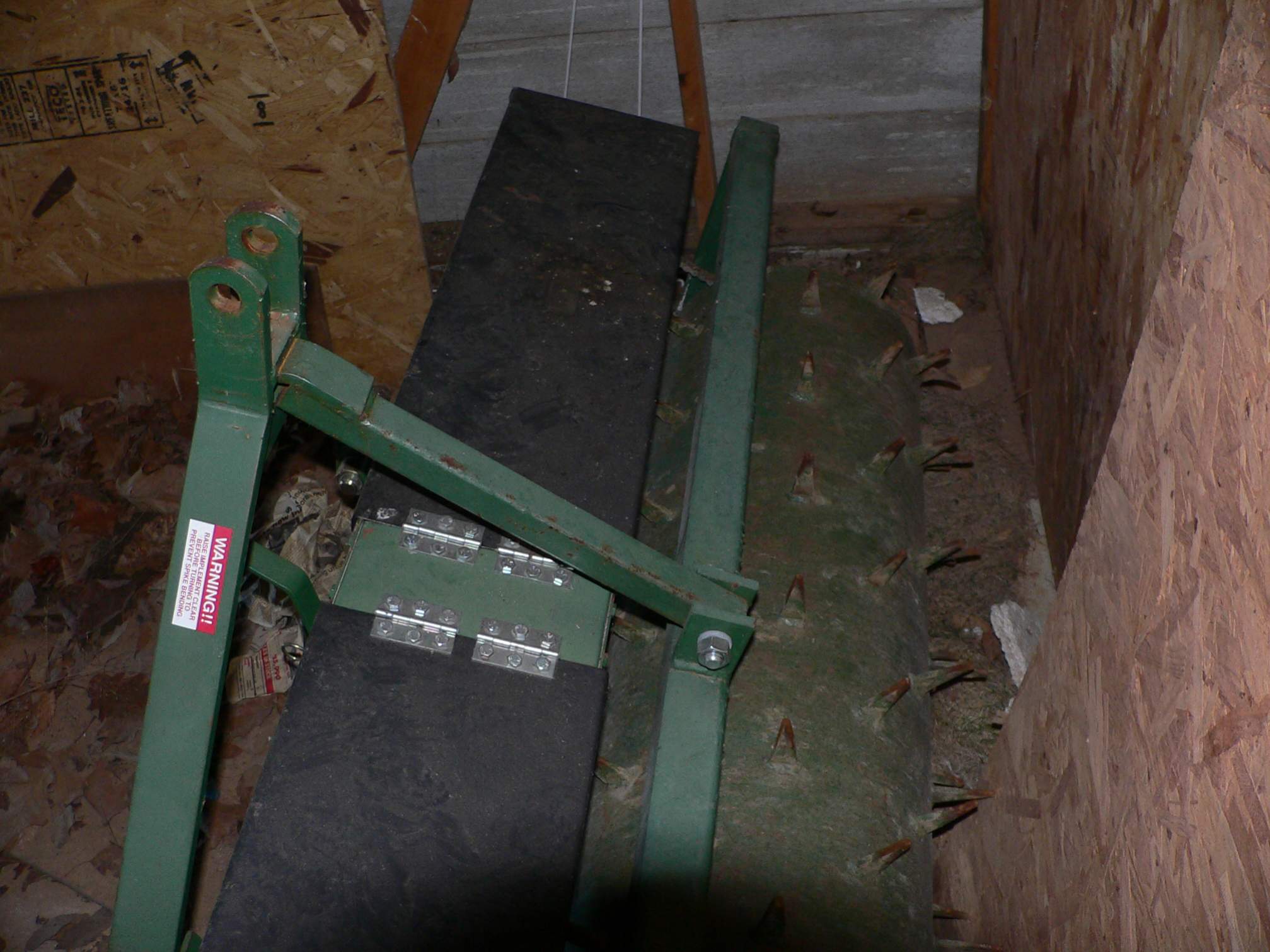

What aerator are you using with the BX John....3-pt style plugger or pull behind spike? Would you consider selling your BX now that you have the new 3200?
I do not feel foolish with 2 different tractors. With a 5 acres residential lot I would feel foolish with 2 of the same tractors, maybe not foolish but at least wasteful. Even if I had to much money. I don't believe I picked up on your 42 acres before. I'm sorry, I must have just missed that detail in your post. My BX can not do what my B3200 is doing. I had a BX2200 FEL MMM and due to the terrain of my land and the work I was doing the BX kept getting hung up, to low ground clearance. That's why I ever went to the B model to start with. I then went to a L3240HST and it was to large for my 5 acres residential hillside, gullied, rocky and treed residential lot so I went back to a B model. I have had a BX model for the 5 years I have had tractors. After trading the BX for a B I bought a BX1500 MMM no FEL and then traded it for a BX2350MMM no FEL. Again, I have a 5 acres residential lot. I don't have an additional 40 plus acres to do something with. If I did I would have kept my L3240HST FEL and my BX2350MMM no FEL. I have a Ferguson Overseeder spiked for overseeding. I used it once for also fertilizing but didn't do to good of a job for me so I have the funnel fertilizer now.

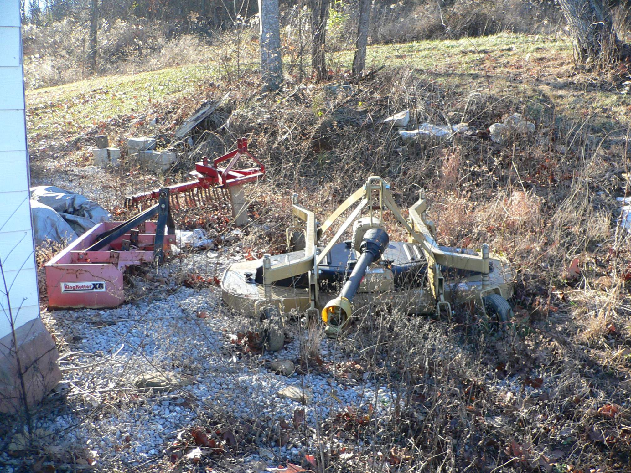

Here are some photos my BXs in action.
Pictures of my tractors at work
