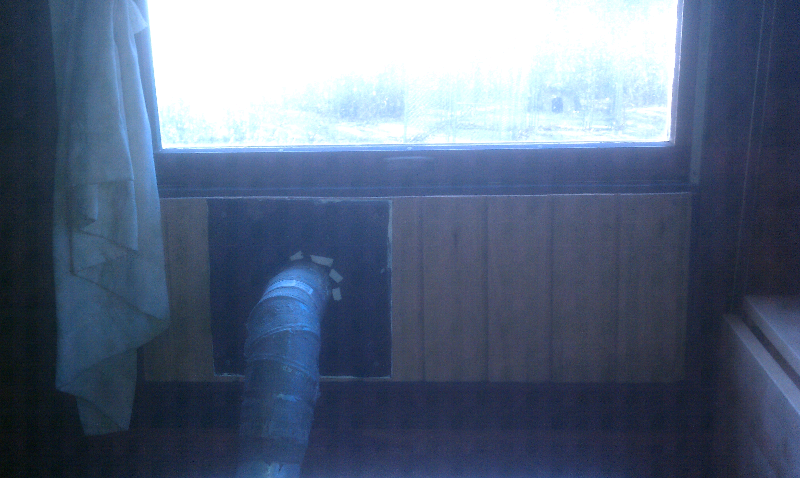

Due to living in a log home and not wanting to butcher a wall , I've customized and insulated , thimbled, double insulated vent threw a window. Not up to code worthy , but safe , and seasonal. Complete with duct tape seal.
