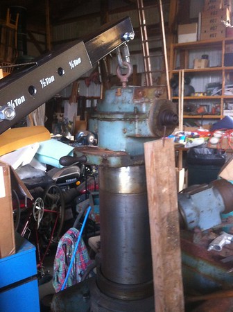

Nothing works instantly, as soak time is always a 'must', and sometimes 24 hrs isn't long enough. Here's a job I daubed Kroil onto for weeks to work it in, using a Q-tip to wipe it under the flange, where the wheel-head and motor rest/rotate on/inside the column sleeve. They had been rusted in position for >10yrs denying rotation of the head/spindle in the X-Y plane. I took this pic when propping the head up to swap-out Cinci T&CG's 440v 3-Ph power for DC treadmill motor (w/diode bridge and HFT router speed controller .. ;)) What worked to get it freed up was secondary to applying it where needed. :)

Edit: Unless I'm working on something like oldgrind is doing up there^. That takes precision, patience, and more patience. Well done!
