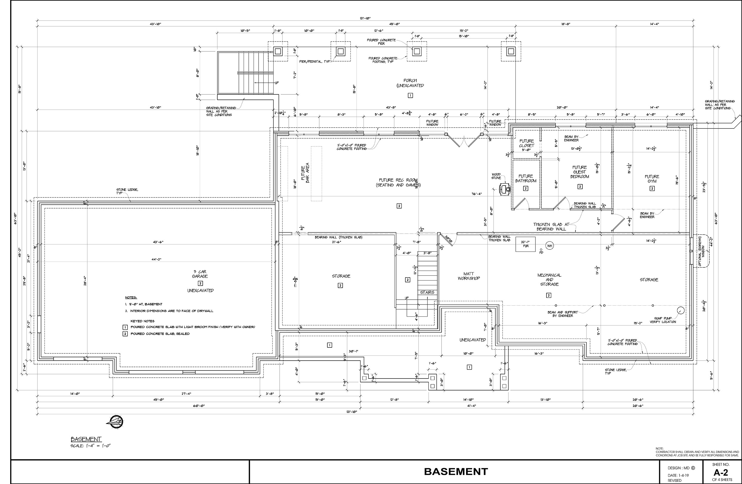

We're build a single story with a walkout basement. About 2900 sq.ft. We're doing ICF for the basement, R10 subslab (most likely Nudura or Creatherm panels), NuWool in the main walls and ceiling (R49 ceiling with raised heel trusses). Debating on whether to go Geo or variable speed ASHP at this point. We have no NG, and I don't want to deal with propane or oil.

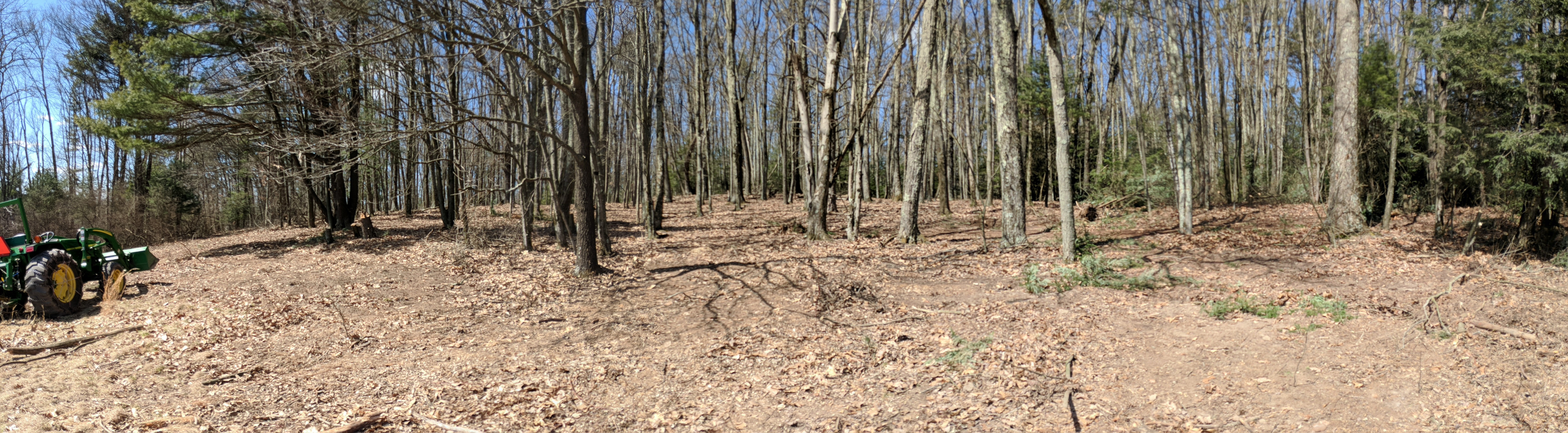

The building when we started:
The driveway is almost a 1/2 mile long, about 950ft of that needed cleared, the rest covers existing ag fields.

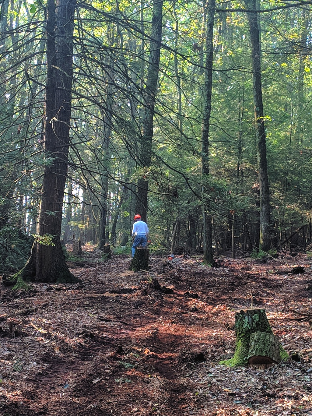

Dad cutting on the new road this summer. The bugs and humidity made this really fun.

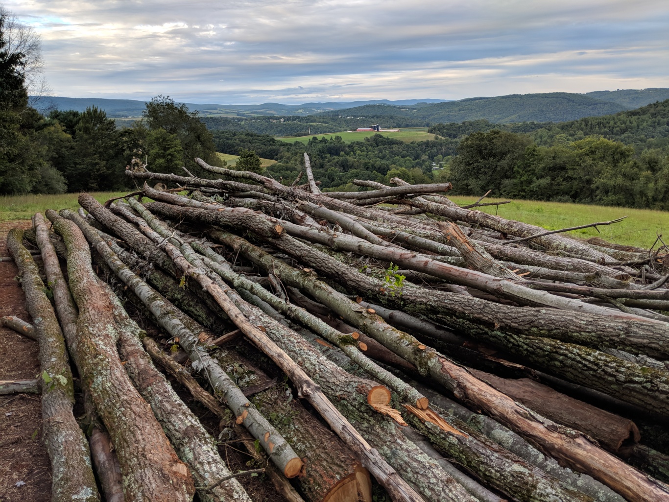

We took a lot of timber out. This is just one pile of two of pole wood. Saw logs were taken and sold.

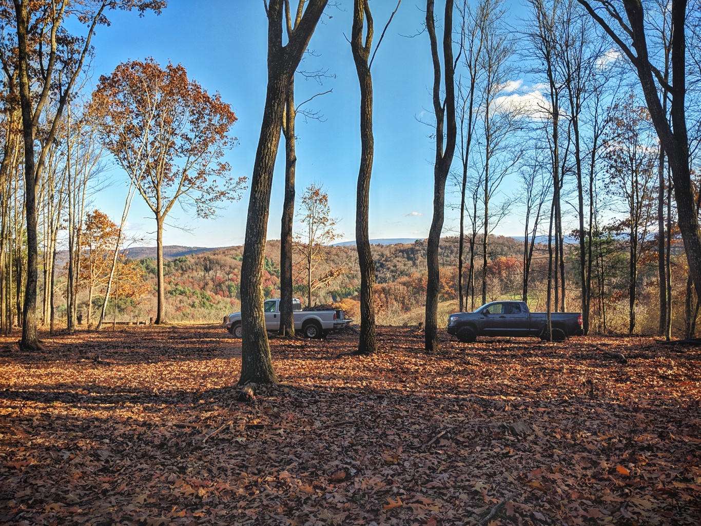

The building site as it stood this past fall:

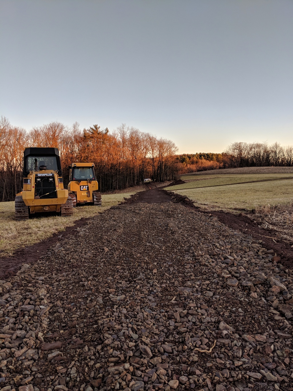

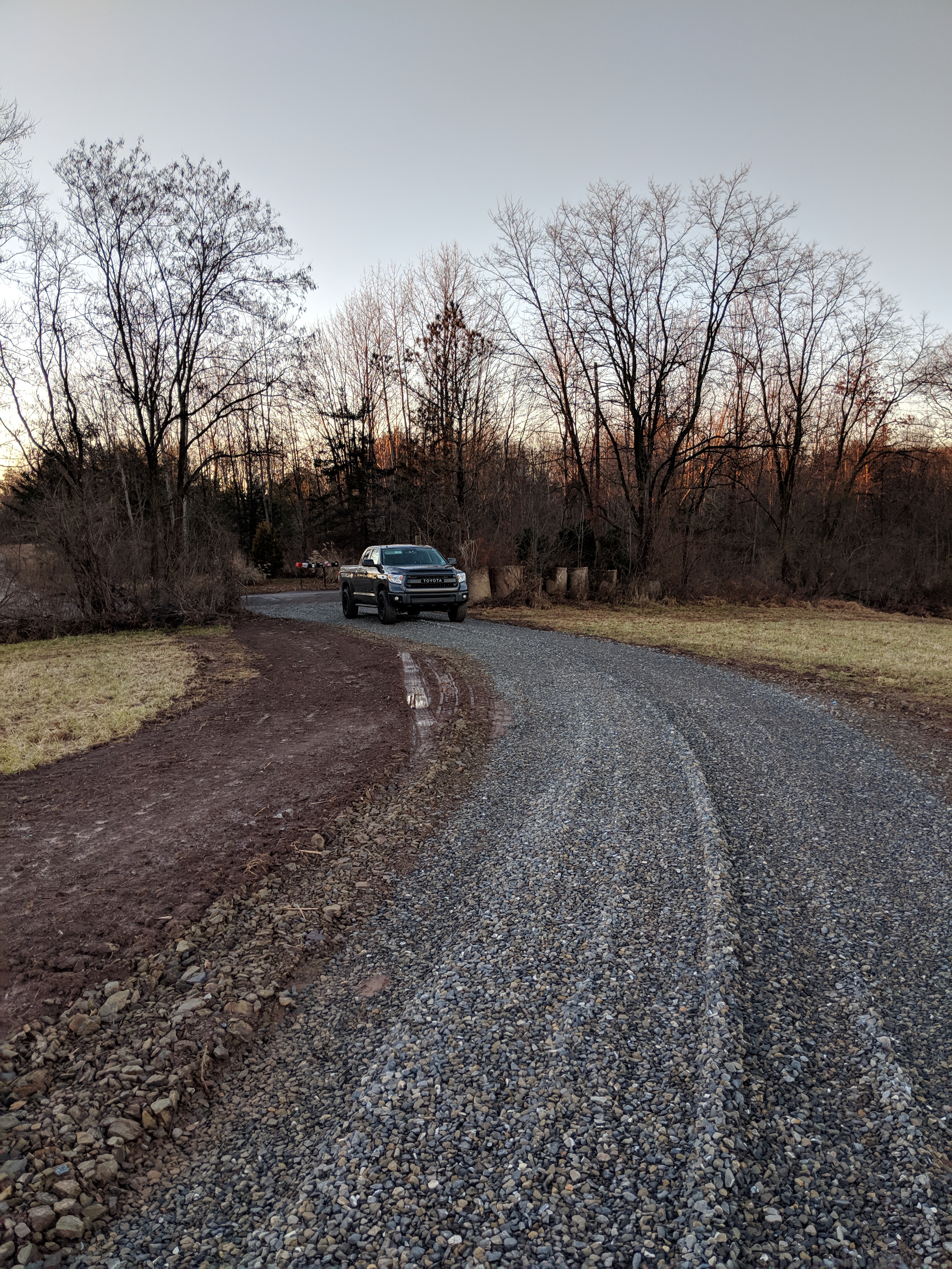

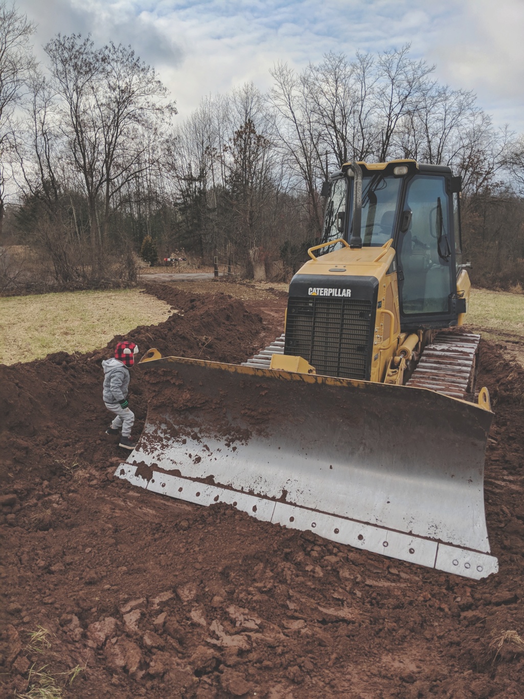

Once everything froze up a bit, we brought out the big guns, and had our driveway cut in:
The excavator put in between 10-12" of shale, and only did a quick topcoat of 2b for the last 100ft to cut down on mud hitting the township road. We will finish the road once construction is all finished.
