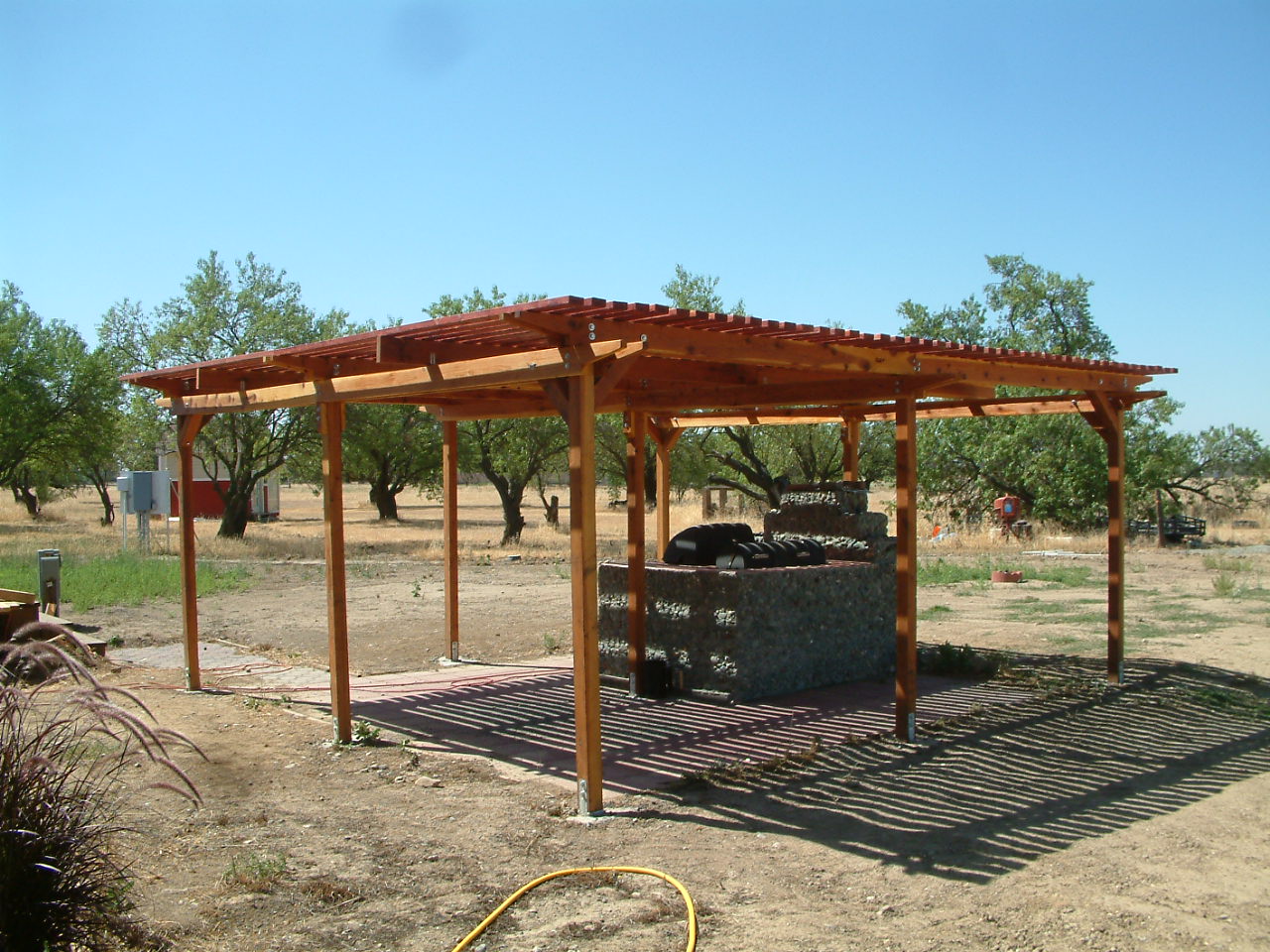

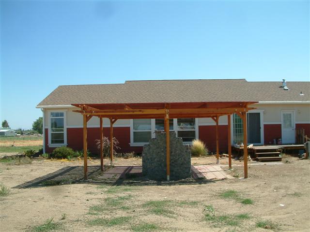

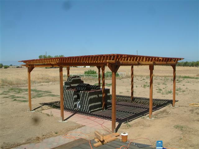

I built this pergola about 9 years ago.
Used Simpson post bases in concrete. The main structure is bolted together with 1/2" hex bolts/nuts. Braces are attached with 1/2" lag bolts. Every few years I tighten the bolts. No wobbles at all.
Good luck
