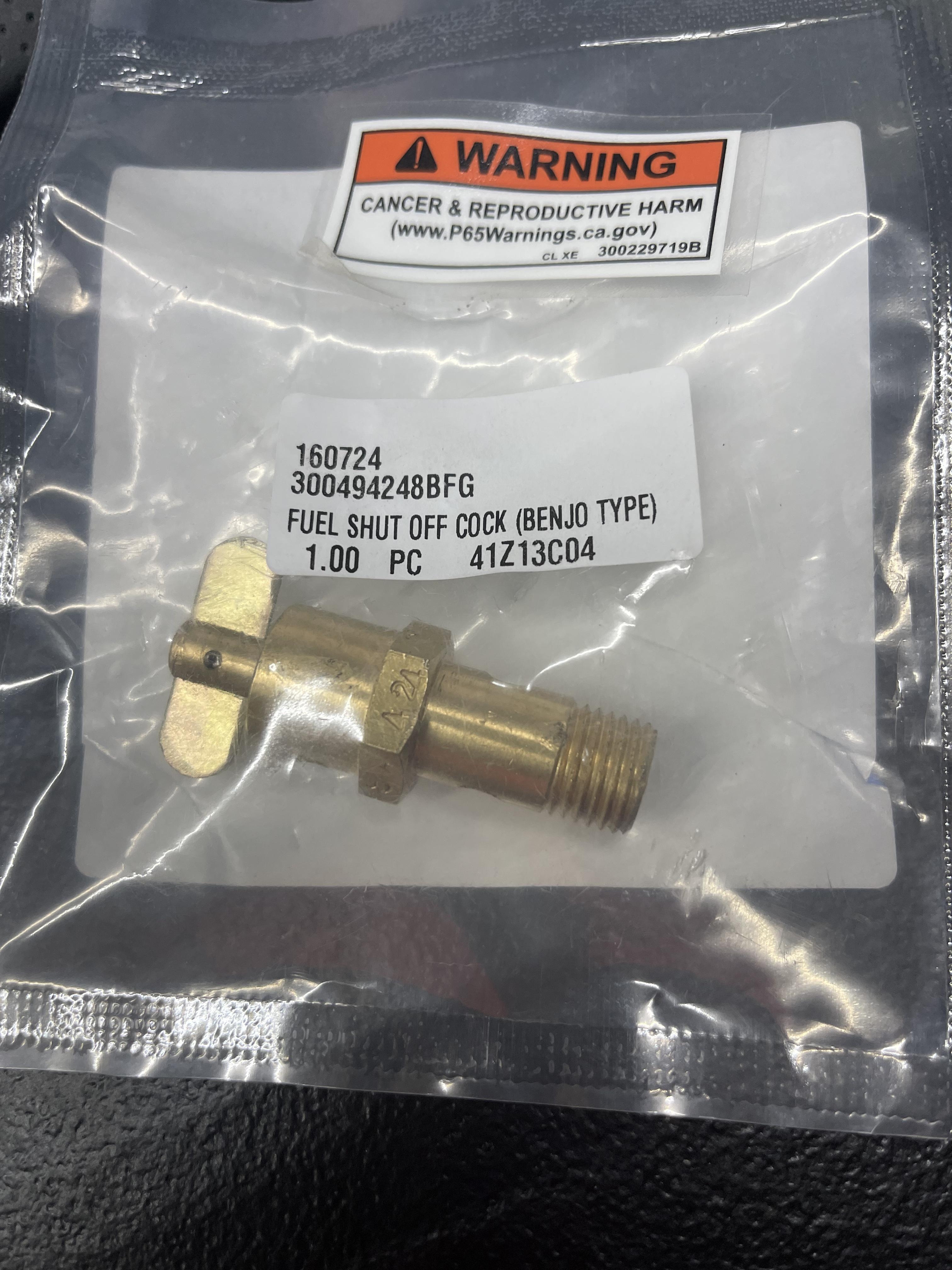

Thank you Summit, I received the Fuel Shut Petcock today. Now can anyone tell me where this screws in/mounts in the line?? Appears in the Summit Mitsubishi Engine service manual that there should be a Sediment bowl type fuel filter on this tractor that this might screw into but I don't see one???

Thanks Summit for emailing me the exact steps which reassured I was doing the correct install of the Petcock. It was easy. Just use a 19mm wrench, unscrew the input line Banjo bolt, replace with the part from Summit with washers in the same place, tighten, done.
