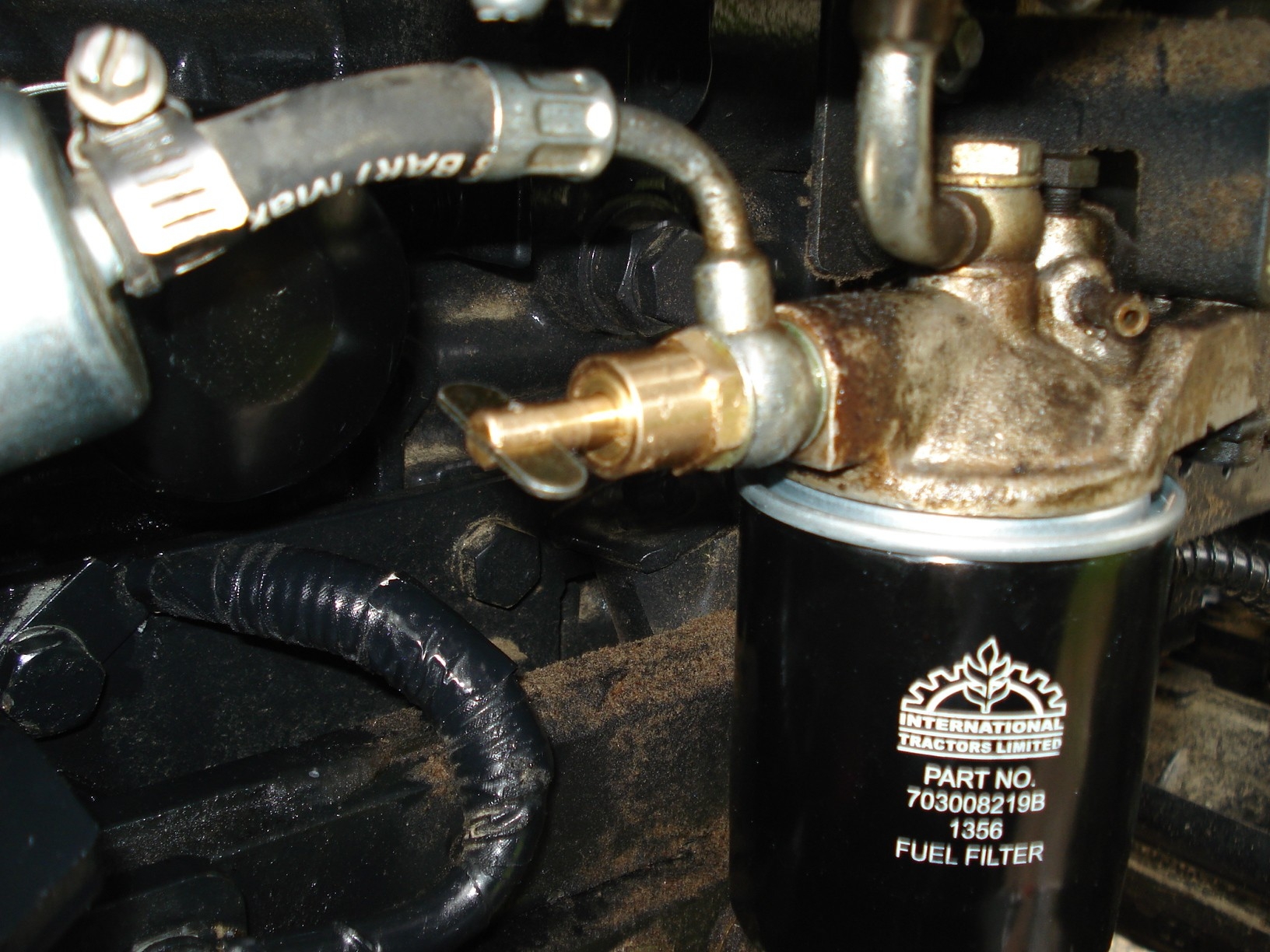

Where is the petcock on the Summit TX25H fuel line. Manual states to shut off petcock to remove fuel filter.???

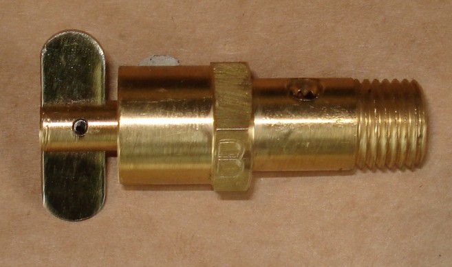

Attached is another view of the installed fuel petcock.
