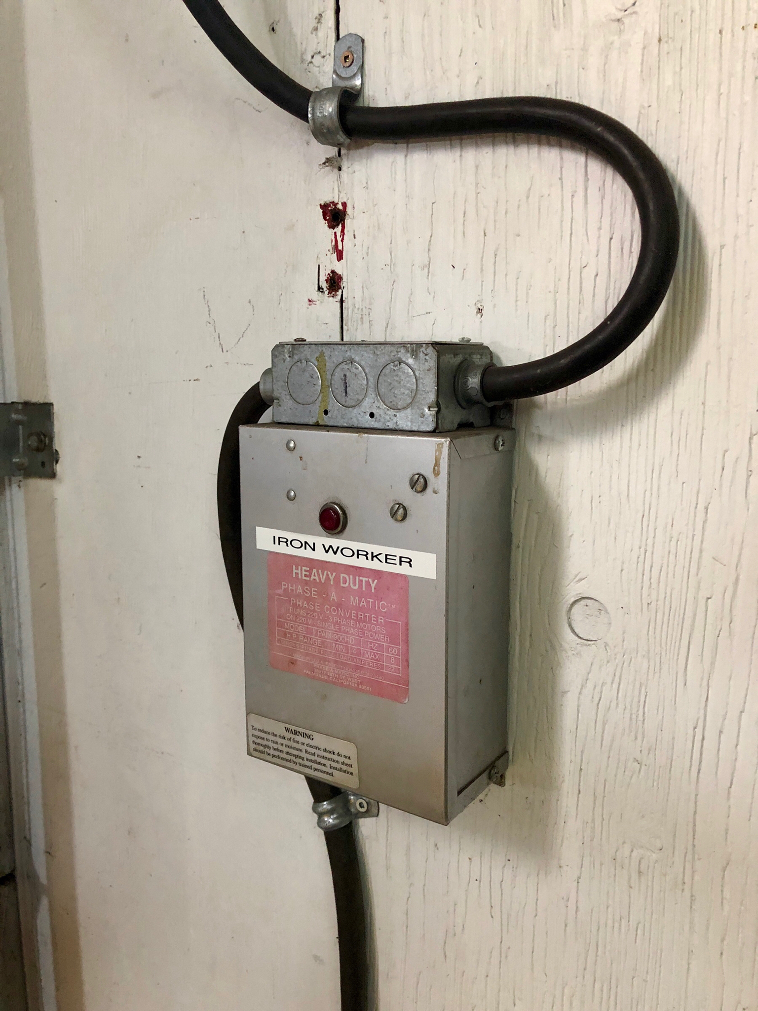

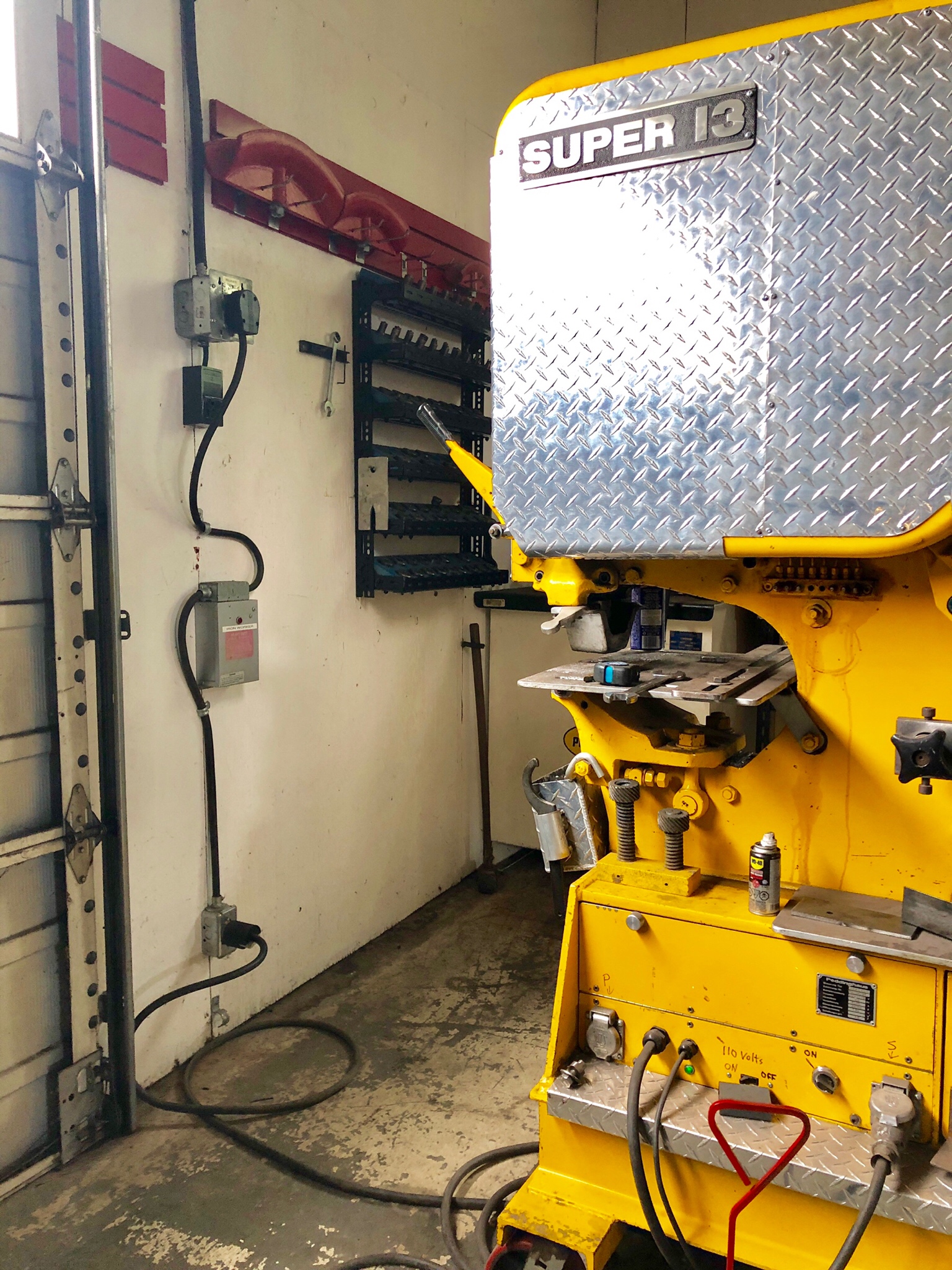

There have recently been several threads on converting single phase to 3 ph Surplus Center has just advertised a 3-5 HP phase converter for $220. Link attached.
3 HP To 5 HP Phase Converter | Bargain Bin | www.surpluscenter.comase.
Ron
That same converter came with the Peddinghaus iron worker I bought. I have three phase in my shop but didn’t feel like running 30 feet of new wiring especially since I wasn’t certain of its ideal location.
Using the phase converter was a no brainer as I already had a 50 amp
welding plug nearby.
