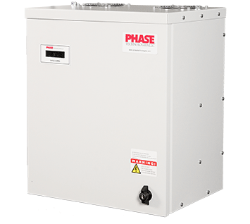

The tend to cost about $125 to $150 per hp. Here's a website with several different sizes available from 1 hp to 30 hp. phase converter drives
