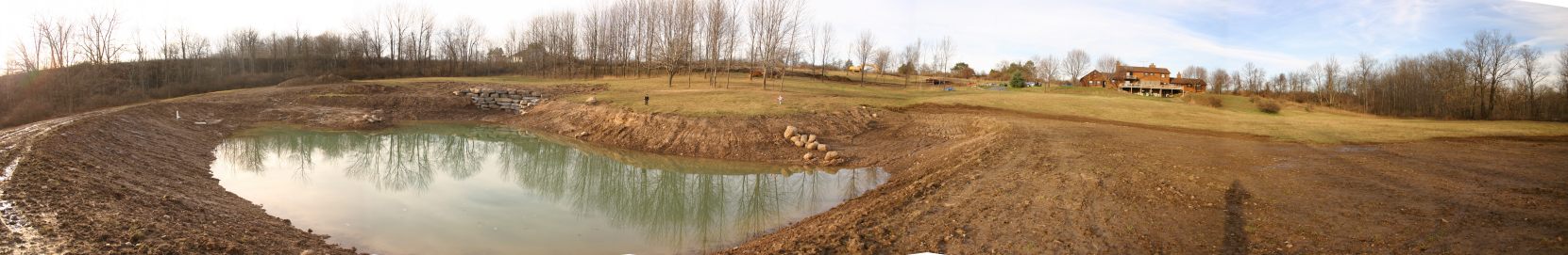

Re: Pond picture update
Whoops let's try that again.
Lar
   / Photo Diary of 1/2 acre pond construction #52
Larry, the pond looks really nice. I'm amazed a how much water it already has in it. How many inches of rain have you had since the pond was finished? If it were here in Texas, I'd suggest sowing winter rye grass on the bank, but there you are probably going to have a solid cover of snow soon.

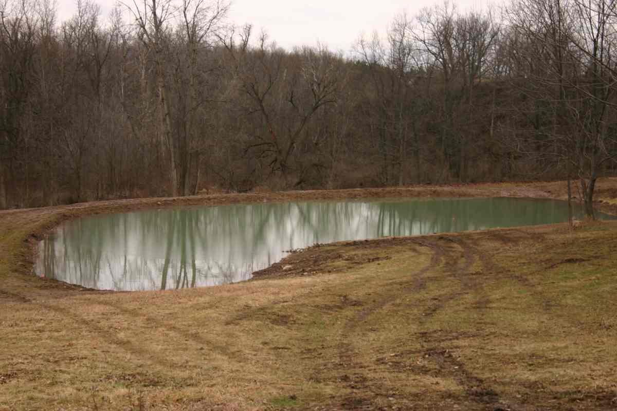

Thought I would post a couple pictures to update this thread on the filling of the pond. This picture is from November 21st.
#56

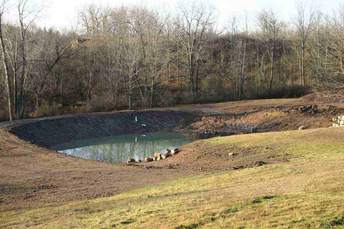

Here is a picture taken on January 1. Pond is completely full. It took 2.5 months to put 9-13 feet of water in it. During that time period we receieved about 9" of rain. Not bad.

   / Photo Diary of 1/2 acre pond construction #58
Larry, your pond filled up really fast. In the time you received 9" of rain, we had only about 1-1/2". That means I've lost as much water out of my ponds as you've gained. In the springtime when the grass turns green, you are gonna have a really pretty spot.
I am curious where your safety overflow is? Is it to the right in your pictures? The reason I ask is it looks like your dam doesn't have much freeboard left, and you sure don't want water overflowing and eroding the dam. I had that problem with one of my ponds when I first bought my property. The dam had a washout the size of a truck in it. I repaired the dam and put a large culvert pipe in for overflow and so far I haven't had another washout. /forums/images/graemlins/grin.gif
#59
Jim,
Good eyes. The emergency spillway is over to the right in the picture. What we did when building the pond is to build in an outlet valve from Sched 40 PVC that goes through the core trench and out the back. If you look at the second to last picture you can see the white vertical pipe. In addition we put unscrewable outlet valves every two feet such that if I wanted to take the water level down in 2 feet increments for maintenance I could do so. The benefit of this is it keeps the emergency spillway there for emergencies but it won't be continually wet. I can tell you that there is a good amount of volume running through my PVC pipe outlet from the pond. I wouldn't want it running over the spillway.
Thanks Jim,
Lar
