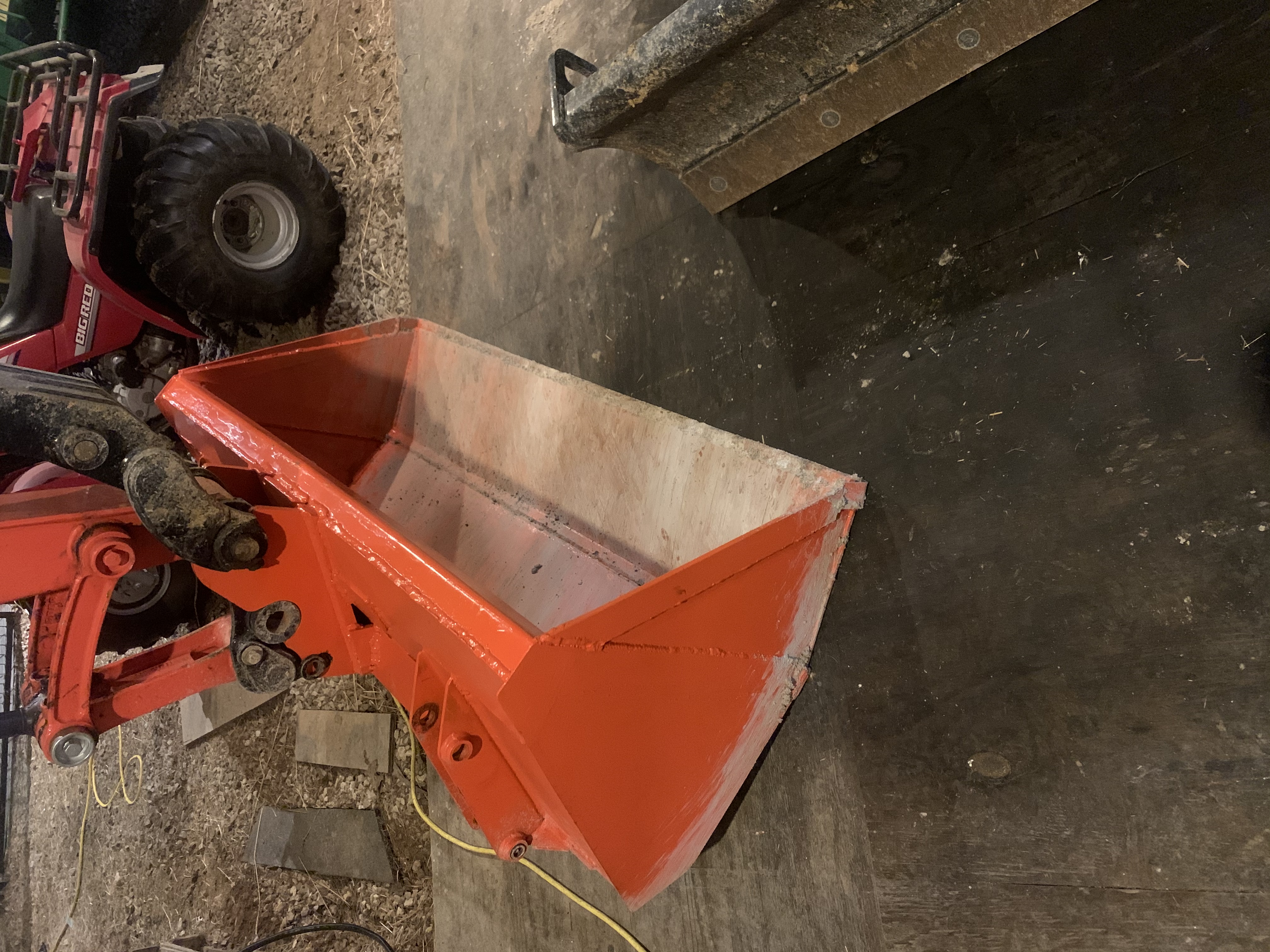

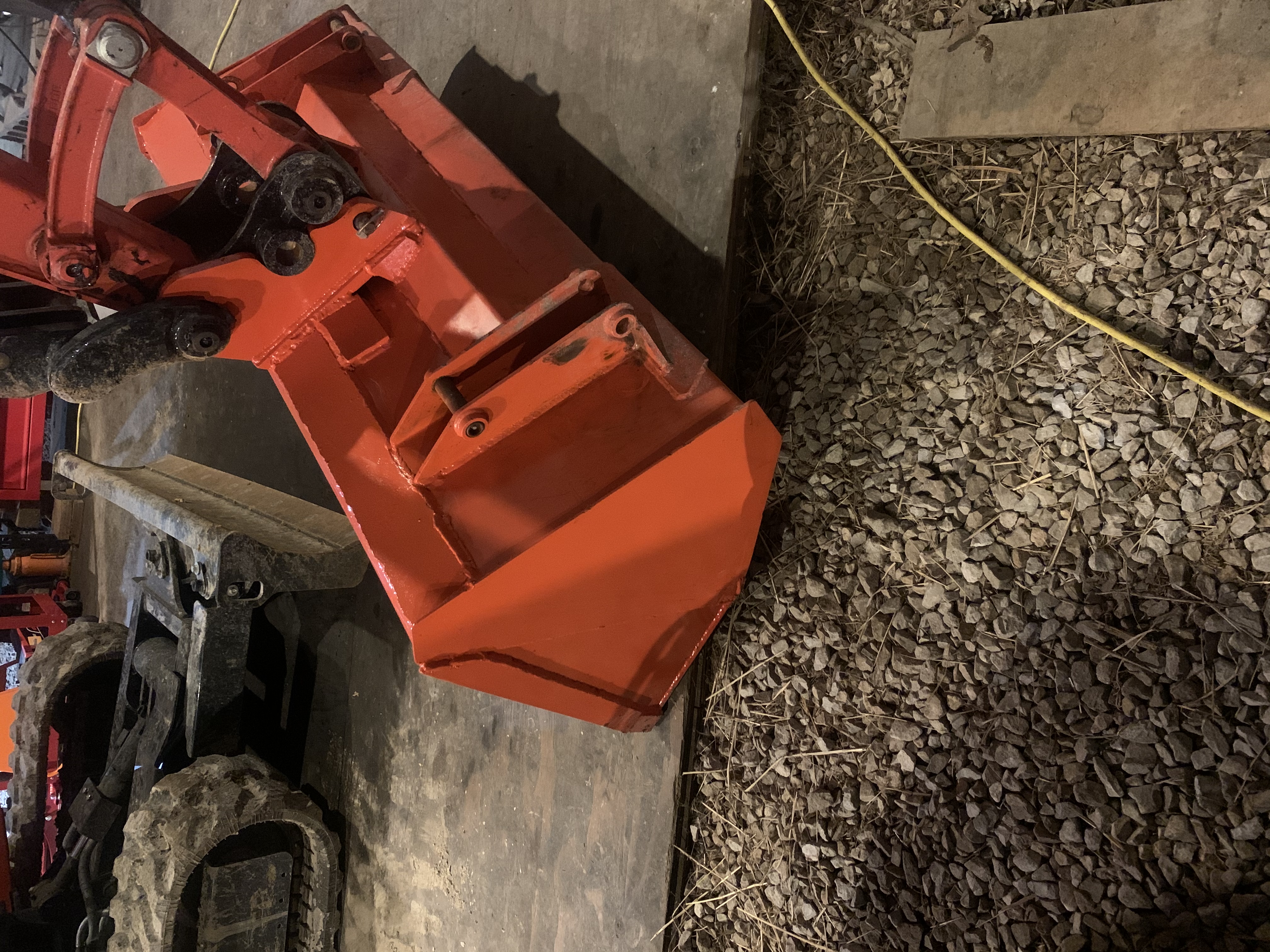

Frankenstein bucket.
I needed a gravel bucket for my kx040 to backfill sewers. My dealer, like lots of dealers, have a bunch of pin on buckets that come on smaller tractors. Welded the adapter on, reinforced and made deeper. Works great for gravel.

I think you did a good job (for gravel) and should save you time. Are you dipping out of a truck ?
   / Pick of my Frankenstein bucket.
No, just gravel piles on job sites.
   / Pick of my Frankenstein bucket. #6
A 40 isn’t a big enough machine to dip trucks sitting at the same level as the truck. My buddies 80 can barely do that and it still works better sitting higher than the truck.
