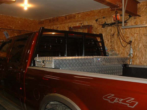

Here is a picture fully installed, with the tool box on.
It was about 8PM at night so I had to take the picture in the garage. I will try to get a better picture out in the daylight and post it.

The total cost for all of the steel and the paint was less than $100. It took about 6 hours to fabricate it and 2 hours for primer and paint. It was fun, but I am so glad to be done cutting and grinding. I do the cutting with an abraisive cut off saw and it is loud and sprays little sinders and sparks everywhere. The welding with my MIG machine is actually the fun part. /forums/images/graemlins/grin.gif

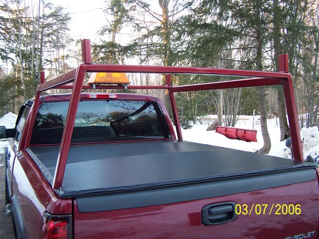

I recently did a similar rack. I wanted a rack to haul ladders, mount my plow light, and antenna's so I didn't have to mount or drill holes in the truck roof. Store bought similar units were $450. and up so I decided to build my own. I bought 2 - 20' lengths of 1 1/2" x 2 1/2" heavy gage tubing for about $150. and built the attached to fit into the stake pockets. I should have took pics as I built it but wasn't thinking of posting it here. Mine took 2 evenings, and part of Sat. & Sun. to prime and paint. Total of about 12 hours. By the way, nice touch on the horseshoes.

George,
You did a nice job! I like how the color matches you truck's paint.
