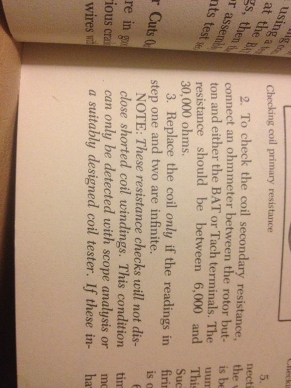

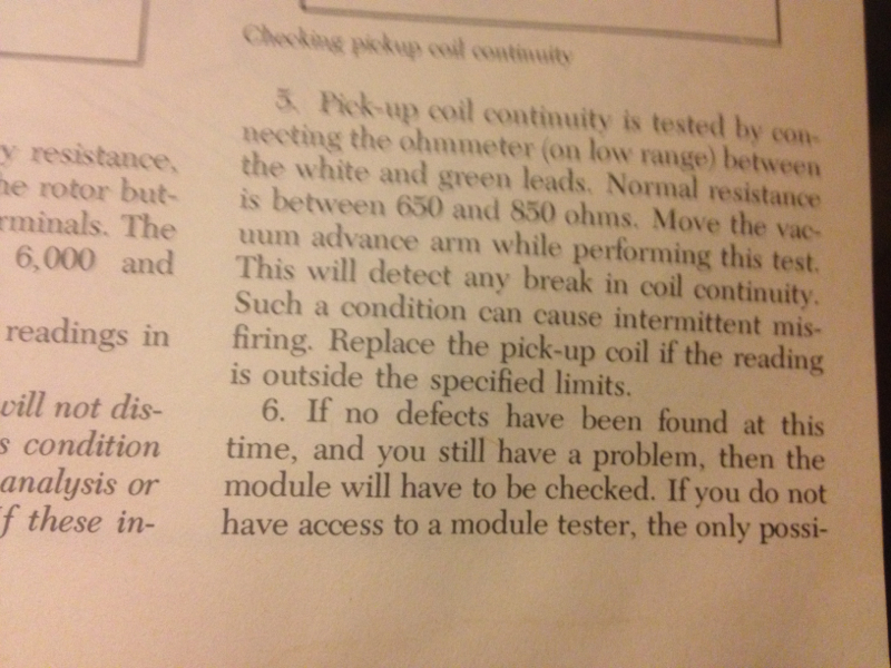

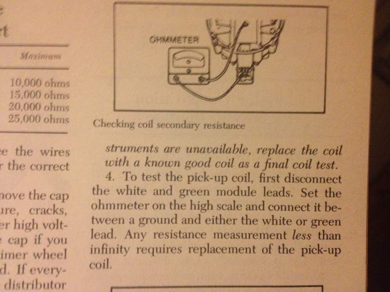

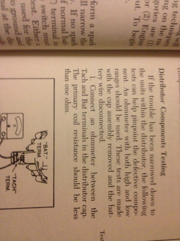

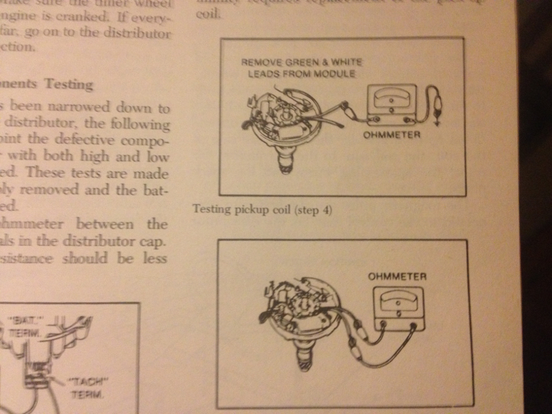

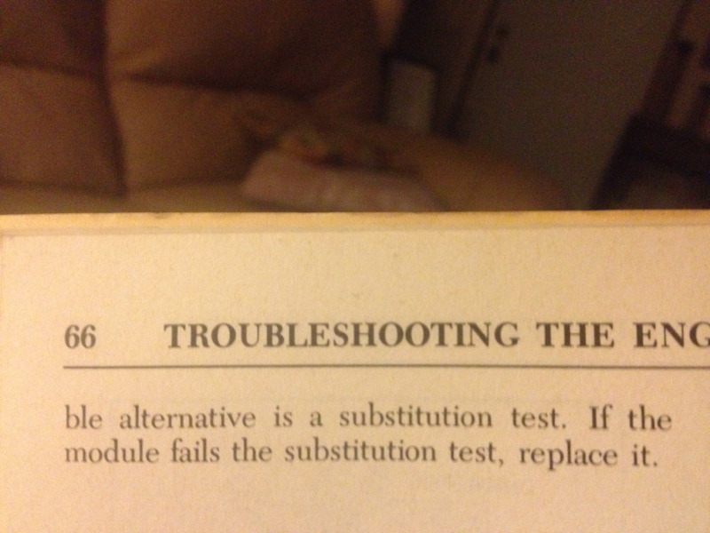

Thanks for those trouble shooting pages John!
I'll perform those tests to see what is going no.
