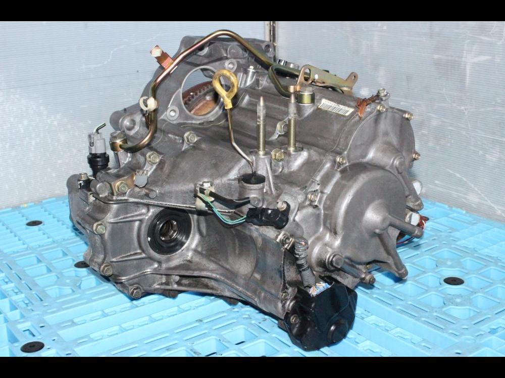

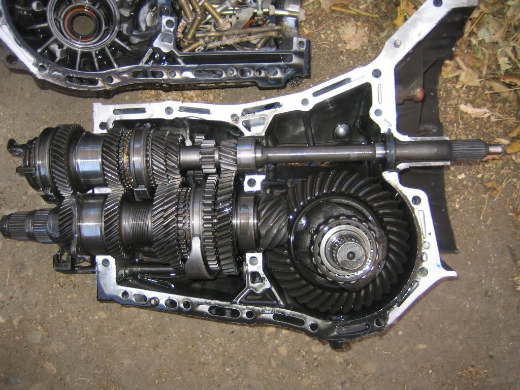

Thank you for taking the time to crunch those numbers! This is a front wheel drive car and the "differential" is integral with the transmission. It probably would be very difficult to tap directly into the transmission output, bypassing the differential. See the attached picture; within the transmission housing, the transmission output goes directly into a hypoid gear to the axle output. So for the time being, it seems the best options are either to come off the axle output or the serpentine belt.
With regards to the locking of one side axle to double the speed of the other side, I am aware of that scenario in RWD vehicles that actually have a differential. But does the same hold true for a FWD car? I really don't know. The "diff" internals in the attached picture don't seem large enough to be as complete as a rear diff. I was kinda assuming that I cpuld just pick one side or the other depending on what direction of rotation I need, and I wouldn't have to worry about welding any diff parts or locking the opposite side. I hope that's not an oversight on my part... someone let me know please!

Yes you would have to lock the diff just like a truck axle. In theory you could lock one axle to halve the ratio, but they are only designed for intermittent use so running a generator with constant load I wouldn't expect it to last very long.
My little brother liked to do one wheel burnouts in his neon, until it spit the spider gears out the bottom of the transaxle.
   / Picked up half a megawatt worth of Caterpillar power, think I'll make a PTO generator
#129
Well, crap. That's inconvenient.
