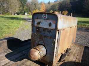

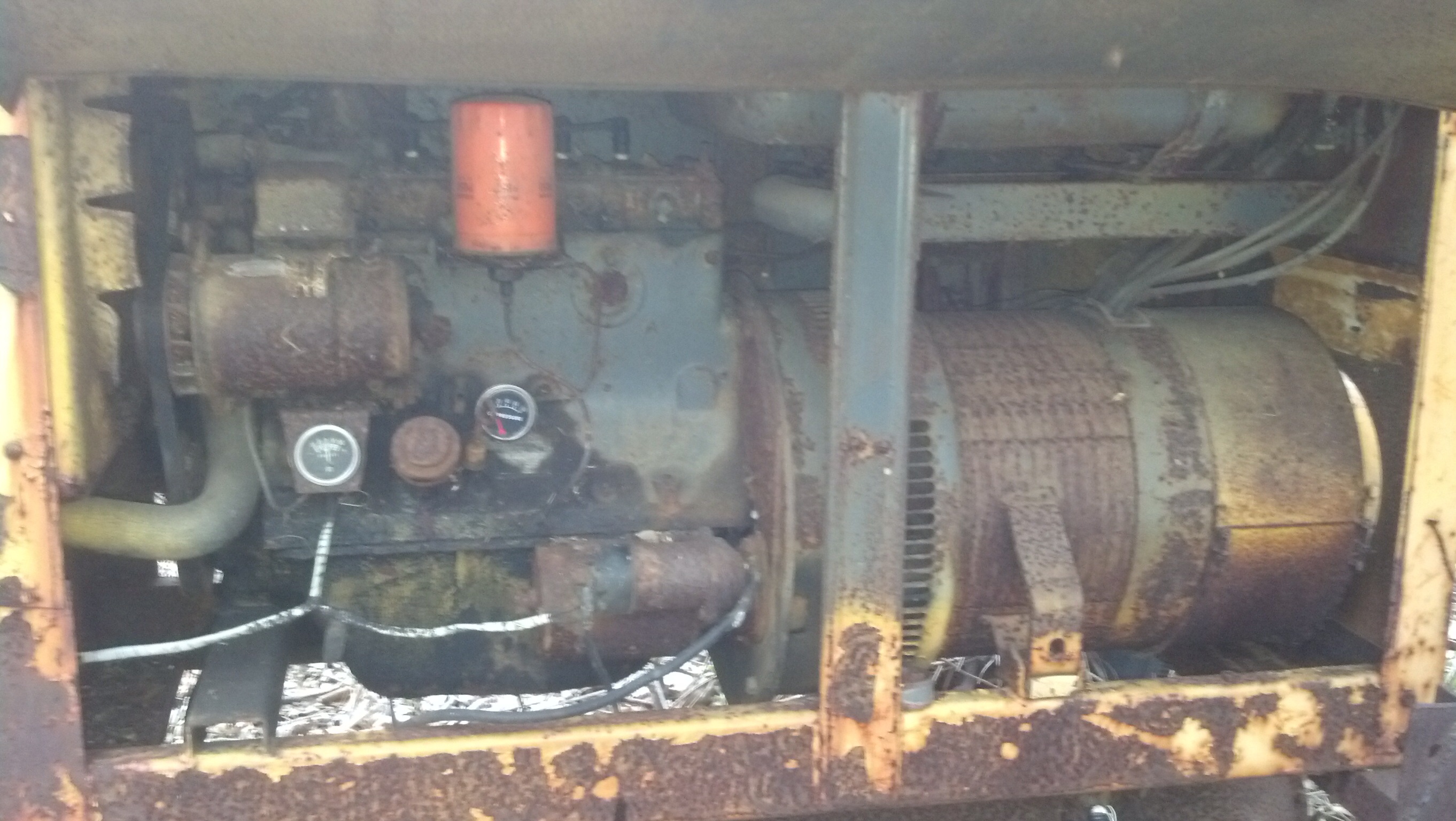

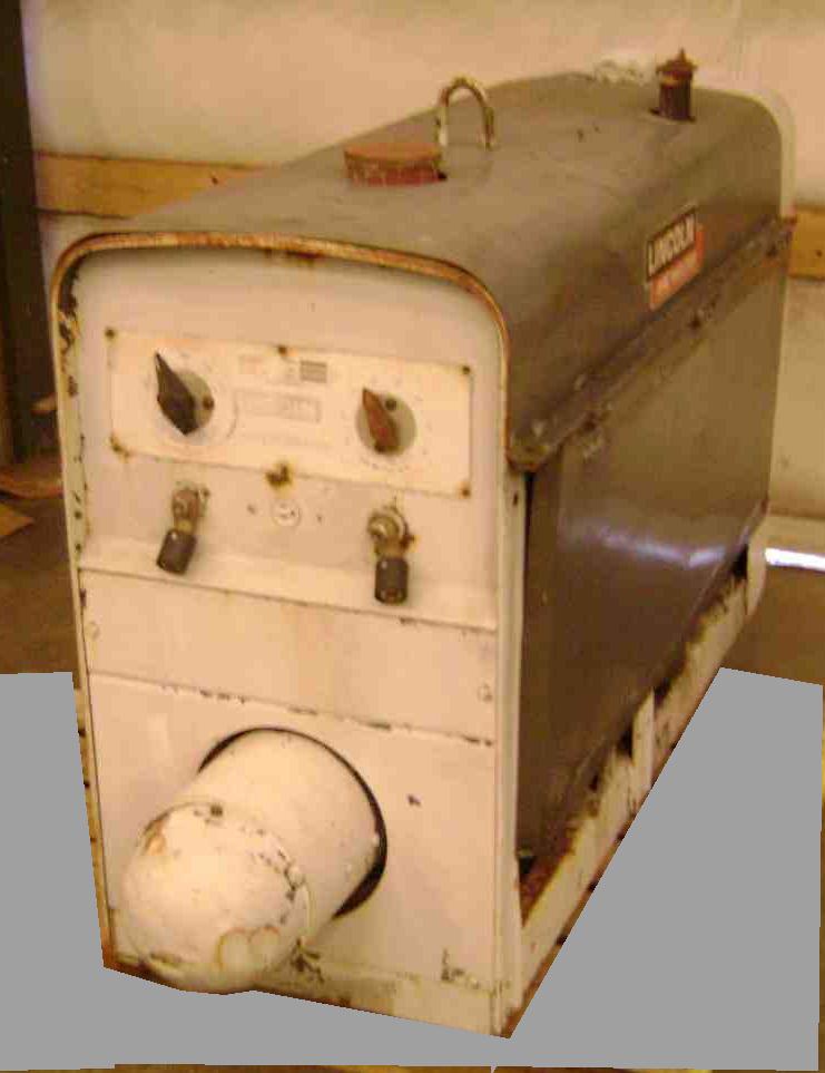

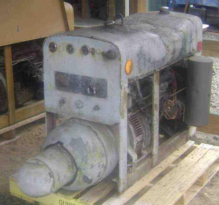

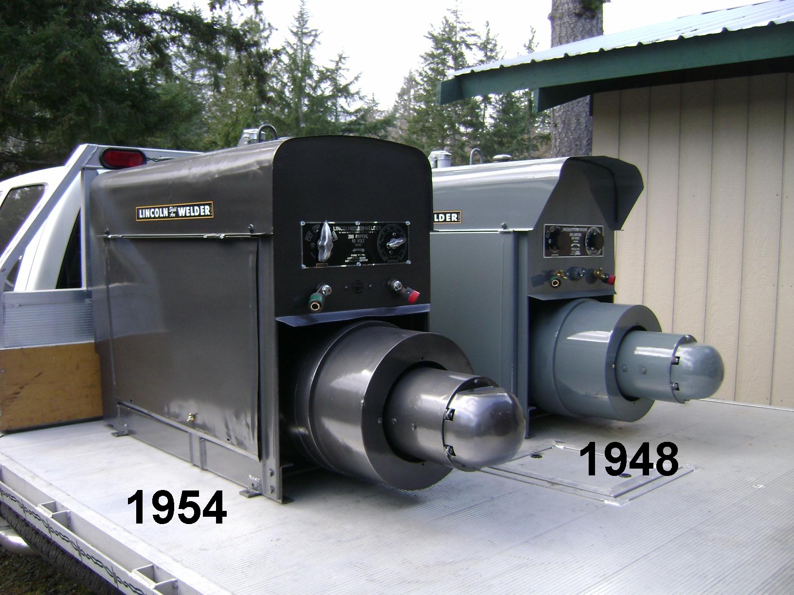

They don't all have pretty faces. :laughing:

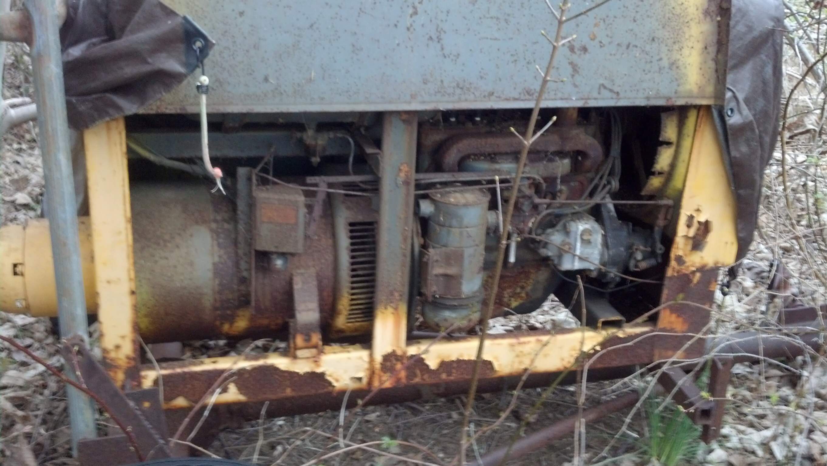

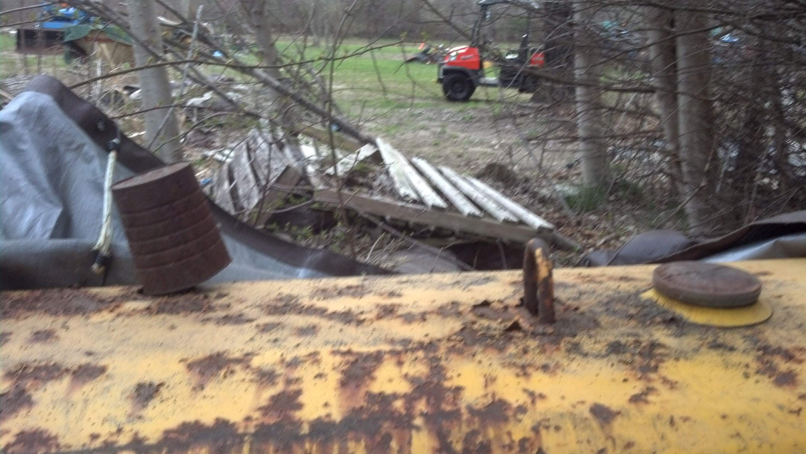

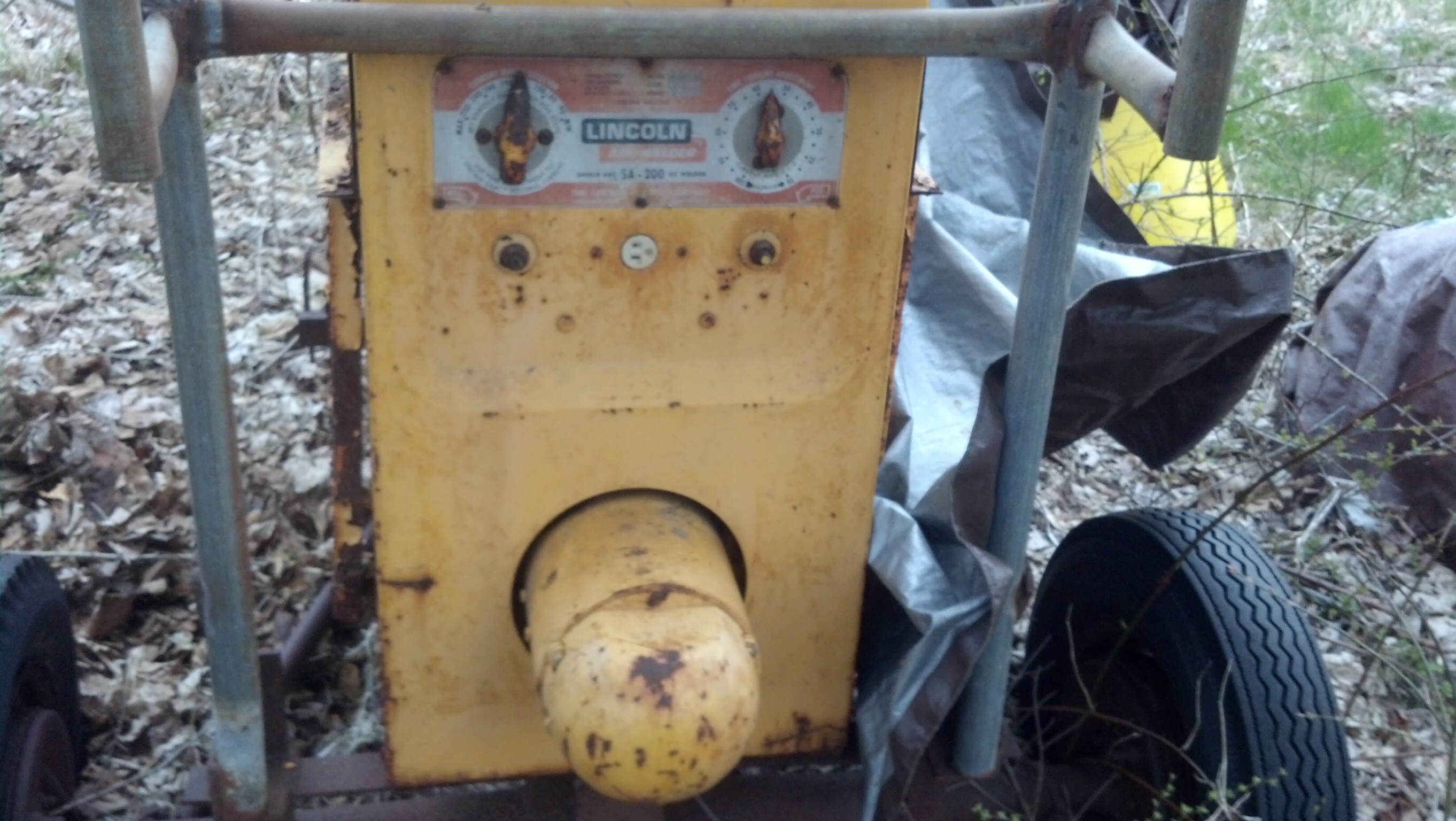

Here are some pics with the tarp off. Not the prettiest sheet metal, although most of it is intact. Good news is the top of the exhaust stack was covered with a can under the tarp, no water should have gotten in. There's evidence of seeds etc. from critters camping out, but no chewed wiring that I can see. Oil dipstick was still at the proper level. Gas tank feels solid and it's empty. Tried a quick turn on the crank pulley by hand in an awkward position, didn't get it to move. Might need some mystery oil squirted in with the plugs pulled to sit a while. I have to cut a bunch of brush out of the way to pull her out.
