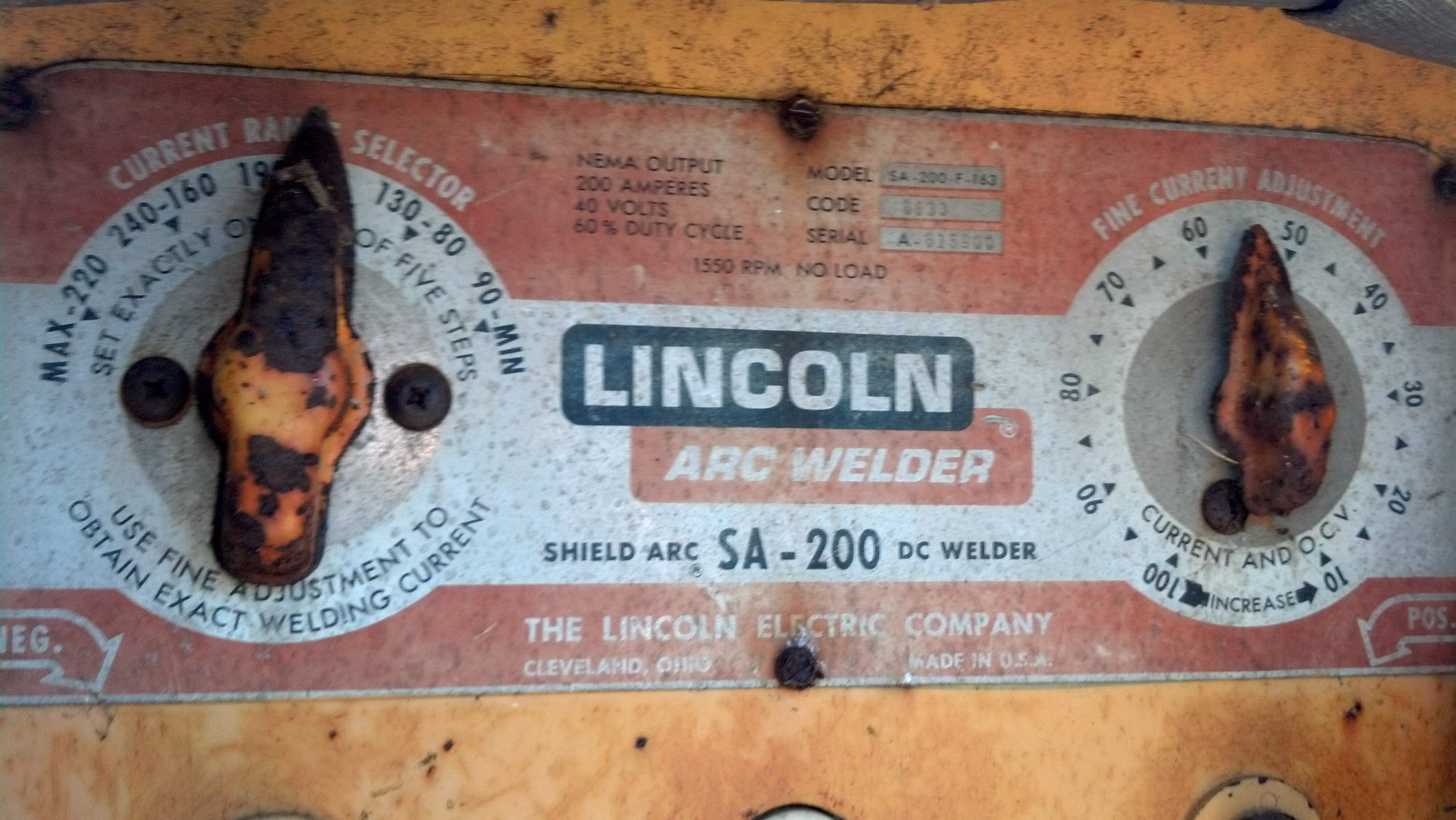

Here on the farm we have an old Lincoln gas welder on wheels, it's a 200 amp model. My grandfather bought it used in the late 80s, probably been 25 years since it's been run. I just remembered it was there. Do you think it might be worth looking into getting it going or just look at newer technology when the time comes? It would give me more amperage than my little one.
Lincoln's site says it's a 1969?
   / Picked up my first welder today #87
The SA-200 is a venerable welder that you will still find on pipelines around the world. The one you've got looks to be a bit worse for wear. If it doesn't run, you should get someone who specializes in SA-200 restoration to tell you if it's worth fixing up. In good condition, they can fetch a few thousand dollars. In poor condition, they may part out for a few hundred. When it's running right, an SA-200 will weld as good as anything in the world.
For hobby fabrication, I don't think an engine drive welder is usually the right choice. They are more expensive to run than mains power, and you constantly have to listen to an engine roaring in your ear. If you want more power, there are any number of welders in the 200 amp range that can be had for around $500 or thereabouts. The exception would be if you knew you were going to be working in a lot of places where you don't have 220v mains power.

It's been sitting for quite a while. It's been covered with a heavy tarp. I never paid it much mind. It was my Grandfather's and he passed in 1993. I've known it's been there for many years, but never bothered looking at it. Seeing as I started the welding class recently, I was curious and took a look. Maybe it'll make a project some day.
