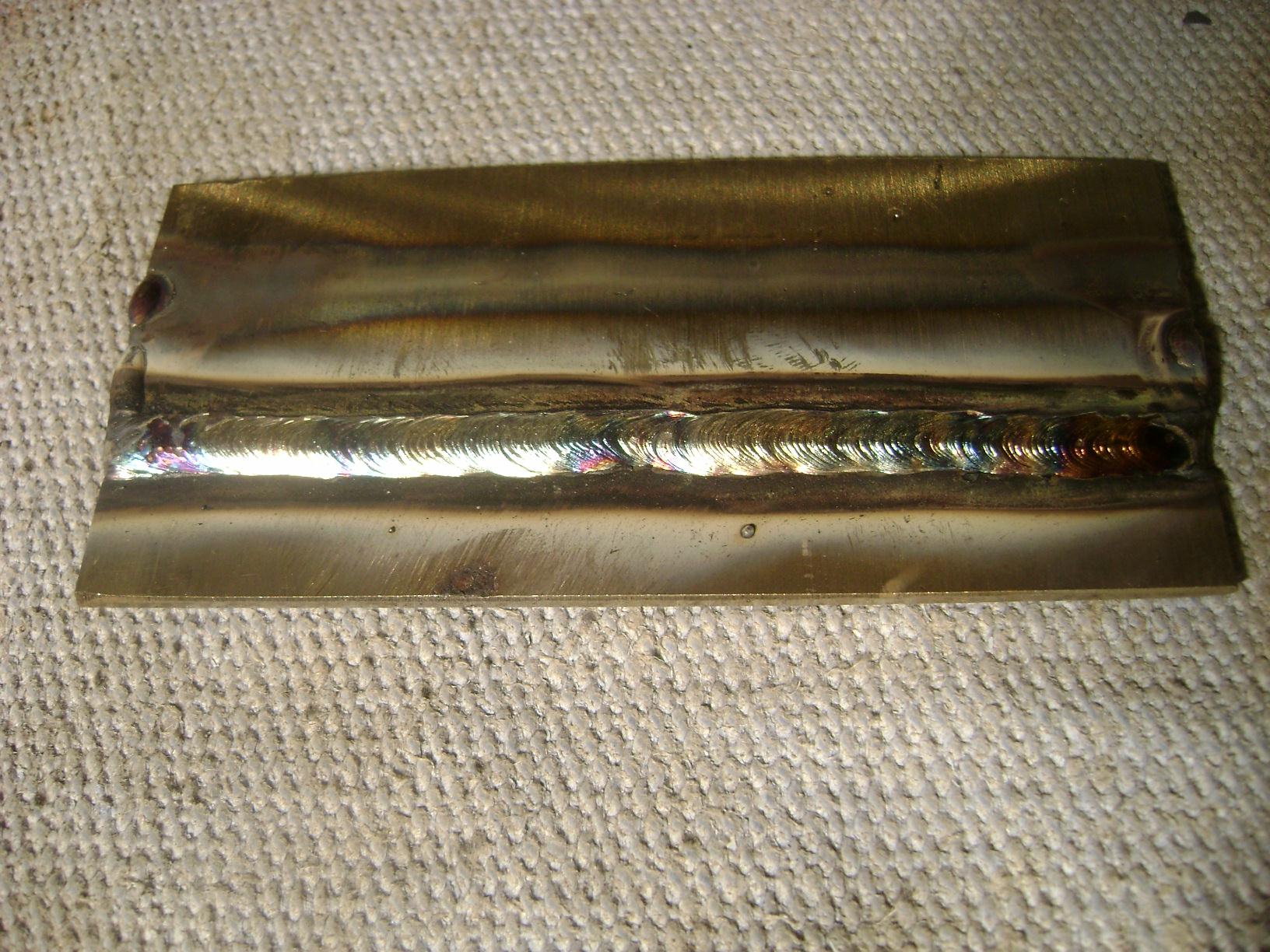

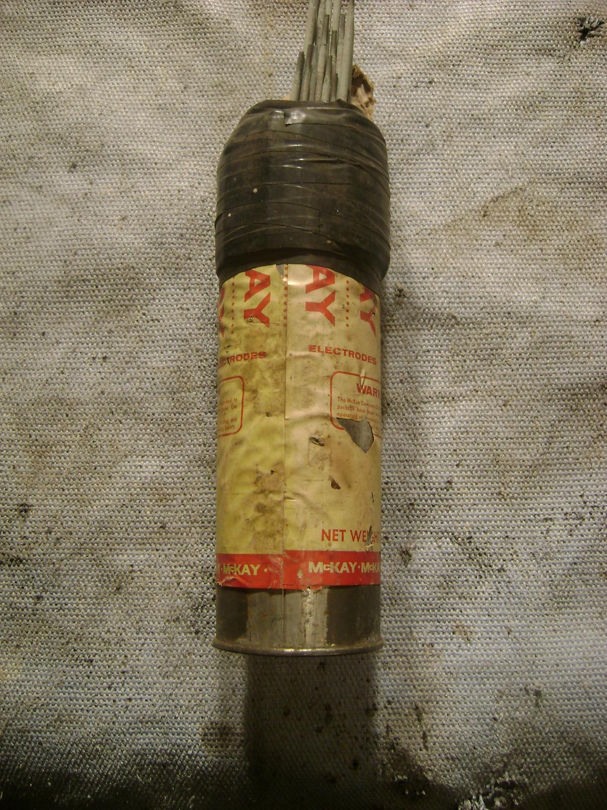

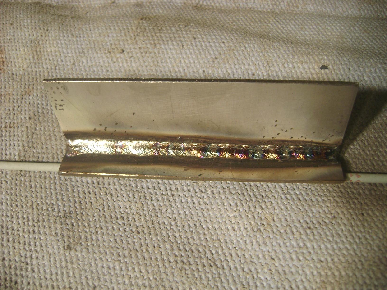

   / Picked up my first welder today #144
You never know until you try them. Here is some stainless steel rod that is pushing 40-years old, and never been in an oven. Doesn't look to bad to me.
