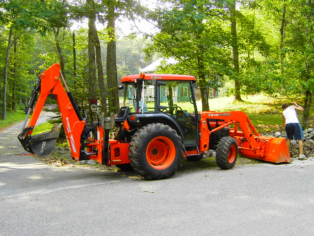

Thanks Chuck, i'll see what I can find out.....Mike, I've never even tried so it probably is easy to change those buckets, I swear I saw someone mention somewhere on here that the Woods had an option of QA but I could be wrong.
Lee, I agree the labor for installing that subframe was a good buy.....I've had guys on here say that you don't have to remove the lower 3pt arms to put the woods on (i think they had a TC45),but i looked at mine again and I sure don't see how you could keep them on. Maybe the TC45 is different somehow???

Each tractor is different so some of the Woods 4-pt subframes
allow the 3-pt lift arms to stay on and some do not. Woods
makes a lot of different subframes, including the newer 4-pt
style and the older ladder-style that makes use of a beefed-up
toplink.

mine required the removal of the lift arms but reinstallation of lift arms literally took only 2-3 minutes. I wish it didn't have to come off but I can live with it.

Oh, sweet! That's exactly the unit I want. Attached is mine. I subscribed to Tractorbynet to let others know I am selling a BH9000 with 20 hrs on it because I want the 90 with the thumb. I have a 100 ft long retaining rock wall to build this summer.
Mind me asking what you paid for it? I got quoted 9400 if I p/u and assemble the thumb (no subframe because I already have it)

By the way: Watch it! It will bleed down and fall off those blocks if not now when brand new, shortly thereafter. I called Woods on this. It's normal but if it falls you will be hard pressed to get it back into position for re-mounting. I caught mine just in the nick of time.

the pricing info has already been posted. Also the thumb doesn't ship from the factory installed so someone has to weld the brackets to the boom(something I wasn't aware of originally). You will probably have quite a bit of assembly from what i understand because the plumbing wasn't factory installed. Your price is fair but I'ld likely have it assembled by someone else. I didn't have pressure gauges and other stuff needed to put it all together.
