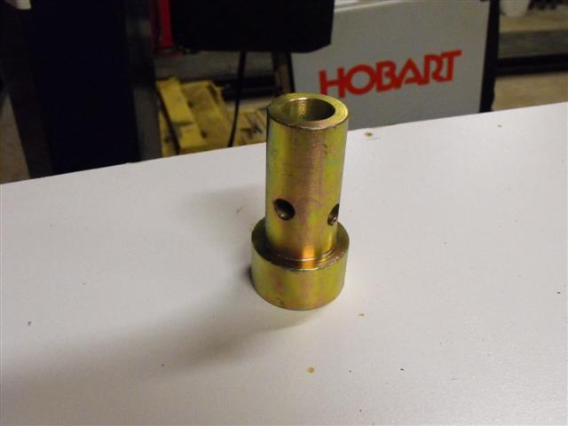

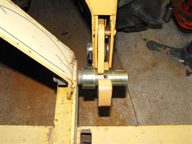

There adapter bushing for CAT1 QA hitches so implements that have 3/4" pins will work. You can buy them at most any tractor supply store for about $17.00 a pair. You just buy a set for each implement and leave them on.
The problem is finding the 1/2" spit pins. Most stores don't carry them that size.

QUOTE=Willl;2177644]Sawzall w/ a bimetal blade would be my choice.[/QUOTE]
And the winner is Willl !
I just came back from Home Depot - they didn't have any punches :confused:
So. . . I went downstairs & got my trusty Sawzall. I had a used Lenox metal cutting blade on it & wasn't really sure how it would do. In less than 2 minutes per pin I was done :thumbsup:
I honestly never thought I would be able to saw through that pin. Shows what I know :eek:
