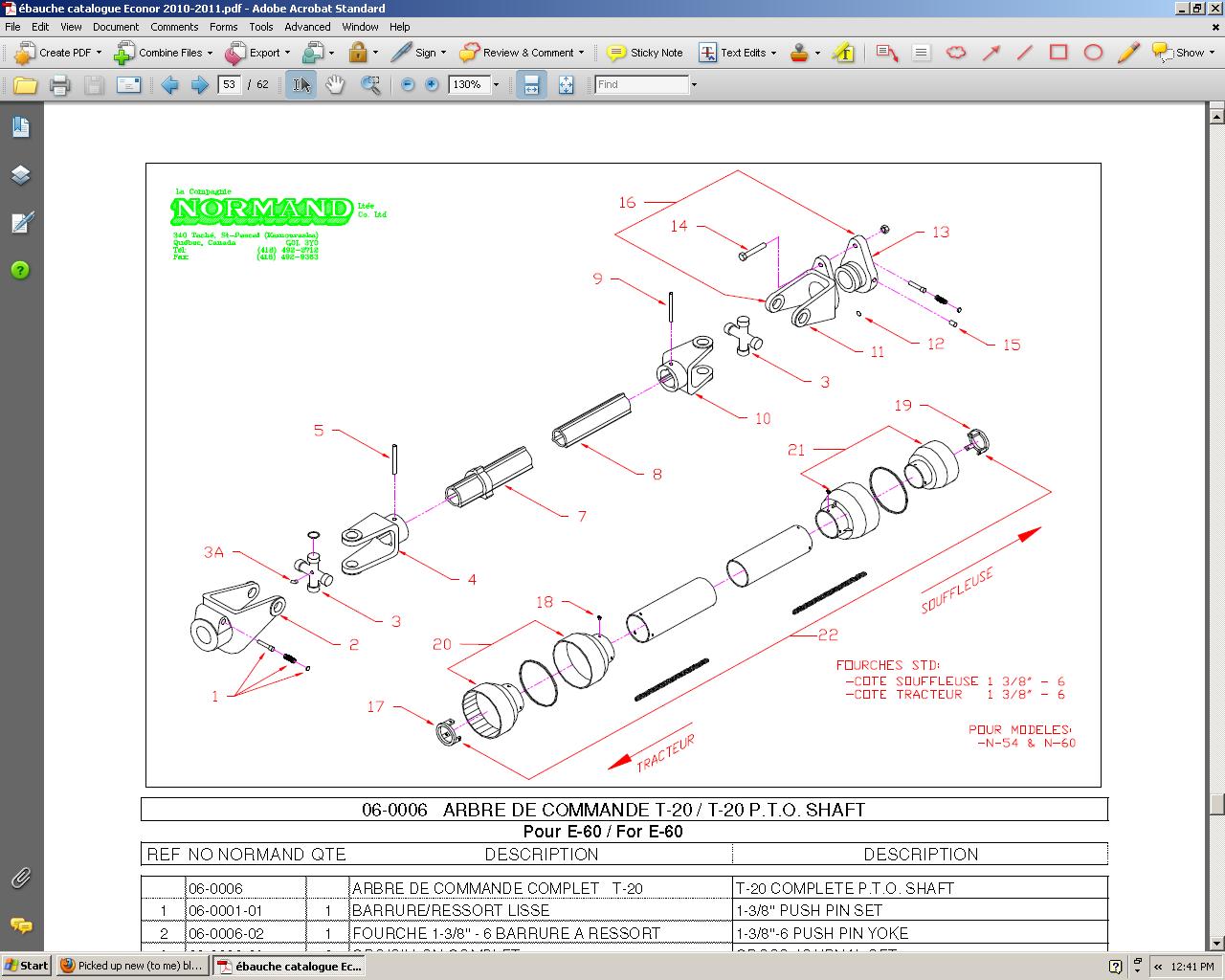

Now I'm (almost) ready for some serious gravel throwing. Speaking of stones, I see only one lil itty bitty shear bolt (on the drive shaft) of this brute. . . does that sound right???
There are two shear bolts, but the second is on the PTO shaft, I think. I found a 6-footer version of the same machine on CL this summer for similar $$, including the dual hydraulic remotes, although yours is in nicer shape. I integrated a valve set onto the blower since I didn't have remotes to run the hydraulics - a PITA at best.

JayC I just came from the tractor dealer. He is going to order a dual spool valve today. When it comes in we will get the tractor over to him & discuss exactly the best placement for it. The L3400 is just about 4-1/2' wide so a 5 footer is fine. The previous owner gave me what literature she had but tha was basically a parts list of the machine. I emailed Normand last Sunday evening & asked them if they had a more complete users / operating manual. Early Monday morning theyemailed what sounds like the same pdf you have :confused: I was hoping there was some kind of operating manual that showed all the grease points, shear pins etc.
I see the shear bolt (#8 metric) for the drive shaft. Where are there other(s)?

Good luck with the remote project. It was 3 solid weekends and about $250 in parts for me to build my "remote remotes". I just couldn't figure out a decent place to put the valve and hoses on the tractor that would be clean and look factory - if I was going to be stuck with a kludge, I figured I'd be better off with a kludge that I could remove. I use a power-beyond outlet on my tractor to plug in the blower lines, which include the valve set. The valve is mounted on a steel table/arm that I made, which bolts onto the 3pt mount. The valves move up and down with the blower, not unlike the handle on a manual control chute. I think it came out pretty cool.
The other shear bolt is on the end of the PTO shaft - I attached the pic for the E60 shaft (#14). I don't think there are any others on the blower itself.
JayC
Thanks Jay - that's the one I see. Are there any others? I stopped at TSC yesterday & picked up 4 #8 X 50mm bolts & nuts. As these are threaded their whole length they are, if anything, less strong than a solid bolt.

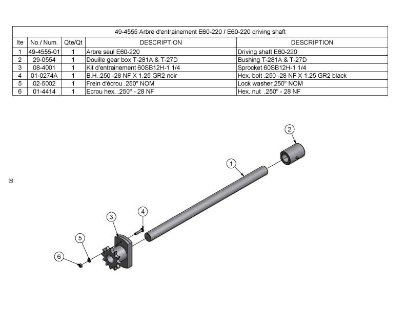

Oh - you seem to have missed the important one - there is a 1/4-28 shear bolt on the blower shaft that goes from the transmission to the auger chain drive gear. If you are standing behind the blower next to the 3pt mount, it is on your left under a cover. Lift the cover to expose the rear section of the chain, and you will see that the drive shaft is connected to the gear through a small plate with a single bolt on one side of it. This is the bolt that is supposed to break first. Knaw-meen?

Yes I did :)
I believe this is the puppy in the pdf (btw your pdf is much better quality than the one I received)
