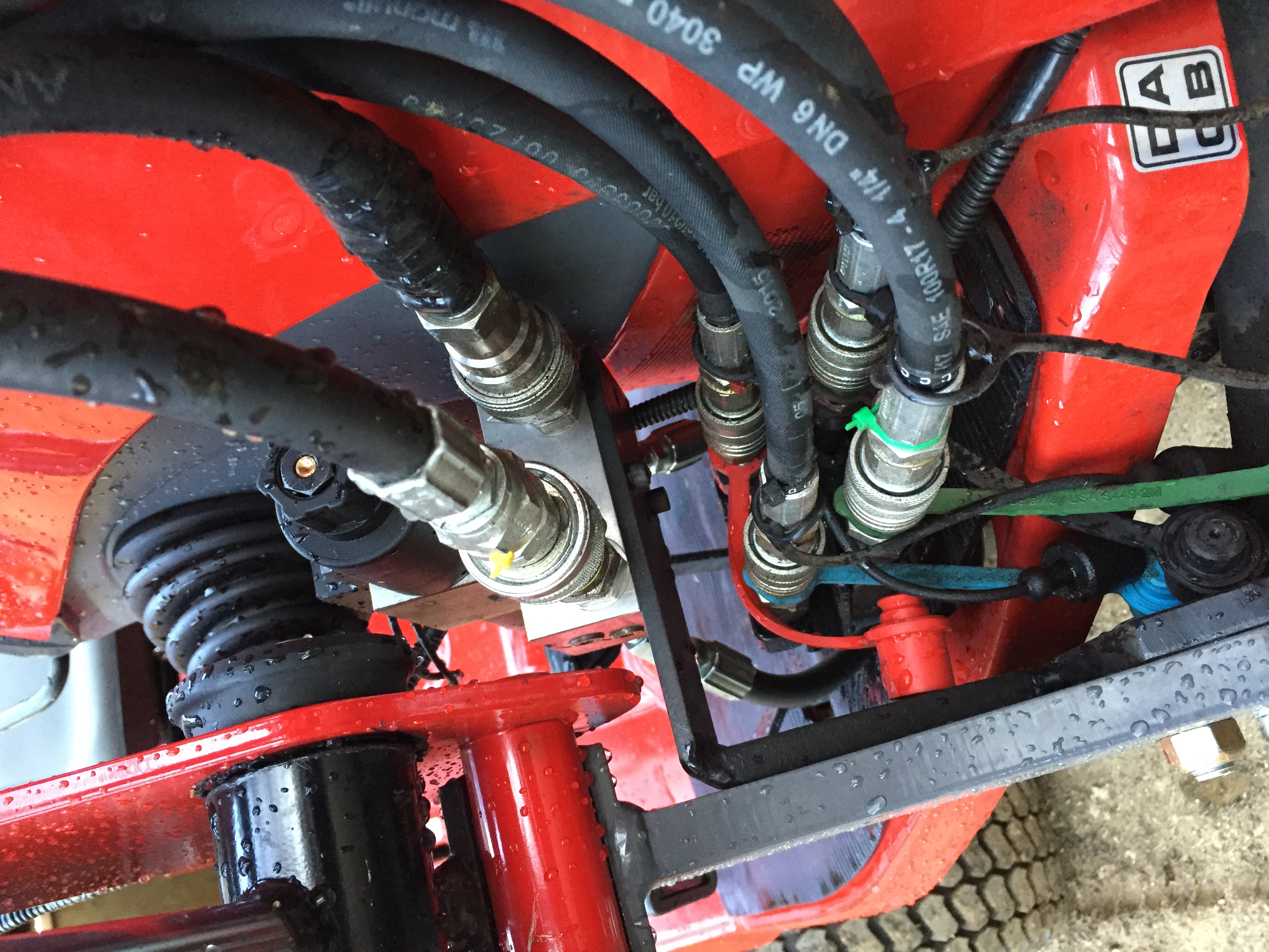

I'll try to get a pic or two when I have some time. The 3rd function valve is from W.R. Long. Its mounted on an L bracket on the inside of the loader mount, right above the existing hydraulic connections. It barely fits, in fact, one of the connectors rubs slightly on the edge of the hood. Its not a big deal to me, there aren't many options as to where it can/should go. But it doe make access tot he quick connects more difficult. The valve comes with a new "ball" for the top of the loader joystick with a toggle switch on the side. You can orient it which ever way you want.
On the bucket, I had a piece of 3/8" x 4" flat bar welded to the top of the bucket for reinforcement before the thumb was installed. Also makes a nice place to weld some hooks.
I think it was about $1200 plus the cost of the thumb and hydraulic hoses. I have Goffs do the install before delivery.

Here are a couple pics of the 3rd function valve I had on my phone. Its pretty night in there, but works.
