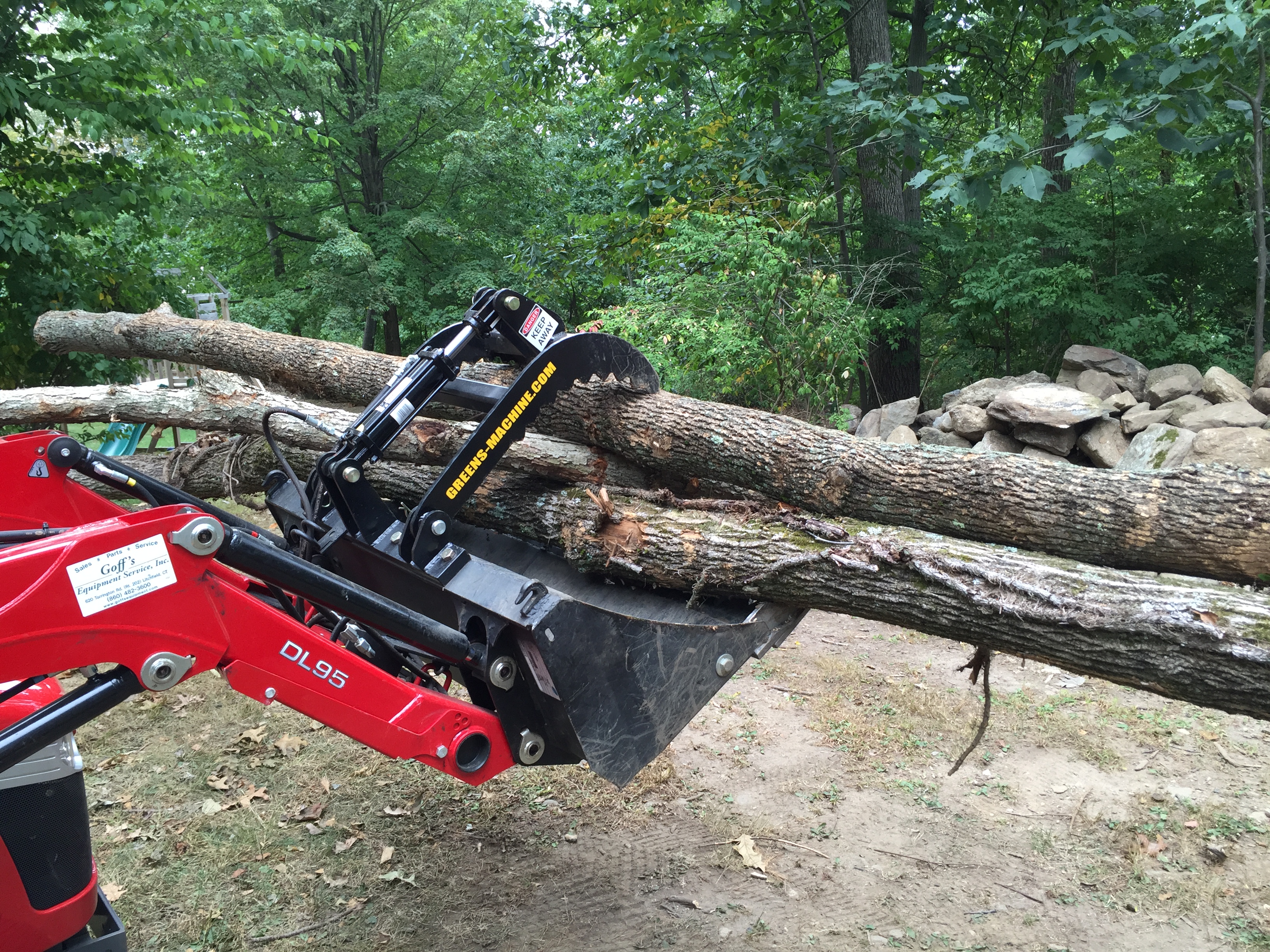

Late to the game as I was out of the country last week for business, but was able to grab a couple of pics and a quick (poor quality) video of how I use the bucket thumb.
You can see my general technique is to approach the log with the bucket vertical, close the thumb on the log, then curl. I seem to be abel to curl the weight of a big log, even if I can't lift it. Meaning once I've curled, I might not be able to lift the log anymore, but I find I've already gotten enough height for cutting, and probably more than I want for transporting that much weight around.
View attachment 481629View attachment 481630View attachment 481631View attachment 481632
Here is quick video
Can you provide any info as far as install cost, parts cost as i will be adding the thumb now to my tractors. Can you post a picture or a video of what you use to open and close the thumb please? Is it directly connected to our loader joystick or is it s seperate one?
   / Picking up logs, grapple or thumb? Advice please. #60
I'll try to get a pic or two when I have some time. The 3rd function valve is from W.R. Long. Its mounted on an L bracket on the inside of the loader mount, right above the existing hydraulic connections. It barely fits, in fact, one of the connectors rubs slightly on the edge of the hood. Its not a big deal to me, there aren't many options as to where it can/should go. But it doe make access tot he quick connects more difficult. The valve comes with a new "ball" for the top of the loader joystick with a toggle switch on the side. You can orient it which ever way you want.
On the bucket, I had a piece of 3/8" x 4" flat bar welded to the top of the bucket for reinforcement before the thumb was installed. Also makes a nice place to weld some hooks.
I think it was about $1200 plus the cost of the thumb and hydraulic hoses. I have Goffs do the install before delivery.
