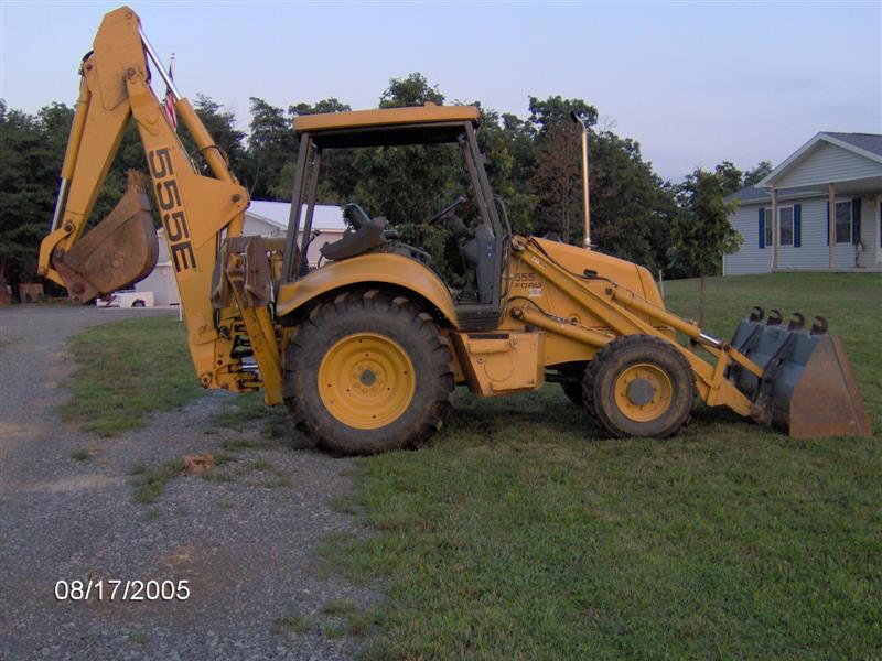

Of course. A 7.5 on 7 cylinders will out pull a good running 5.8:p :D
We hauled a NH555 backhoe 4x4 from NC to WV. Pulled it fine. Getting it to stop....well that was another problem. Attached is the picture of the tractor. Pretty good load.
