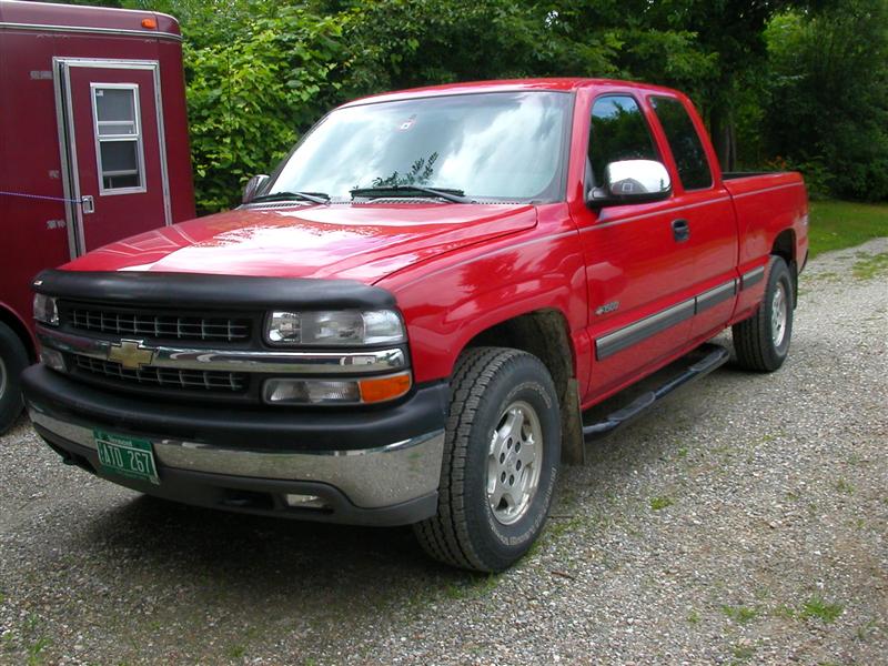

Finally bought a truck. '01 Silverado Z71 / 1/2 ton / LS / 5.3 / 4x4 / Extracab / spray-in bedliner / tow package with electric brakes / 56K miles / $12,500. It appears to be well taken care of (all records) and the miles are relatively low for the year. Tires are good. I'm looking forward to picking it up on monday morning. I looked within 500 miles of VT and PA. It's the nicest rig for the money I could find since my original post.
Oil undercoat which appears to work very well in these parts, although I've never had it done personally. They superheat oil then high pressure spray it inside the door and rocker panels, under the frame, etc. Apparently one has to remember to do it now and again to be effective long term.
Thanks for all the replies. Quality posts all around.

Congrats on the truck, Jim. Looks really nice, keep the rust off!

sorry to hijak the thread ! Nice truck Jim! Hey, i'm headed up thru randolf and then northfield to montpelier in a few weeks- are you around there ?

BTW, I meant to congratulate Jim as well...Nice truck, hope it fits your needs well..
