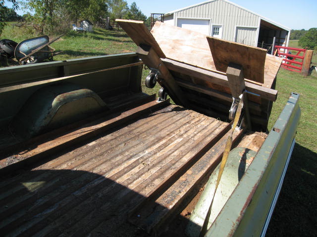

I could see a small electric winch used as a capstan with a pulley at the rear to pull the box back, another at the front for re-loading and the cable looped to a point about 24" from the front of the box....
Maybe if I used an old 200 gallon oil tank with the top and rear cut out, a bit of 3" channel iron to stiffen it up, then I too could have a dump truck.....
   / Pickup truck roll out dump bed on a budget #14

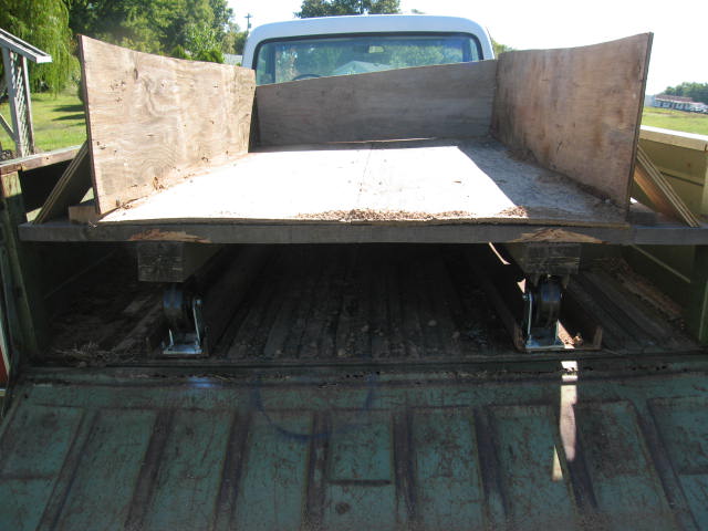

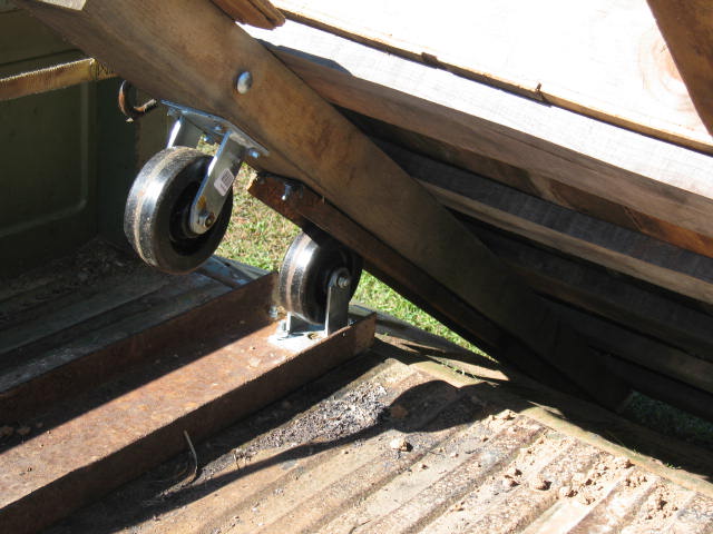

I have an old metal box that fits well between the wheel wells. I was thinking of making a dump box out of it using a 12 volt gear motor and a threaded machine rod as the actuator or hydraulics if I ever find a chep 12 volt dc hyd pump
   / Pickup truck roll out dump bed on a budget #15

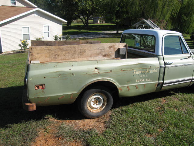

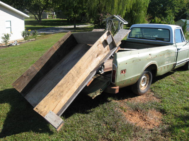

I hauled a lot of sand and gravel this way. For a temporary need it"s cheap, easy and works great.
Would it work for dumping a load of shingles removed from a roof or do you think they would hang up so bad that they won't dump out? I can see sand and gravel maybe being easier to dump. Any thoughts?
   / Pickup truck roll out dump bed on a budget #17
Even with sand and gravel after it tipped and most all of it was in a pile on the ground, I had to shovel a little bit off the very end of the box to tip it back up, but my box was not attached to the truck in any way. I imagine if it had a rope attached to the truck, you could drive forward and pull it from under the remaining load. With shingles, I think you might put a couple layers of cardboard on the bottom as someone else suggested and it should work good also.
