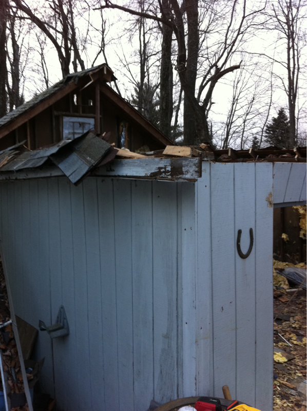

I have a load handler I used for the last 8 years.The tally so far about 80 tons of gravel 40 tons of dirt 5tons sand 1old garage.
The only problems were 2 broken straps.One on the tail gate and the other that held it down by a hook to the bumper.The bumper I used a piece of chain with a quick link to my hitch works better than than the original.So far I have no complaints and if I finally kill it I would buy another.
