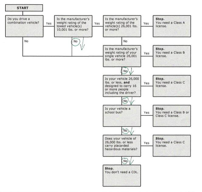

You'd be fine with your rig. You need to look at your GVWR on your rig and trailer. The CGWR is only coming into play on a trailer at 10k or more GVWR if the combined GVWR of the tow rig and trailer is over 26,001lbs. Example; my 86 F350 has a GVWR of 11,000lbs and my trailer has a GVWR of 13,800lbs giving me a CGWR of 24,800lbs, no CDL. If my truck had a GVWR of 12,500lbs pulling same trailer I'd be at 26,300lbs CGWR, Class A CDL required. Hope that helps
One step further, you could have a truck with a GVWR of 20,000lbs pulling a trailer with a GVWR 9,999lbs and no CDL required.
Happy Gilmore is right, and here is a flow chart that may help. Anointed for the vehicle combination above
