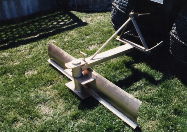

It's not a plow, but this photo I found via Googling images of Category 0 3 point hitch shows the top and lower link setup for a scraper blade.

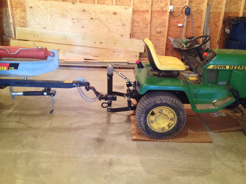

Here is a picture of the (cat 0) three point on my JD 330. I don't have a plow but this is my receiver that I use to move my log splitter, trailer, etc. I also have a 4' blade I use with it. Basically your top link is your biggest adjustment to control how aggressive you want the plow to cut into the ground.
