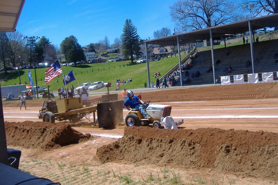

Here is a pic of the fat ******* and his "stock" garden tractor pulling in Galax, VA. He won, of course. Junkyard Dog.jpg He did not even run his real pulling tractor because they were afraid he would break the sled. ****, they would not even allow him to make an exhibition pull.
I would be interested to know how much they would charge you for the OEM muffler setup. The fat ******* said that having a single exhaust port for a 3 cylinder diesel is not a good thing. He also noted that your injector pump has 4 outlets (one of them plugged) so it must be dual use between your engine and the 4 cylinder. God knows how he picked up on that so quickly after I sent him the link. That is what makes him so special.
