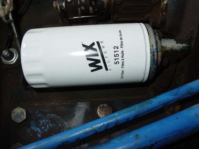

Was unable to find an engine oil filter, so I'll pick up the real thing from the New Holland dealer tomorrow.
two options below, I like Wix better.
