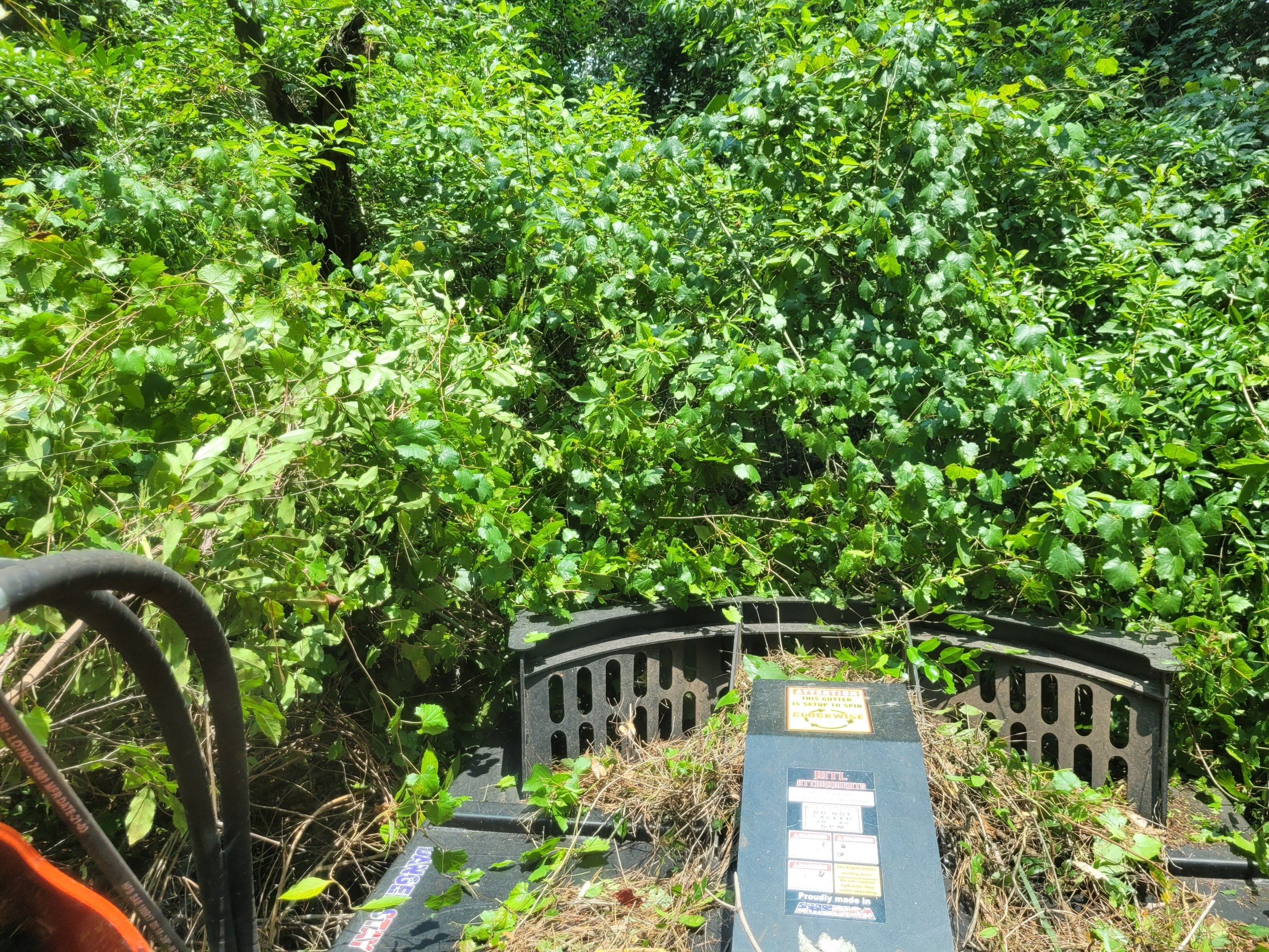

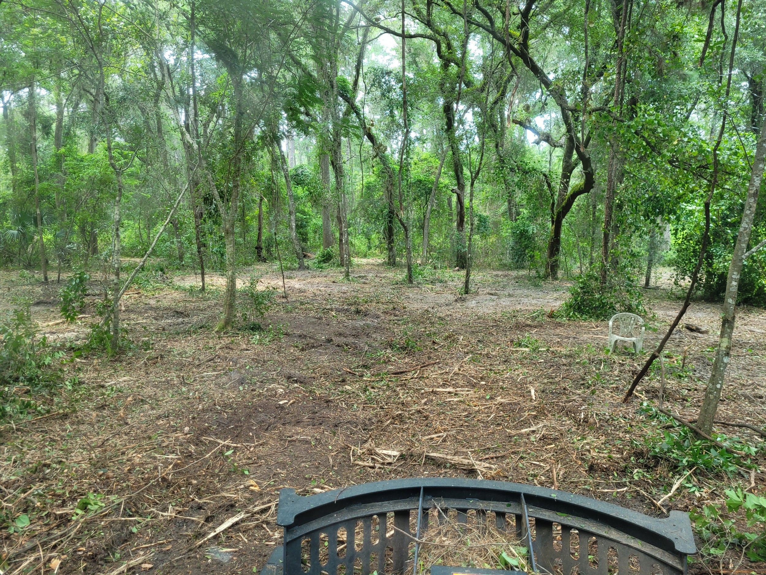

I have bee doing mowing jobs with the tractor and mostly driveway jobs with the skid steer, but I slid in a forestry mowing job today and it was full of hidden flint rocks and fence wire, metal, junk, etc, another couple more like this one and I am gonna need some new blades and probably a few more carbide teeth, anyhow here are a couple of before and after photos, I usually try to leave a little better finished product but the owner wanted me to cover as much ground as possible, so there is a little larger residue than normal.

Imagine having to do that by hand !
