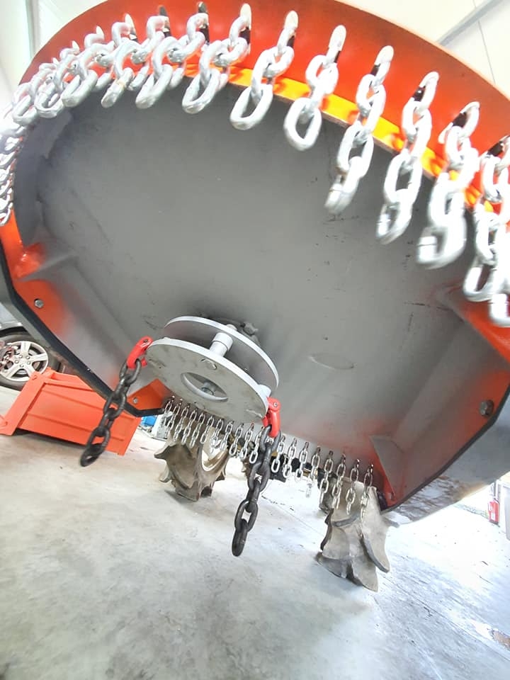

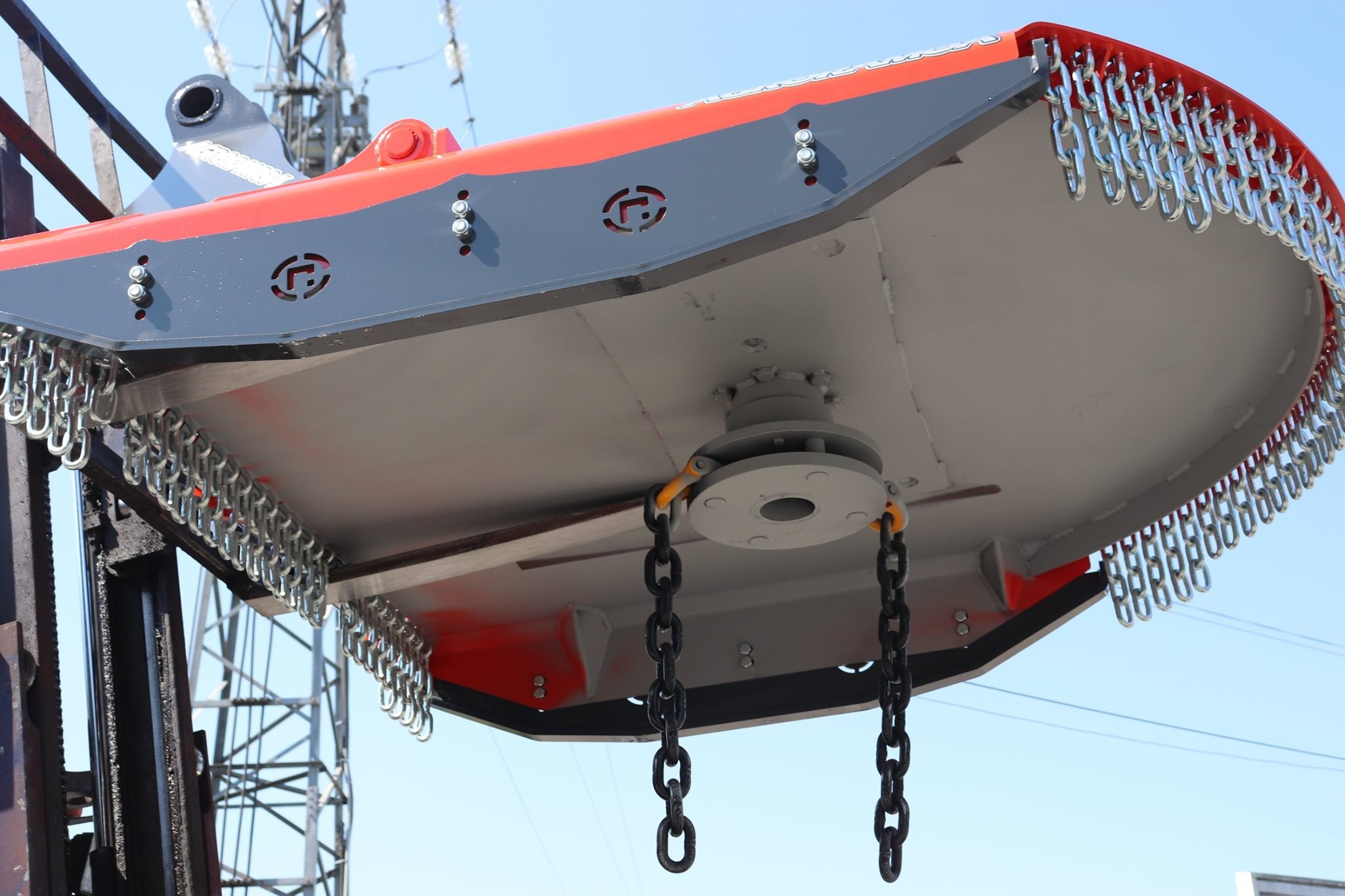

You’ve mentioned chain blade cutters before, could you explain or show some more pictures? Grade of/type of chain?
This entire country is based on having good maneuverability and the tractor is still ahead by far compared to a SS. On the small village where I have my olive grove, it sits on top of a small mountain with lots of eucalyptus, pine trees, mimosas and lot more with a lot of overgrown brush up to 10 ft high. This mountain has a very high fire risk throughout the entire year and this year they've been mowing all the brush and only leaving stuff thicker than 3 to 4" on the more critical areas closer to houses. They used a LS R50 with one of these cutters and the tractor did a beautiful job mowing the brush and sneaking in between all the trees.
Chains are usually Grade 80 chain, ranging from 3/8" up to 3/4" depending on the size of the cutter and it's class (light duty, medium duty, heavy duty and forestry duty). Most cutters can be configured with either 4 chains or 2, 4 will obviously take more HP. The gearboxes are available in 30HP/60HP/90HP and 120HP rating, up until the forestry duty cutters that get stronger gearboxes with different ratios. The different between classes is mainly the thickness of the steel used to build it.
Some of the biggest advantages of the chains compared to blades is that it will handle a lot thicker brush, won't care about rocks or any objects it may encounter, plus, since it shreds the material, it won't really leave sharp edges or points that can puncture a tire. It will also cut a lot closer to the ground. I have mine set at about 1" to 1.5" from the ground to the hub.
For the amount of work and quality of work these can do, they're not very expensive at all. I run a 1.2m cutting width light duty cutter on my tractor that cost me €650 brand new.

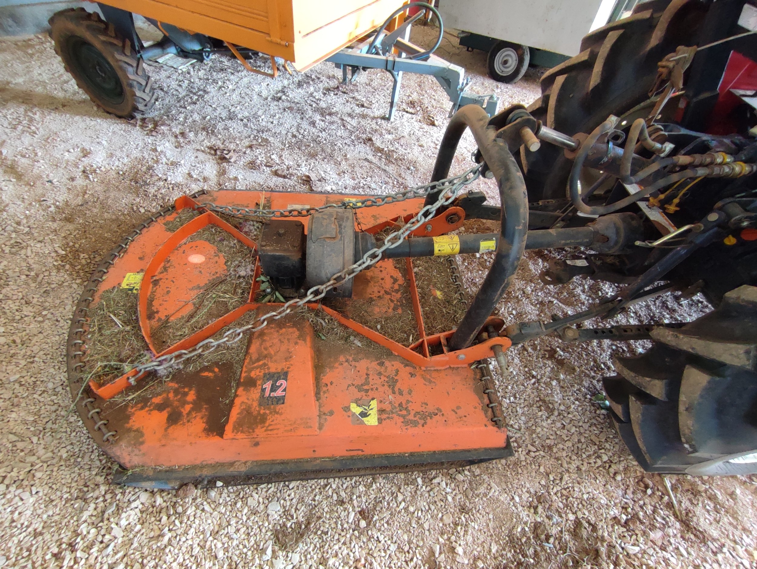

Third picture is me working on a 15 to 25 degree hill and mowing overgrown brush up to 2" that has grown completely unmaintained since the lost forest fire in 2005.
Ok, so they use a different carrier too. Are stump jumper pans not normally used either? ( a stump jumper is a concave plate that covers the bottom of the carrier to encourage the carrier to ride over).
How well do these work with just grass/weeds?
No, stump jumpers are not needed. If it can't destroy it, it will jump naturally over the stump.
These will actually eat quite a lot HP on dense grass compared to blades, but will do a nice job too. Not quite as nice finish the blades do but very close. The advantage of not having to worry about rocks, stumps and etc just for the cost of little bit nicer finish is not really worth changing.

Do they spin at the same rpm as a standard bladed rotary or is it faster?
What RPM does the cutter there spin at? The gearboxes on these typically have a 1:1.92 ratio. At 540 PTO RPM, the spindle spins at around 1040 RPM.
The forestry versions do spin faster.
