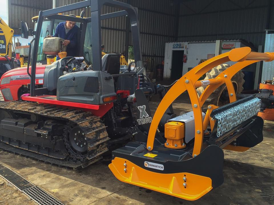

PTSG have you ever seen a 2 spindle "chain" mower before? From your experience do you think it would work?
Thanks for the list of names.👍
   / Pictures from a skid steer mowing contractor #82
Yes, those do exist. Both Herkulis and Bermathor make one with two spindles. These are very nice as it makes for an even more compact setup.
A video of one working. Just be aware of loud music. I wish they would just keep the engine sound.
