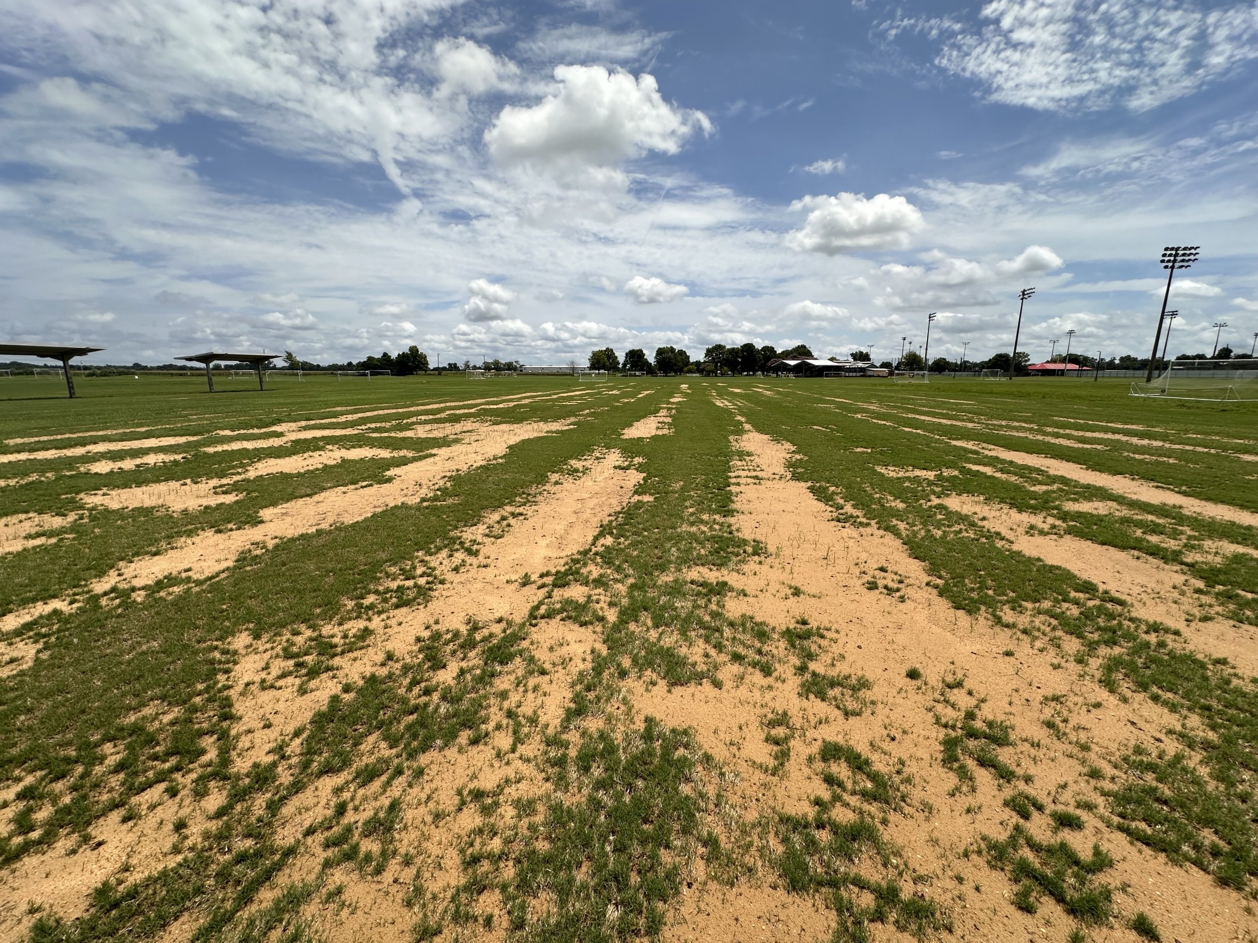

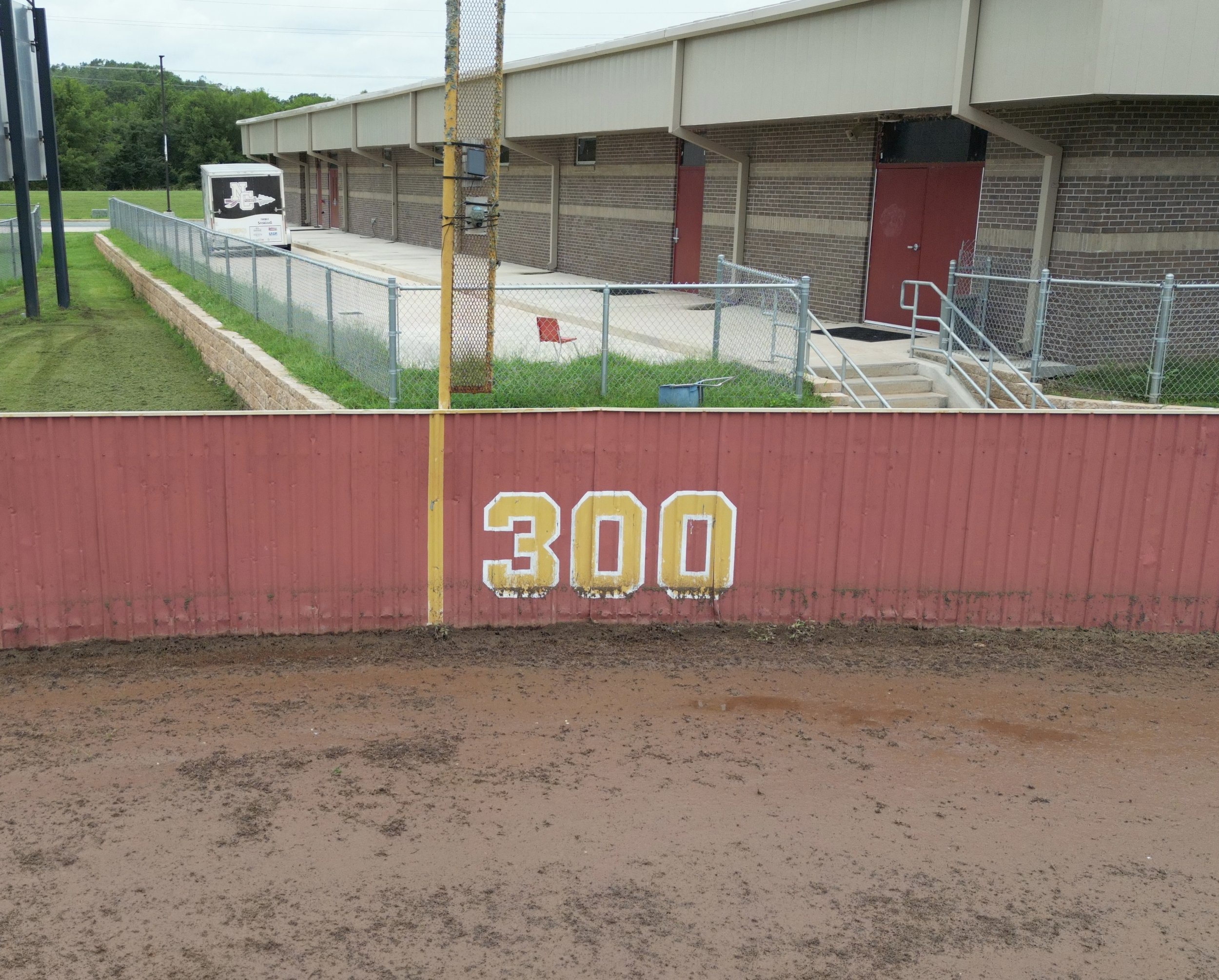

We were able to squeeze in another lip removal job today before the rain.

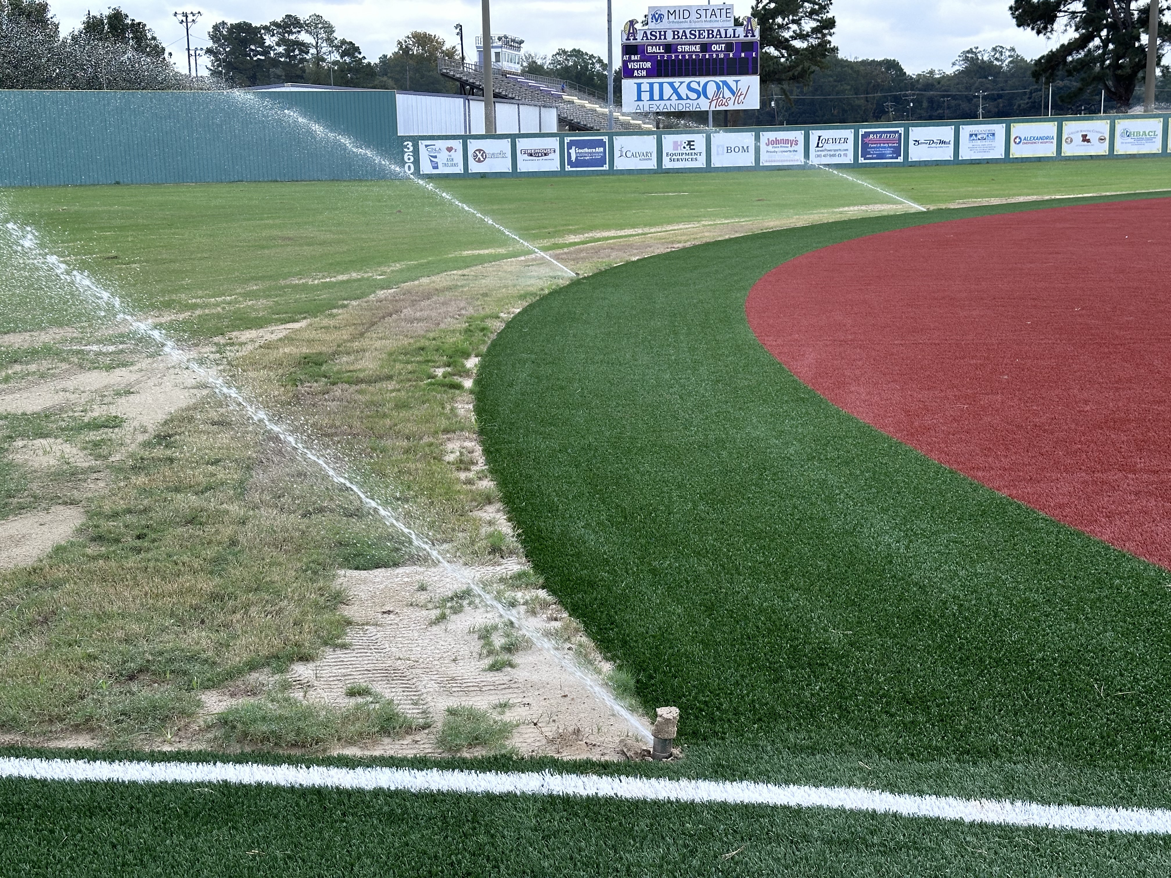

I went spread ryegrass on this field last Friday. I also treated for ants. Several weeks ago we had installed a new irrigation system and added some sod along the new fake grass. It rained about 6.5” in the 48 hours after I took this pic. We also topdressed with sand.

The fake grass sure looks a lot nicer then the real stuff. Is there an advantage over real grass?

There are some advantages and some disadvantages to the fake grass.
Advantages of fake grass are:
1. Less maintenance
2. Looks nicer.
3. Less 'rain-outs'
Disadvantage of fake grass are:
1. Much higher initial cost
2. Much hotter than real grass in summer. Up to 40 or 50* hotter at the surface
3. Much more likely to cause injuries.
4. Most players prefer to play on real grass.
5. Won't last as long as natural grass, therefore increasing cost when it needs to be replaced in 8-10 years.

That looks like a massive job!!!! How many zones? How big is the water supply line? Do you figure all that out, or is there an engineer that specializes is watering huge areas?

This was actually a fairly easy job. It has only 4 zones. If you look at the bottom of the picture, you can see the green covers of the zone valves. The water supply is mostly 2" pipe, and parts of it are 1.5". This system includes a 2 hp booster pump, because there is not enough water volume and pressure without it. We do all the design ourselves. In order to be licensed to do irrigation, you must pass a test showing that you know the basics of designing a system.

I’m going to show my ignorance and try and learn something. How is irrigation zoned? Some heads water more often than others?

It's fairly complicated. The goal is to have the irrigation supply the same amount of water in all areas. It's called 'matched precipitation'.
To design a zone, you have to know how much water (gpm) and pressure you have available. Then, you have to choose a sprinkler head and nozzle size that will not allow the zone (group of heads) to go over the amount of water available. Then, you have to space the heads at a distance that will accommodate the amount of water and distance each head throws.
Actually, an athletic field can be easier to design, because everything is pretty much squared off, and distances are equal. An irregular shaped lawn or landscaping beds will require different nozzles on each zone.
You can set each zone to water for any amount of time.
My daughter has a degree in Mechanical Engineering, and she was designing all of our irrigation, but she has branched out with her own business now, so I and my main employee do all of the designing now, and will consult with my daughter now and then.

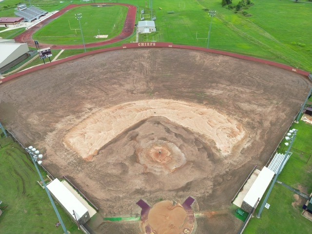

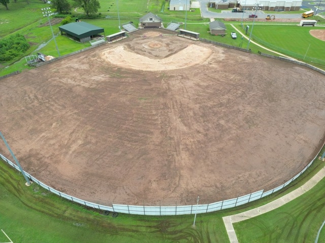

Went work on some infields today. These fields are about 210 miles from my shop. And I have to go through Baton Rouge and New Orleans to get there. About 4 hours each way if the traffic is good.
First I mowed it down to the dirt.
Then tilled it. Later I will go back and re-grade it with the laser equipment.
We also renovated the mound and home plate on the baseball field.
