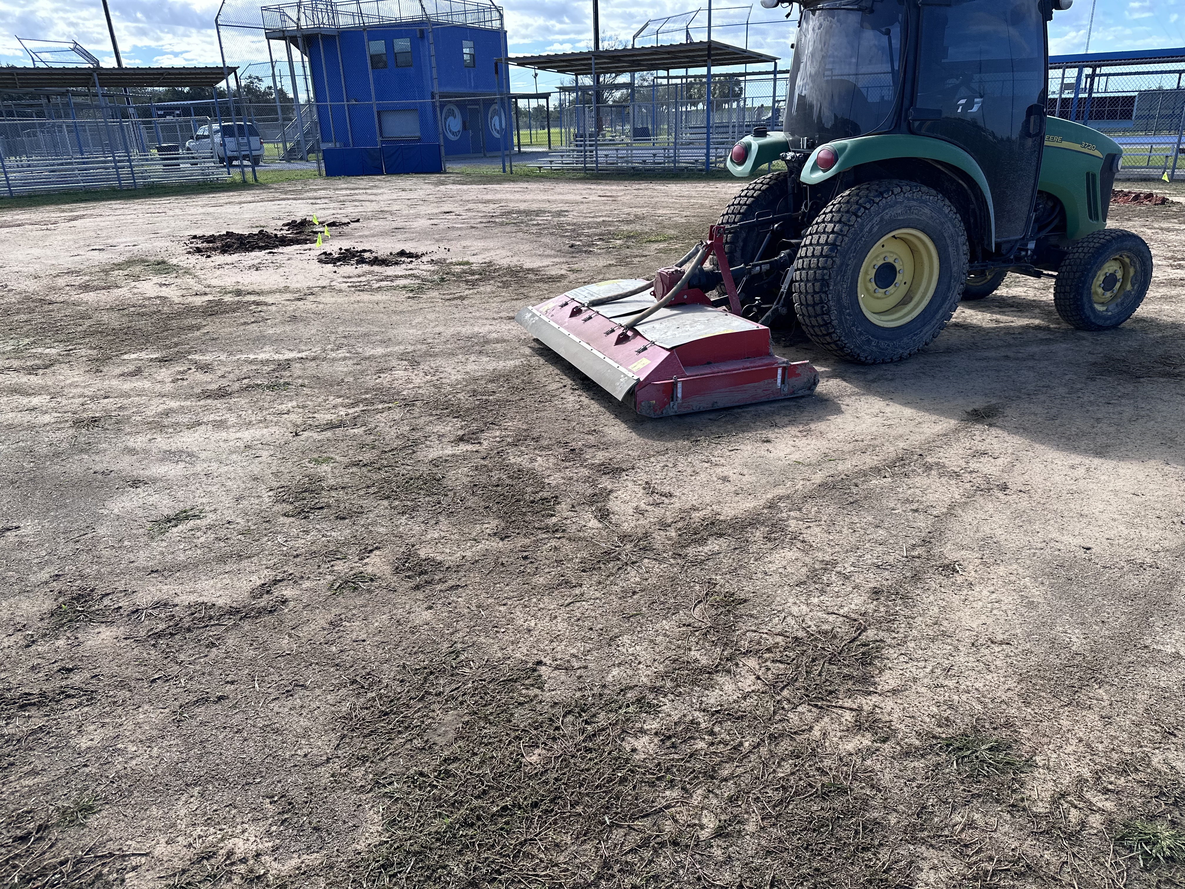

Went work on some infields today. These fields are about 210 miles from my shop. And I have to go through Baton Rouge and New Orleans to get there. About 4 hours each way if the traffic is good.
First I mowed it down to the dirt.
What brand is the mower? Progressive? What is the advantage of a roller style finish mower? I would think the front roller would push the grass down inhibiting a good cut.
That field looks entirely neglected.
The mower is a Trimax, which is similar to Progressive. The rollers allow the blades to follow the contours of the surface a little better. Although it does push the grass down a little, we use 'high lift' blades which will lift the grass for a better cut. The rollers also do a better job of striping the grass, which many people like to see.
