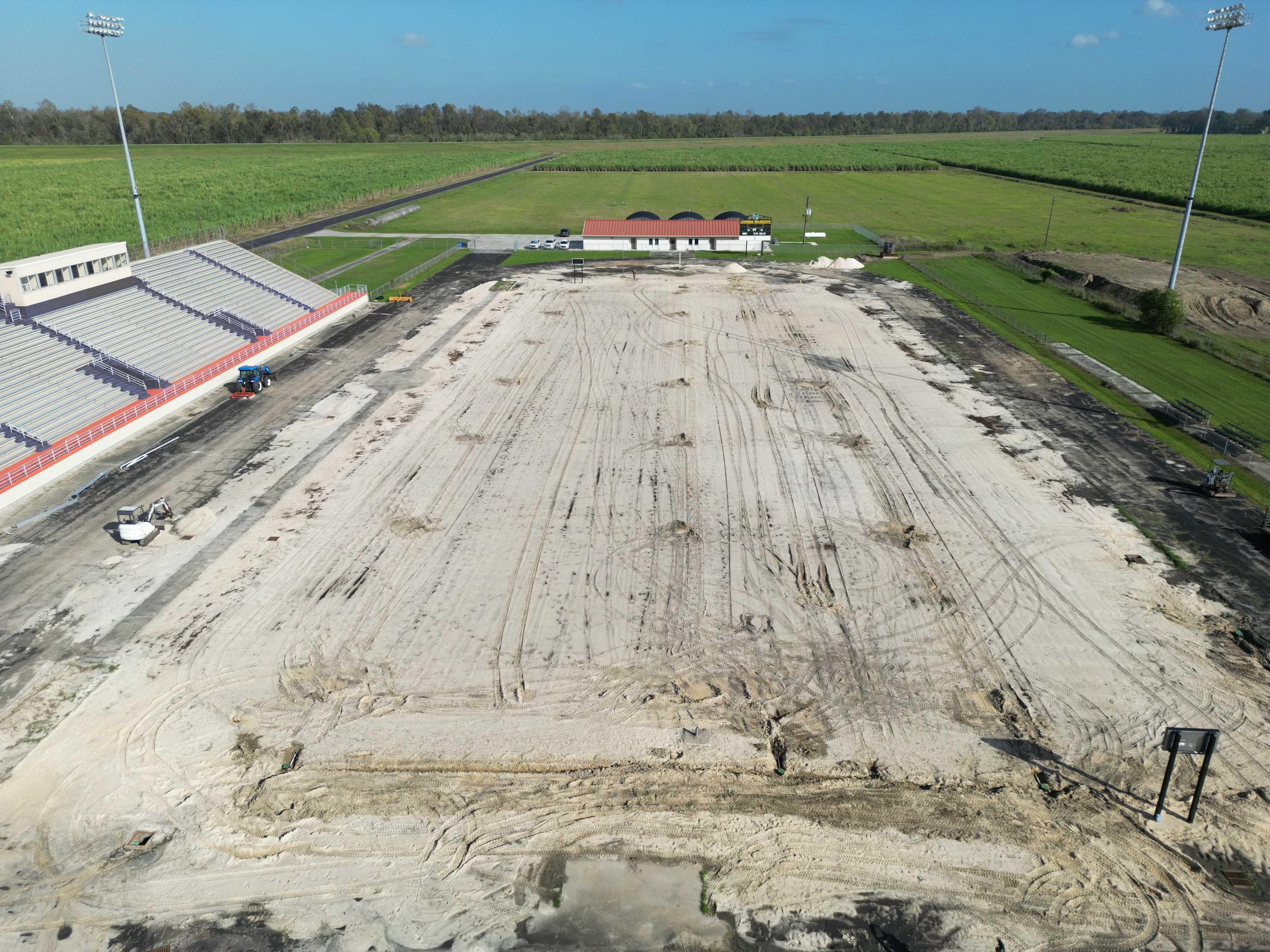

Another irrigation system installed on a football field.
   / Pictures from an athletic field contractor #172
That looks like a massive job!!!! How many zones? How big is the water supply line? Do you figure all that out, or is there an engineer that specializes is watering huge areas?
#173
This was actually a fairly easy job. It has only 4 zones. If you look at the bottom of the picture, you can see the green covers of the zone valves. The water supply is mostly 2" pipe, and parts of it are 1.5". This system includes a 2 hp booster pump, because there is not enough water volume and pressure without it. We do all the design ourselves. In order to be licensed to do irrigation, you must pass a test showing that you know the basics of designing a system.

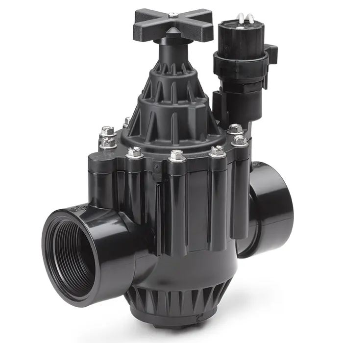

#177
I don't have any pictures, but this is the valve we used on this field. It is a Rainbird PGA 2" valve. And we used Rainbird 6504 Rotors for the sprinkler heads. There are 4 valves (zones) on this field. Three of the valves have 6 rotors and one has 5.
